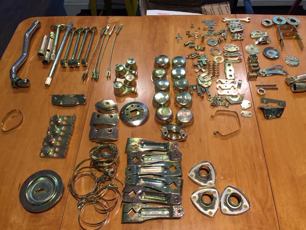

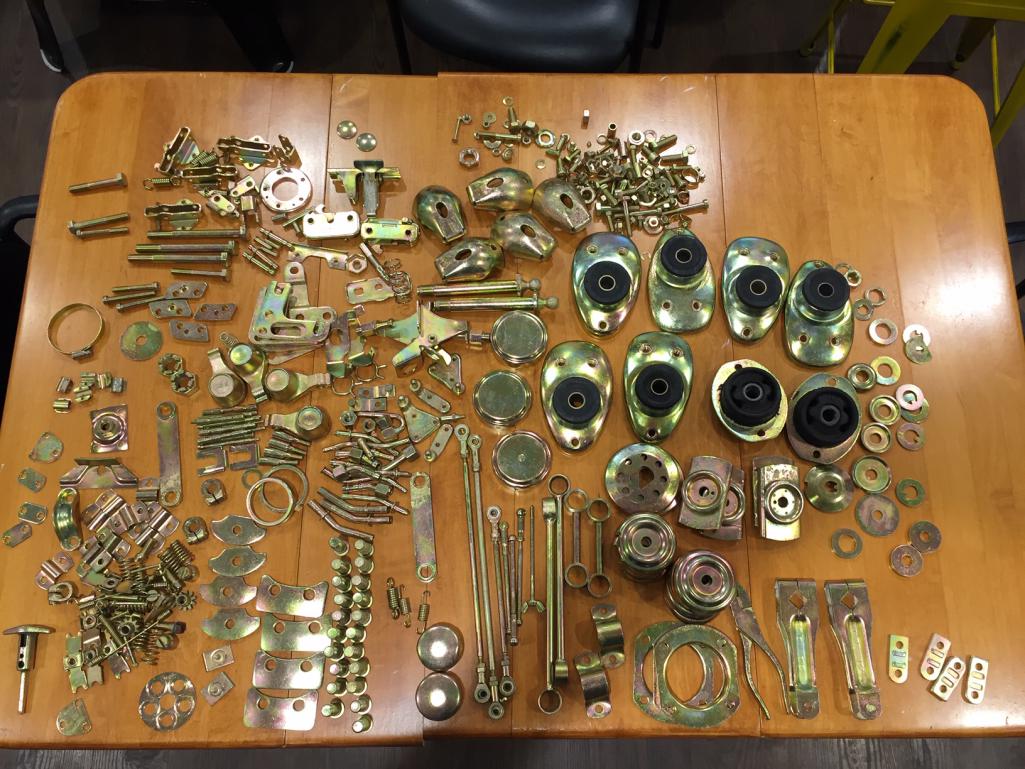

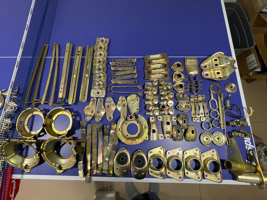

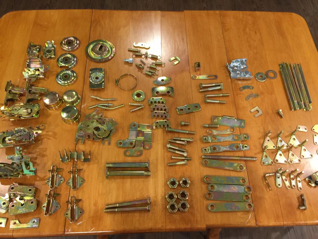

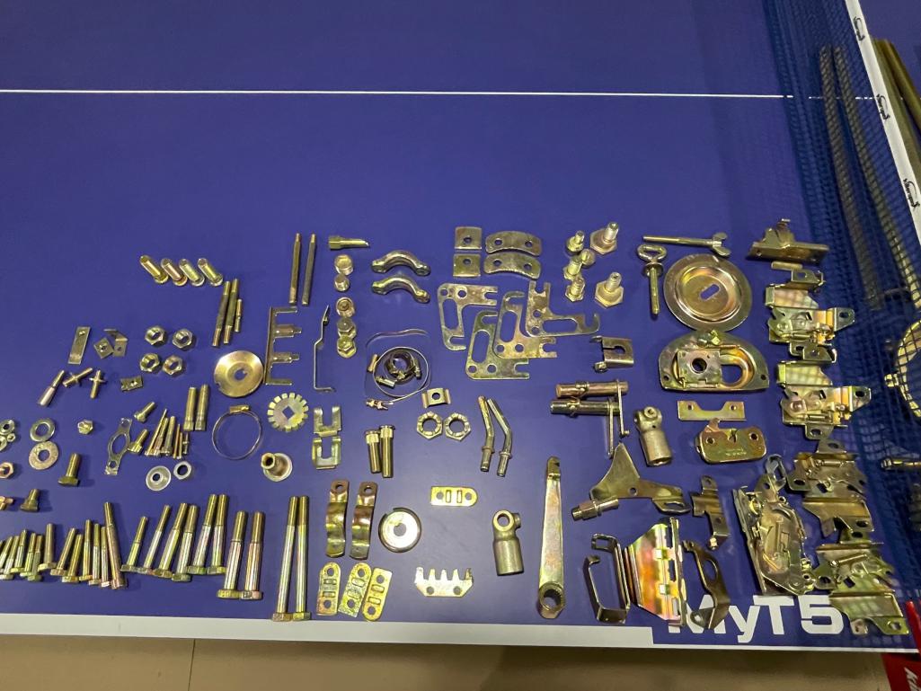

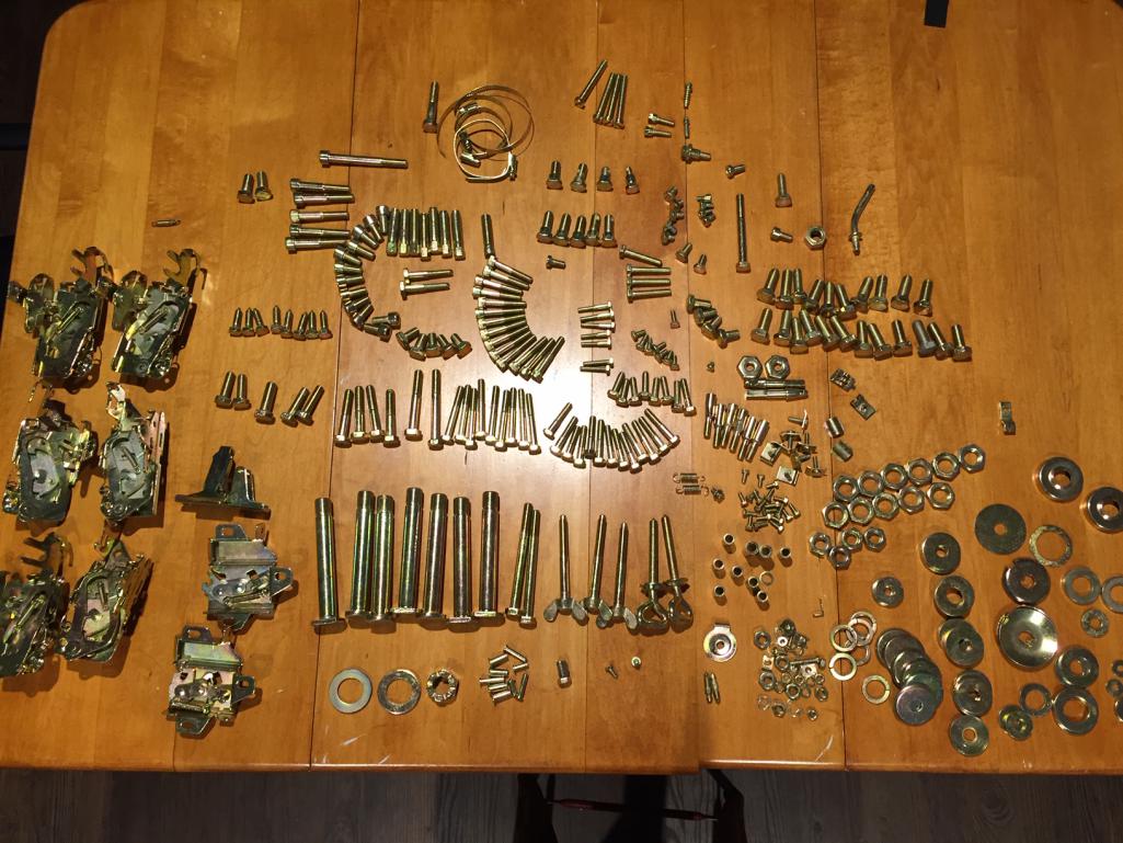

I’ve wired wheeled a lot of the fasteners and sent them out. Call PMB. Their rates are much better than your local guy (true 6?). Bel metric is fine for the normal stuff but at least a small percentage of the hardware is special to Porsche and the large nuts and bolts are expensive. I’ve done a couple parts in the past.
Attached Image Attached Image Attached Image Attached Image Attached Image Attached Image

When you finished the car did it smell new?
Love the level of hardware attention - even the headlight mounting system!
Thank you,
VERY IMPRESSIVE
