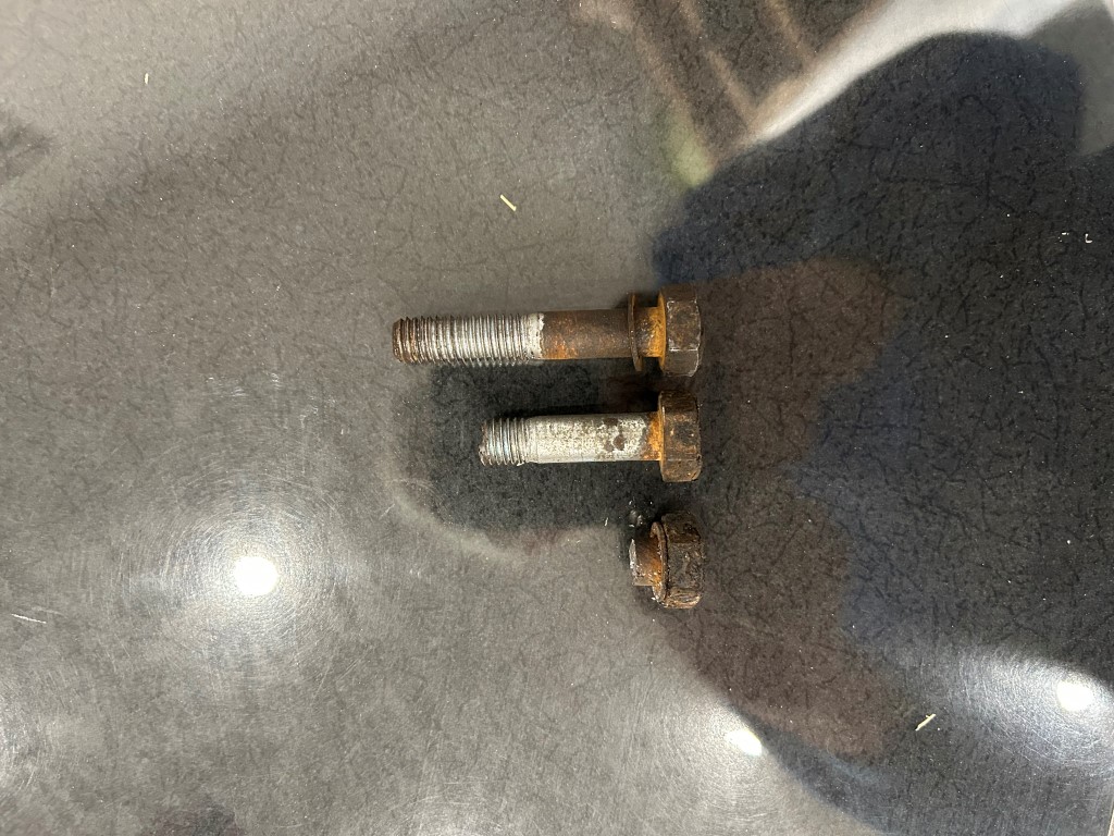

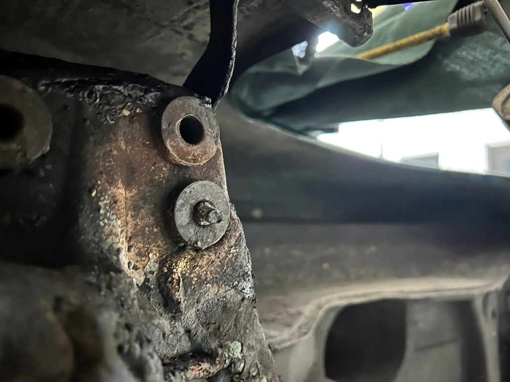

Long story short, 2 of the 3 bolts holding the left rear trailing arm broke on me. One broke and left some of the bolt out of the hole so I thought I could get it with heat and vise grip but nope. She is stuck. The other one broke and what is left is in the hole.
I cannot believe I am the first 914 owner dealing with this.
As I said, for the bolt that left me something to work with my plan was to heat it and use vise grip to try to get it. Tried on multiple occasion but she does not want to come out.
For the other one I guess I only have left to dril it out and try to redo the threads hoping for the best.
Does anyone has any other advice or method to try.
I do not have a welding machine so welding a nut is not an option for now and not sure it would work (for the one that sticks out of the hole).
I am open for any advice. I plan to work on this with my son this weekend.

Those bolts go all the way through the body and have plastic plugs sealing the other end.
If you look on the top side of the suspension console you can find the plugs, they may be covered in undercoating. Pull them out and you will see the threaded section.
I use "pimp juice" on rusted ferrous parts. Works better than anything I've ever bought!
1/2 acetone (nail polish remover) and 1/2 DEXIII atf. I use the old stuff over DEXVI.
Soak bolts...
Sometimes I've had the pimp juice "Free up" completely locked up junk.
I have a set of left-handed cobalt drill bits that I would use next to drill out centers of bolts (the buried one). Sometimes the drill itself extracts the bolt.
The one that is still sticking out I'd clamp VGs on and work bolt back and forth a tiny bit until I saw movement. If you can break it lose you WON!
Worst case I'd carefully use a torch to heat up the threaded insert. Heating from the bolt side (with torch) won't work.
They do have "inductive" bolt heaters that MIGHT work on the one exposed. I have not used one yet but they can apply the heat specifically to the bolt and heat up the stuck portion enough to make a difference.
The internal broke off one would be the one I'd expect trouble out of

You are so (IMG:style_emoticons/default/sheeplove.gif) especially on those that broke off inside the bobbin. I don’t envy you. May God give you lots of courage and patience.
Ninja’s suggestions are solid. Start soaking the fasteners today!
Personally I’d consider hiring someone with a welder to deal with the exposed one.
On the ones broken off under flush - I’d find or fabricate a drill guide to keep any drilling with left hand drill bits centered. I would also pre-grind the underflush fastener as flat as I could get it to prevent the drill tip from waking off center on a jagged - fractured bolt.
Regardless of what happens . . . For the love of God, don’t try to use a bolt extractor
I had one of these come to me pre-broken and with a broken off EZ out in the bolt when I bought my car. I ended up replacing the bobbin during a compete restoration surgery. Details in my build thread if you want a view to the internals of what you’re dealing with. Page 3, post #46. Link to my build in my signature.
I dread thinking about doing this on car & upside down. The saving grace is that Tangerine Racing sells the bobbins if it all goes to (IMG:style_emoticons/default/stromberg.gif) They are weld in and a whole project unto itself . . . But at least they are available vs having to fabricate them from scratch.
Give it your best and if you need clarification on how to make the drill guide, etc. just ask for more clarification.

One thing that I am unsure of is the fact that these 2 ''bobins'' are open from bottom to top. I just verified on the passenger side and the bobin in the front, I can get through with a punch (or anything else for that matter) but the 2 at the back, I can't. Tried from the top or bottom. There seems to be some metal plate in there. Not a big problem, I can drill through, but I guess it could be the same on the driver side where I have my problem.

I successfully drilled out 3 of 6 on a car in my shop, just last month.
It is one of the worst repair jobs on a 914.
Saving the threads is important because the next level of repair involves replacing the heavy steel sleeve that the bolts thread into.
I used to sell replacement sleeves.

Depends on the MY of the car. Early cars DID in fact use caps, later cars the holes at top were either welded or brazed closed. (IMG:style_emoticons/default/idea.gif)

All three are open from above with the plastic caps on them. If it was me I and there were any threads left in deep broken I would make a drill guide from a bolt to center your first drilling with your new left hand cobalt drill, not the harbor freight variety, and then sequentially drill with the other new left drills you buy until judt the threads are left. Then pick those out and carefully retap. The other you probably will have to grind flat and drill, I dont see enough material to grab. But as others have said soaking is your friend, I use free all but sure smells like acetone and atf. It can be done.

Mine seem to be capped like 1/2 to 3/4'' from the top. As I said, not a big problem as if needed, I could drill through.
In the case the thread get trashed, does going to a larger bolt could be an option. The sleeve (bobbin) seems beefy enough to accept a larger bolt. I guess it would mean increasing the size of hte holes on the trailing arm console. Does anyone see any problem to this last resort option, before having to replace the sleeves. One other option I see would be to have long bolts going thought the sleeve and putting a nut on top of the sleeve.

My bet is the caps were removed / lost and the holes at top left open. Dirt and corrosion then sits on top of the bolt forming a plug. I’ve seen that before.
Again, start soaking with penetrating oil, pimp juice or whatever. Fill the hole - let it sit. Rinse lather repeat. Do this for days in advance.
Then see if you can begin to remove it - break it - drill it - chisel it once it softens up.
The other less likely option is someone broke the bolt in there previously and left it. Maybe was only grabbing a few of the lower remaining threads with a new bolt threaded in below the broken portion. (IMG:style_emoticons/default/confused24.gif)
As always - start least destructive and work your way to more aggressive methods. Do Not use an EZ out - once that hardened piece of tool steel breaks in a bobbin you’re absolutely screwed with EDM being the only method to remove hardened tool steel. And by the way - practically impossible to EDM on vehicle; even harder to EDM on car and upside down. Don’t reach for the EZ out, just don’t.

I've seen plenty of cars repaired by drilling out the threads and using longer thru bolts. I don't like it but it is a whole lot easier than replacing the sleeve. A potential problem with using larger diameter bolts is that they may limit the toe adjustment range.;

So my son and I were able to deal with the buried with. We drilled it from top and bottom but the 2 holes we created are not aligned so the M10x1.5 thread are no longer usable.
The option we selected was to make new threads (M12x1.75) at the bottom of the bobbin and we will use larger bolt to attach the console. As ChrisFoley pointed out this may limit the range for toe adjustment, but will see.
Tomorrow, we will start to deal with the other one.
