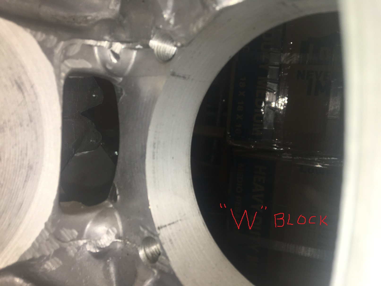

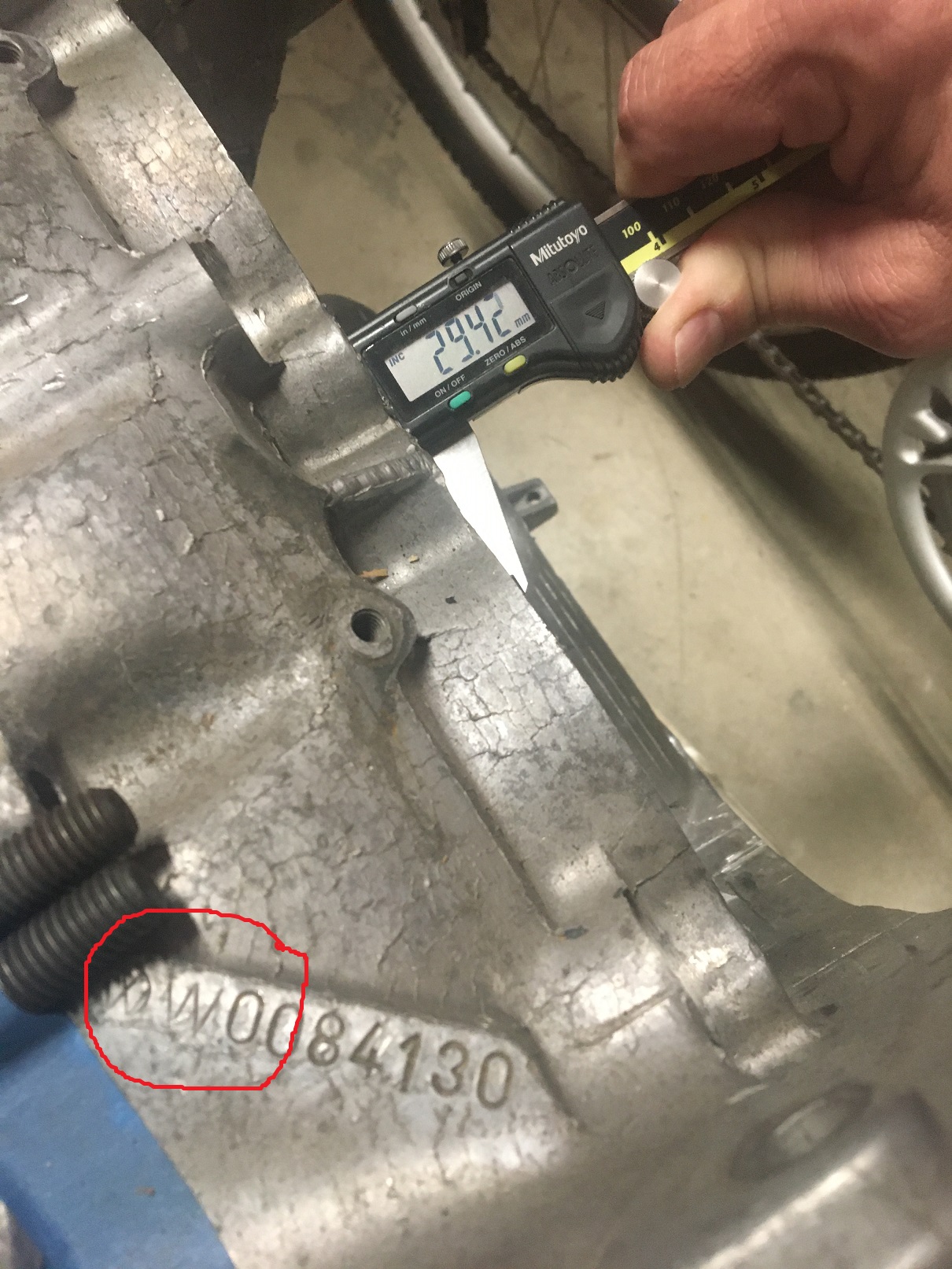

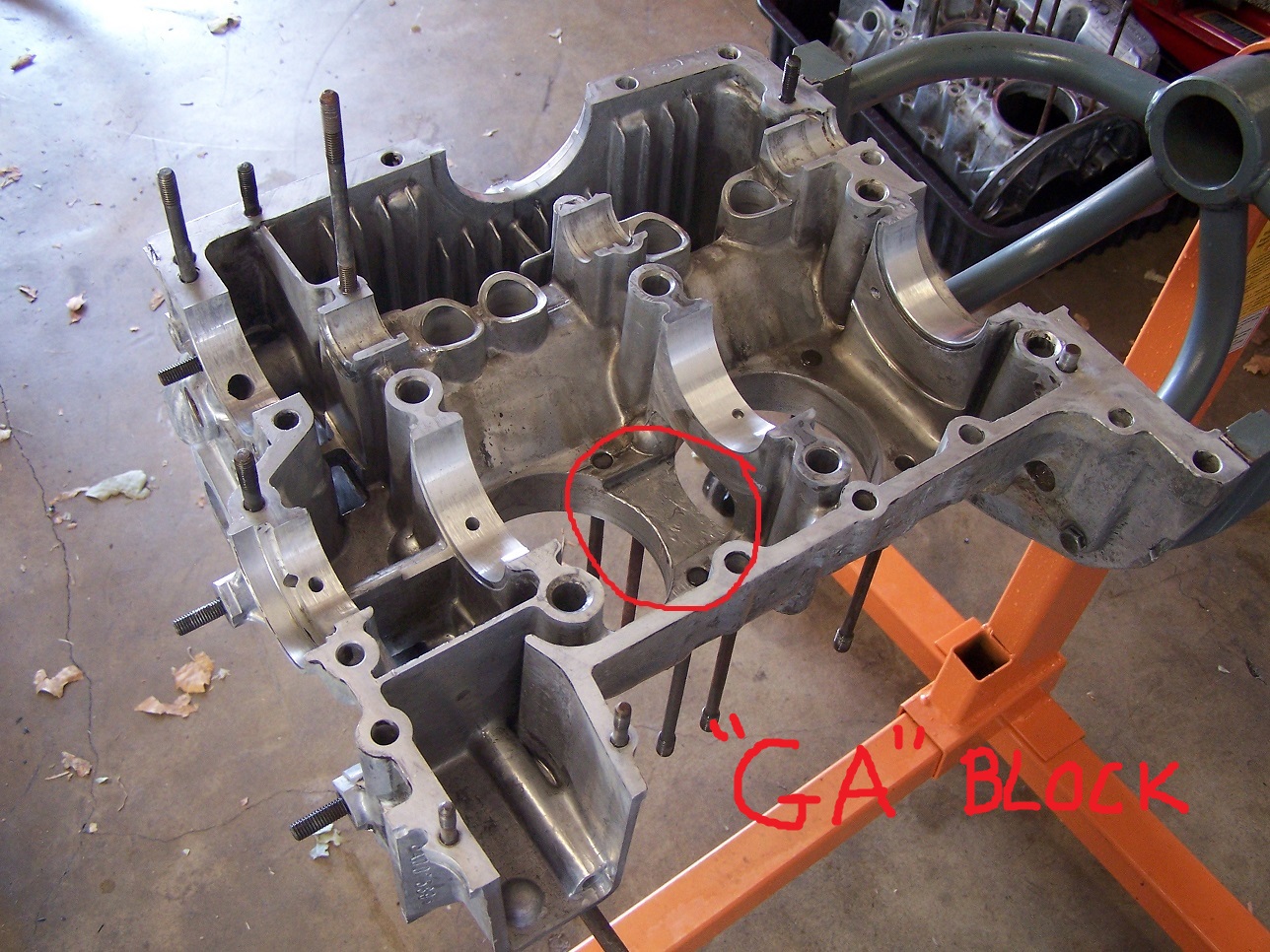

@technicalninja Care to explain this part in bold in your comment above? (IMG:style_emoticons/default/blink.gif)
GA blocks do not have the full thickness under the cylinder registers like the early “W” blocks have. There is a recess in the GA and other cases whereas the “W” cases are full thickness (no recess), making them more desirable.

I don't have a W block to compare my cases with.
I watched his video on blocks and when he got to the section about register thickness mine does NOT have the depression like the GC blocks he showed.
The casting directly in this area is flat on my GA. The less desirable blocks seemed to have a depression in this area.
Maybe the Ws are even thicker at this point.

post Dec 3 2024, 10:48 PM
Posts: 2,207
@technicalninja : I guess you lucked out on your GA engine block because mine is per video description and has the backside of the register thinner in the narrow area. See picture below:
Now the "W" case look like this as shown in the video and yes the constant thickness of the register area seems to be about 29-30mm. Below is a picture of the register backside and thickness measurement. Unfortunately for the OP, this block is now sold. (IMG:style_emoticons/default/sad.gif)
Hopefully the OP will find what he is looking for and these pictures can help!
GLWTS! (IMG:style_emoticons/default/smile.gif)

Just split the case--have the same as the "GA" block as shown by Montreal914 Not what you are asking for.
