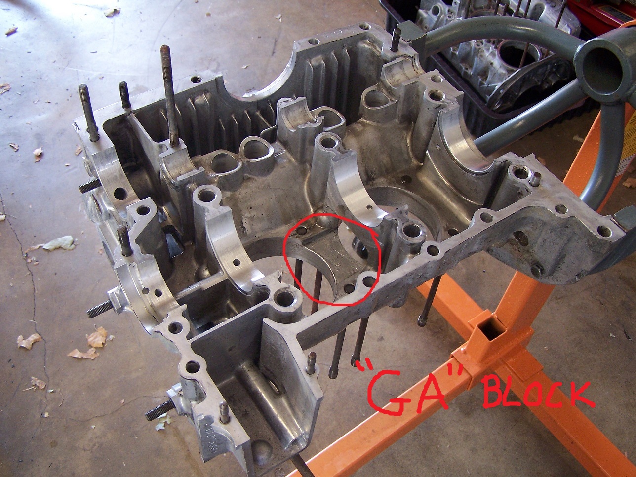

@technicalninja Care to explain this part in bold in your comment above? blink.gif
GA blocks do not have the full thickness under the cylinder registers like the early “W” blocks have. There is a recess in the GA and other cases whereas the “W” cases are full thickness (no recess), making them more desirable.

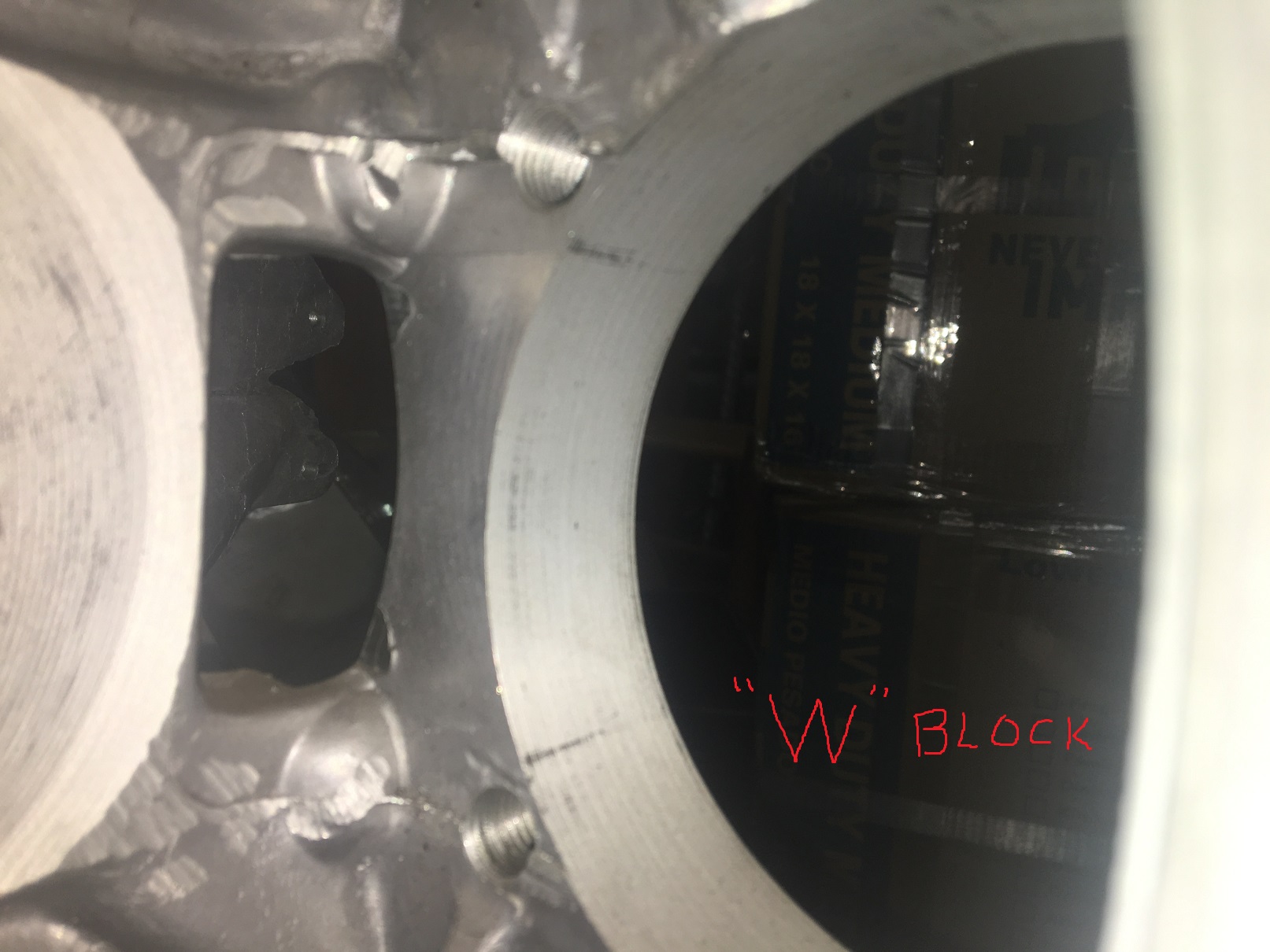

@technicalninja : I guess you lucked out on your GA engine block because mine is per video description and has the backside of the register thinner in the narrow area. See picture below:
Now the "W" case look like this as shown in the video and yes the constant thickness of the register area seems to be about 29-30mm. Below is a picture of the register backside and thickness measurement. Unfortunately for the OP, this block is now sold. sad.gif
Hopefully the OP will find what he is looking for and these pictures can help!

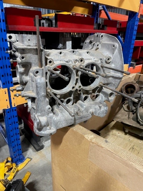

peteyd
I have this case I can sell you. send me a PM for pricing
Click to view attachment Click to view attachment

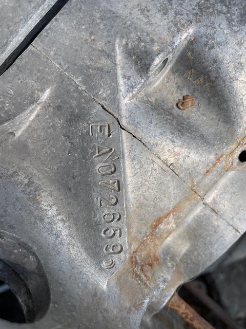

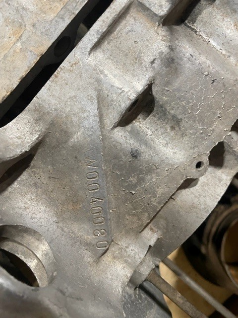

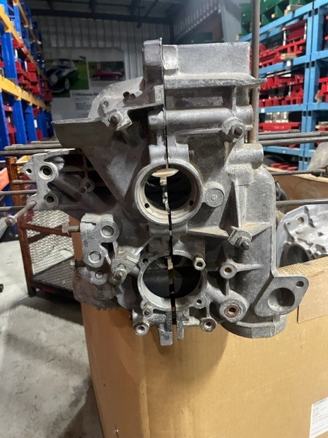

friethmiller
I have/had two 1.7 crankcases. One, which was a “W” block that I kept another was an EA block I gave to a buddy. I was over at his house the other day and decided to check the registers on his block. They are thick like the “W” blocks. Didn’t check for a windage tray but was surprised that there was no relief cut.
