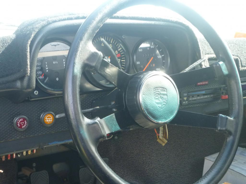

Hi all y'all,
I am getting tired of having my horn go off at inopportune moments because I have nudged the butterfly on the steering wheel by mistake. Ahh, a smooth sharp left turn with great savor faire an... blaaaaahhhhhhhhhhhhh, dammit.
So I want to be a cool kid and have a puck button. But not at that price! (insert eye watering emoji) And of course I make everything myself anyway. So could someone give me the OD and ID and height in and out? I can work it out from there. Might go with aluminum but also might go with ebony or rosewood from scraps that I have. Thanks so much. If necessary, I can bring calipers to RRC, but online would be better. That way I won't lose the scrap of paper I have them written on.
I know that there is a 3D printer file but I don't think that I could unravel it to get the measurements.
Thanks so much.

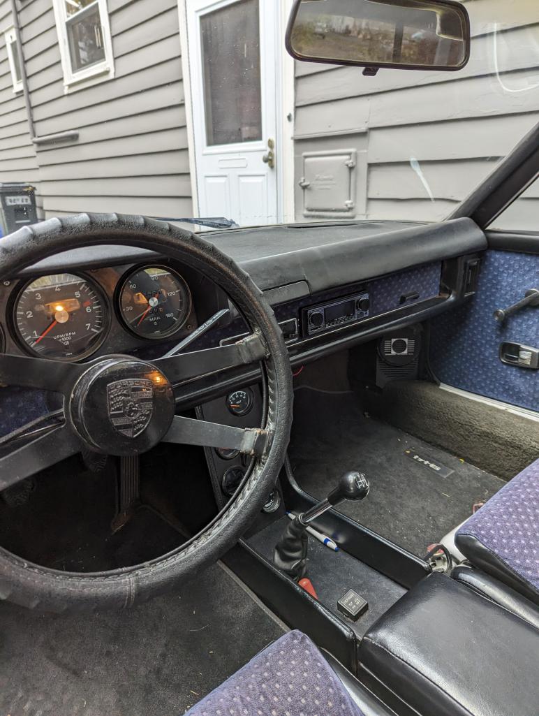

I built one with 914 rubber plastic housing ,the biggest cost is the chrome trim ,found the leather insert @ a fair price , but really not that cheap but result was what I wanted ,cheers.

(IMG:style_emoticons/default/agree.gif) yes it wasn't great ,the one I got was strangely a grey/black colour so I repainted it satin black , it was also a bit out of shape but when clipped on seem to look better .
After that pic was taken I packed out the leather with a piece of felt underneath and it improve the look more ,cheers.

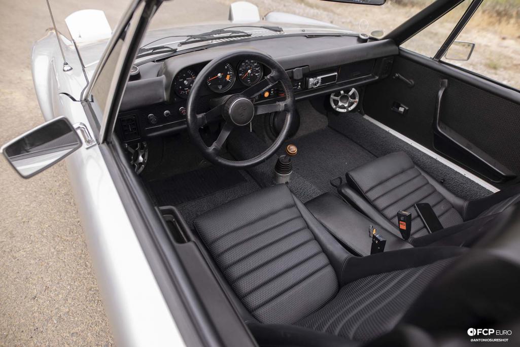

Mine keeps you from hitting the horn and still looks better than the bat wing. Which is waiting in the bat cave for when I would like to hit my horn at random moments.

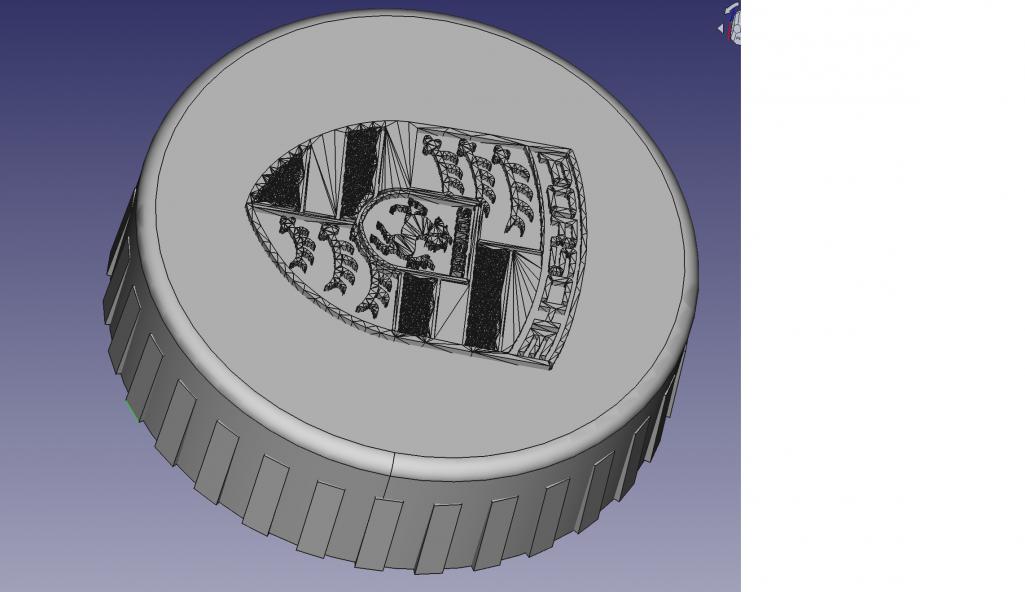

My dimensions at the base are 100mm OD 95mm ID and I have a 19mm depth cavity where I mount the metal base for the horn mechanism. The fit and clearances are all good.

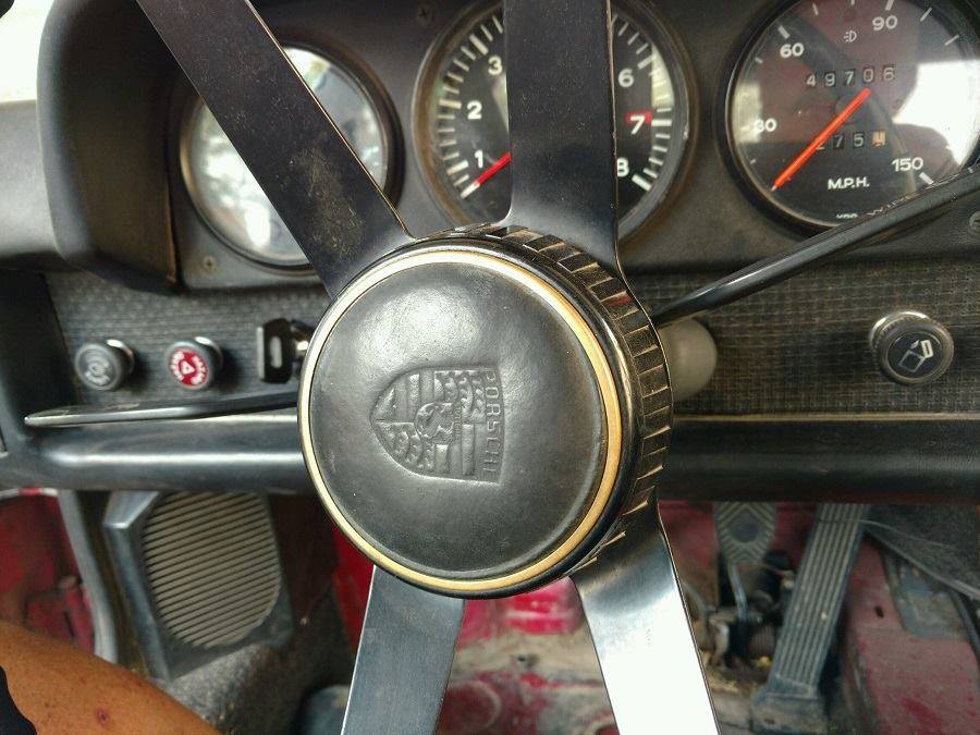

OG (IMG:style_emoticons/default/beerchug.gif) ,, Glad to have grown up in a Porsche rich area with a good ,Junkyard,,,
sent you a message..

nice. I am learning how to use lattice2 in freecad, that picture will really help recreate the ribs on the side of the puck.

it's getting there...
