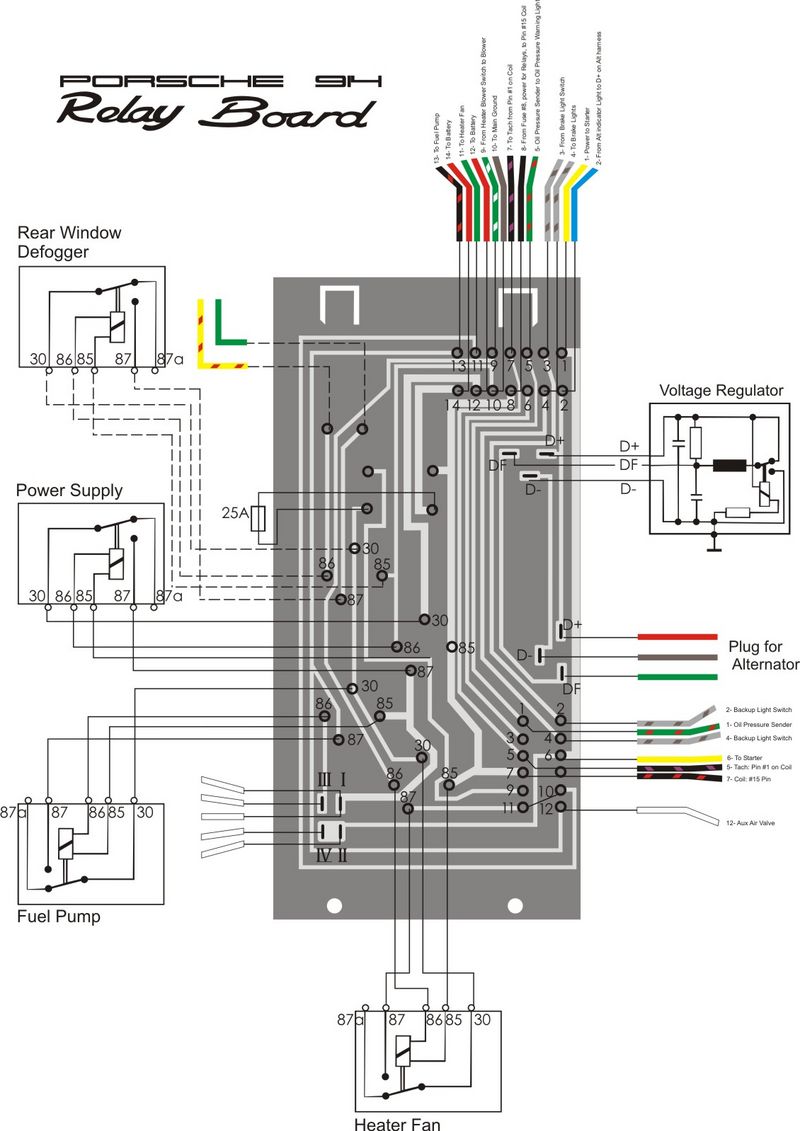

Pull the VR or its connector to reveal the connector on the relay board.
Short DF and D+ with a length of wire. This is simulating the VR trying to get maximum voltage from the alternator.
Start engine and measure the battery voltage. It should be around 16V for a good alternator.
If you do get 16V then your VR likely needs replaced.

I think you're going too deep too fast. Generally wires and connectors do not cause these types of no-charge issues. Try doing the test I outlined previously. You will at least be able to measure the output of the alternator.
Another test is to run the engine and measure the voltage at each of the 3 wires to the alternator (D+, DF, D-) and battery voltage to chassis ground.
D+ should be 14V
Battery should be 14V
DF should be 5-9V
D- should be zero
Measure at the VR or alternator connector. You can learn a lot about the charging system with this simple test.

QUOTE(Chaznaster @ Sep 4 2024, 07:16 PM) *
I am back with some data ...
Battery after full charge and 3hr sitting : 12.5v
Battery with VR removed and DF / D+ jumped : 17v (at 1200 RPM. Did not get this at 850 but expect it would be low)
OK that number looks good for the alternator at maximum output. Was this the battery voltage?
QUOTE
Alternator to ground
At 1200 RPM
D+ 13.6v
D0 0v
DF 5v
At 850 RPM - note alternator dashboard light often flickers here
D+ 0.7v
D0 0v
DF 0.5v
If you measure these voltages again, please measure the battery voltage as well.
At 1200 the numbers look good. D0 being zero is expected. Also D+ and DF looks good.
At 850, did you measure these voltages after doing the 1200 test? Or a different run? With D+ at 0.7V, the alternator is not functioning.
If you go from 850 to 1200 then to 850, does DF go from 0.7 to 13.6 then back to 0.7?
