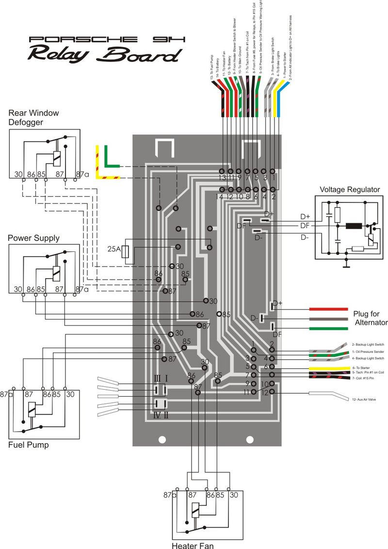

You can easily test the alternator separately. You mentioned the GEN light comes on. That is good and necessary.
Try this:
Ignition off.
Pull the VR or its connector to reveal the connector on the relay board.
Short DF and D+ with a length of wire. This is simulating the VR trying to get maximum voltage from the alternator.
Start engine and measure the battery voltage. It should be around 16V for a good alternator.
If you do get 16V then your VR likely needs replaced.

I think you're going too deep too fast. Generally wires and connectors do not cause these types of no-charge issues. Try doing the test I outlined previously. You will at least be able to measure the output of the alternator.
Another test is to run the engine and measure the voltage at each of the 3 wires to the alternator (D+, DF, D-) and battery voltage to chassis ground.
D+ should be 14V
Battery should be 14V
DF should be 5-9V
D- should be zero
Measure at the VR or alternator connector. You can learn a lot about the charging system with this simple test.

I am back with some data ...
Battery after full charge and 3hr sitting : 12.5v
Battery with VR removed and DF / D+ jumped : 17v (at 1200 RPM. Did not get this at 850 but expect it would be low)
Alternator to ground
At 1200 RPM
D+ 13.6v
D0 0v
DF 5v
At 850 RPM - note alternator dashboard light often flickers here
D+ 0.7v
D0 0v
DF 0.5v

Chaznaster
Giving it some thought, I would probably conclude that the VR is the issue.
@Spoke what do you make of the numbers.
Thanks.

Spoke
QUOTE(Chaznaster @ Sep 4 2024, 07:16 PM) *
OK that number looks good for the alternator at maximum output. Was this the battery voltage?
QUOTE
At 1200 RPM
D+ 13.6v
D0 0v
DF 5v
D+ 0.7v
D0 0v
DF 0.5v
If you measure these voltages again, please measure the battery voltage as well.
At 1200 the numbers look good. D0 being zero is expected. Also D+ and DF looks good.
At 850, did you measure these voltages after doing the 1200 test? Or a different run? With D+ at 0.7V, the alternator is not functioning.
If you go from 850 to 1200 then to 850, does DF go from 0.7 to 13.6 then back to 0.7?

Batt = 13.2
If I go to 1400 then back down to 850, The numbers come back down.
So no alternator output at low levels ... does that point to a rebuild?
Many thanks.
@Chaznaster
When you go from 1400 to 850, does D+ go back to 0.6V? D+ at 0.6V means the alternator is not running.
One other test to do is the D+ to DF short with VR pulled. Check D+ and VBATT at 850, 1400, 2k. Do them quick since D+ shorted to DF is maximum output. I would want to know if the alternator can work at 850.
Chaznaster
QUOTE(rhodyguy @ Sep 9 2024, 07:44 PM) *
Starts fine when cold? When it’s hot it still spins up, just won’t catch? Have you considered hot fuel? When you are starting when hot, are you touching the gas pedal? My car (Webers) stumbles at startup when hot. 3 pedal pumps then feathering the pedal. You have to get those throttle plates open. Things calm down when the carbs are full of fresh tank fuel. Actually it’s only a few seconds. Are you using phenolic spacers/gaskets on the intake bases? I thought the voltage numbers were more about what the ‘brain’ needed to function.
It starts great cold and most of the time hot. I have a single, central Weber 32/36. It is not over the heads so should not get excessively hot. I am running the spacers, as well, just in case. I usually give it a single pump on the throttle to reset to fast idle. When it does start it comes right to life.
Chaznaster
QUOTE(Spoke @ Sep 9 2024, 09:55 PM) *
QUOTE(Chaznaster @ Sep 9 2024, 06:51 PM) *
I got back to the car today and retook measurements after ensuring it was completely warmed up.
850-900 RPM
D+ = 0.80
D- = 0
DF = 0.61
Batt = 12.2
1000 RPM
D+ = 12.3
D- = 0
DF = 6.5
Batt = 12.4
1400 RPM
D+ = 13.7
D- = 0
DF = 5.0
Batt = 13.3
2000 RPM
D+ = 13.3
D- = 0
DF = 3.3
Batt = 13.2
Many thanks.
@Chaznaster
When I go from 1400 to 850 D+ does go back to 0.6V. And back up upon returning to 1400.
I'll try the next test and get back as soon as I have some more numbers.
As always - thanks.
EDIT: This might not make any sense, but could the belt be slipping at low engine speeds. I would think that would happen when fast ...
iankarr
Just dealt with this on my green car. Replaced the VR and battery and running 13.5-13.7 all the time now.
Spoke
QUOTE(Chaznaster @ Sep 10 2024, 08:13 PM) *
That is weird that going from 1400 to 850 causes the alternator to turn off. Usually once the alternator is bootstrapped it keeps on running.
BTW, when at 850 and V+ = 0.6V, is the GEN light on?
About the belt, it should be tight. Is it?
Chaznaster
QUOTE(iankarr @ Sep 11 2024, 01:52 AM) *
That would be better than an alternator rebuild ...
And congrats on the Bumblebee project!
Chaznaster
QUOTE(Spoke @ Sep 11 2024, 08:53 AM) *
At 850 the gen light is flickering. It goes out as soon as I rev the engine.
I'll check the loose belt and do other tests this weekend. I recently had the engine out and pulled the alternator / replaced and tensioned the belt but maybe I did not get it right ...
Chaznaster
So ... I feel a bit foolish about this ... the cause of the wonky alternator voltages was a loose fan belt. Must have been slipping at lower engine speeds.
Thanks to all for all the help, as always. Special thanks to @Spoke for walking me through the diagnostics.
Now we will see whether we still have a hard start when warm.
emerygt350
QUOTE(Chaznaster @ Sep 17 2024, 02:48 PM) *
