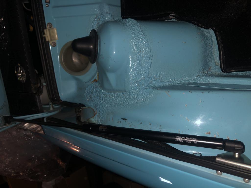

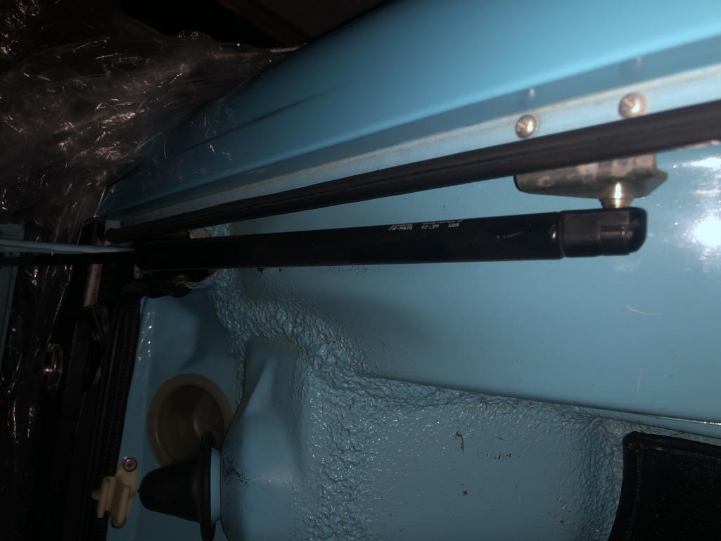

Camp914's kit is the way to go, but IMHO the stock springs are better. My 914 has stock and the wife's came with the camp914 kit, the struts are sort of in the way, you have to go in straight on with placing the top in the trunk, I've rammed the strut a few times. Stock you can be a bit sloppy with your approach and still get it in there.

I installed the CAMP 914 strut kit on my car and never looked back. No more worrying about monkeying with those dangerous torsion rods. Also, I have never found it to be difficult to stow the top in the least. And those struts work smooth as silk.

@ri914 see photos. They allow for top storage. Attached Image

Thank you for this post. One of my 914s has a fiberglass rear trunk lid and a lightened GT style engine lid and I've used struts for both. Switching all three creates more clearance for the rear trunk lid against the rubber gasket and more clearance under the engine lid for the 3.2L's MAF sensor. The explanation of why the rod end should be down, in the link, makes a lot of sense but it is counterintuitive to what I had thought.
BTW, there is plenty of clearance with my Camp914 kit installed and if my aim with stowing the targa top is that far off, I'm nicking something anyway.
