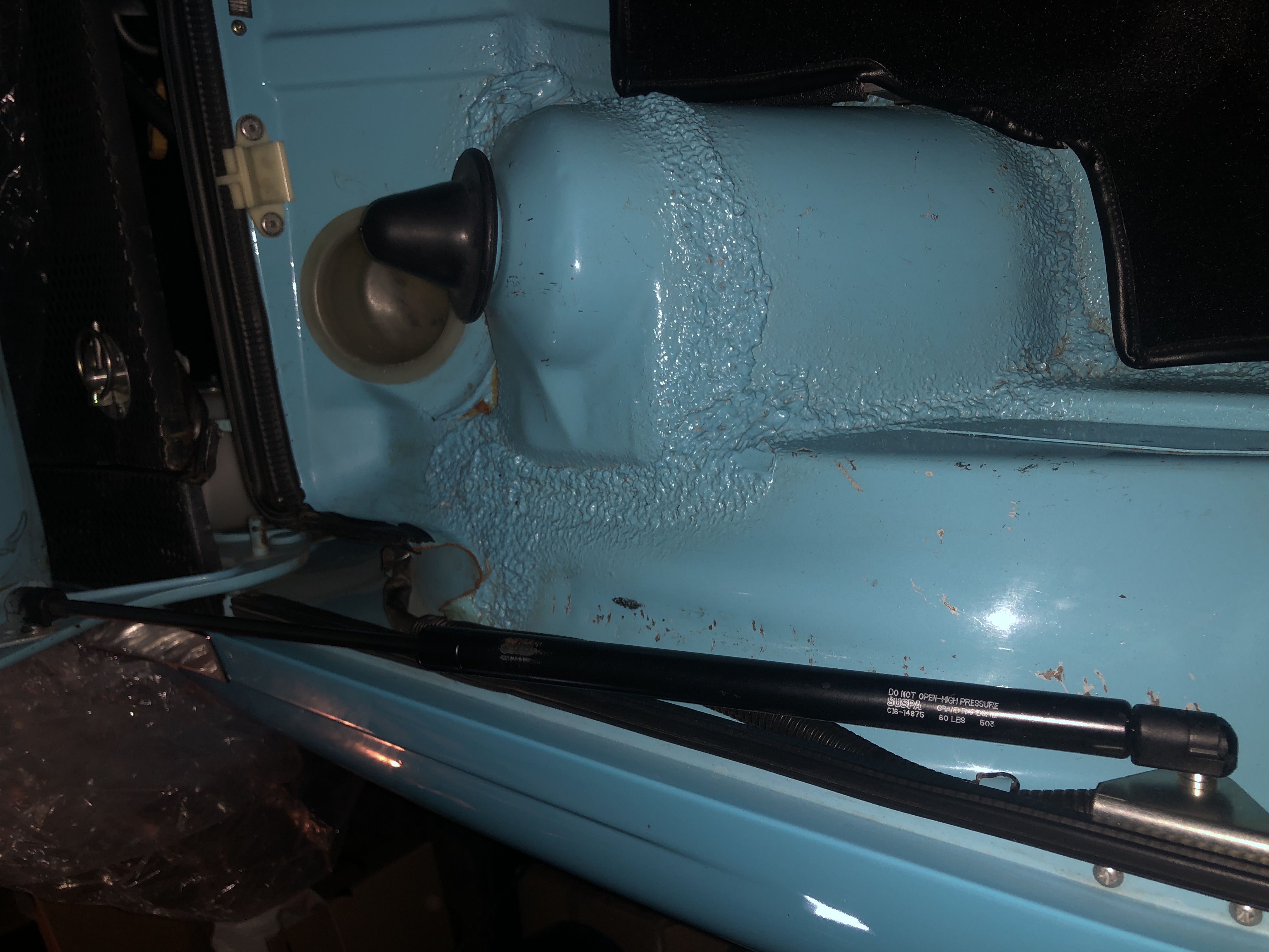

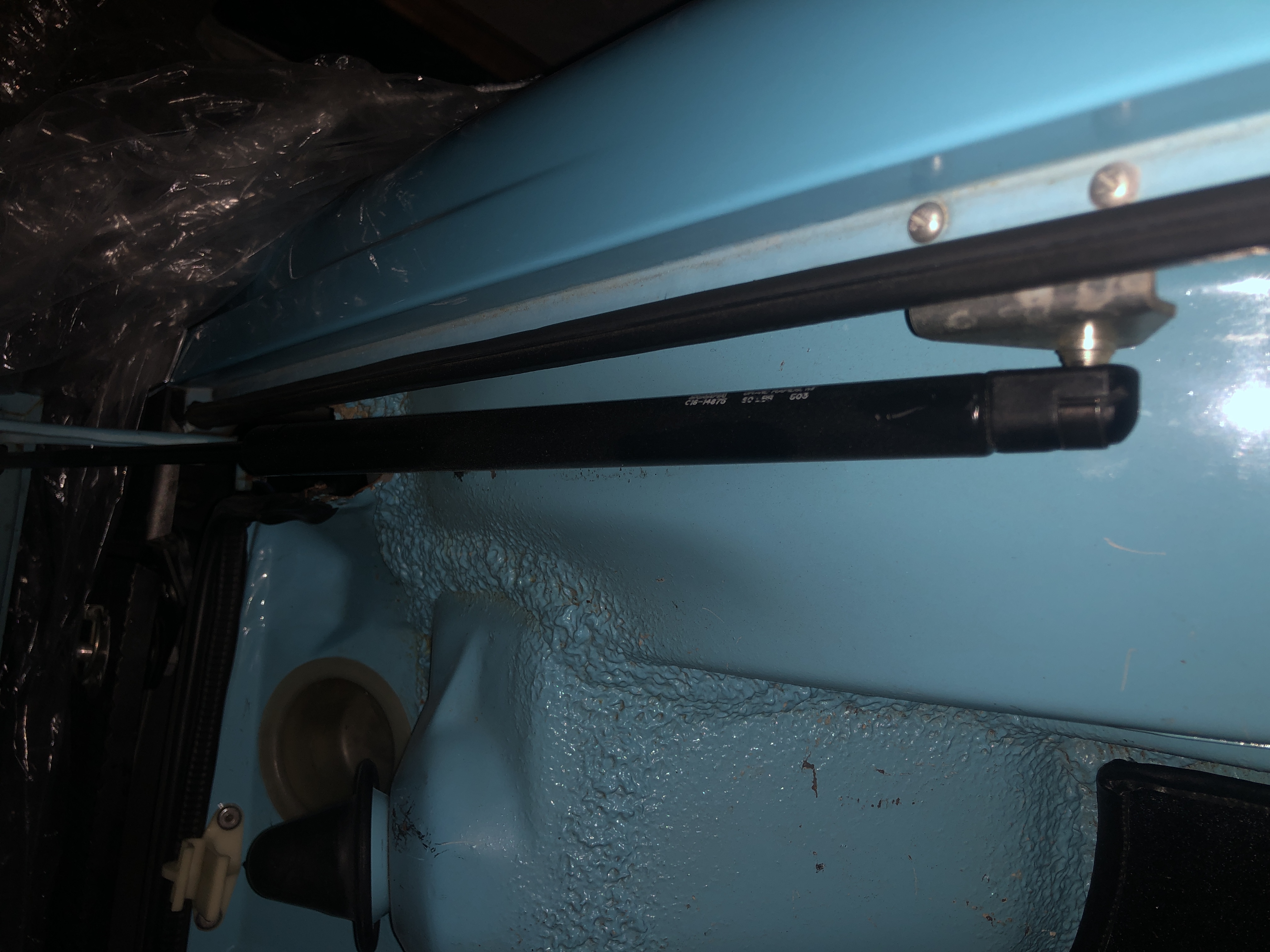

Robarabian
@ri914 see photos. They allow for top storage. Click to view attachment
Robarabian
