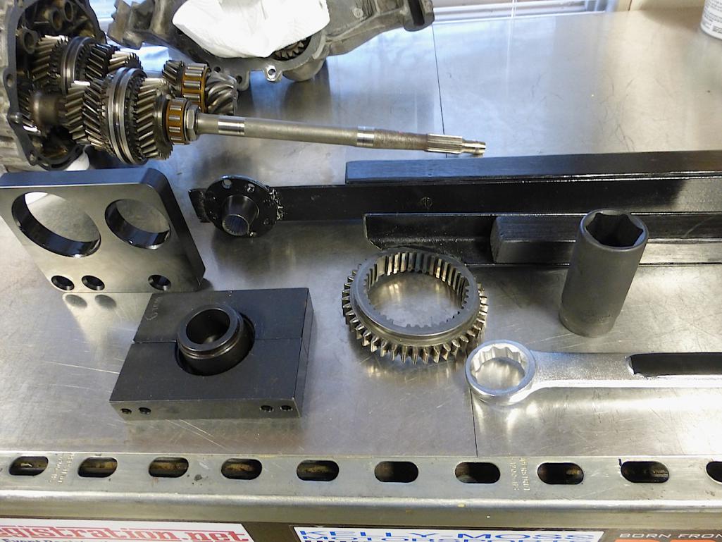

I have the six tools for disassembly and assembly I rent for $135 sent to you, you pay for return shipping. You can have them for a month or so. If ever needed again rental is free just pay shipping. Best, Mark
mlindner
Found image of tools. MarkClick to view attachment
