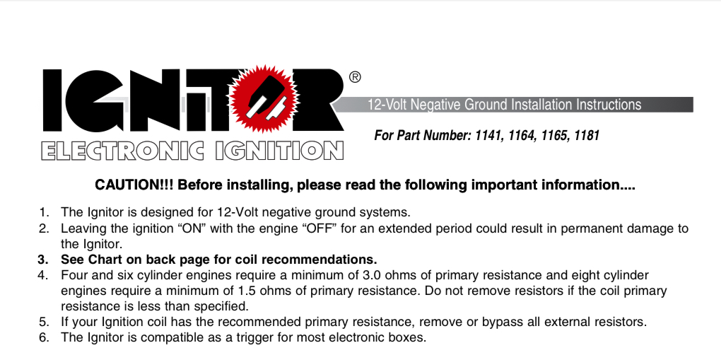

Regarding ballast resistor, measure the primary side of the coil you intend to use. Should be around 3-4 ohms. If it has an internal ballast resistor don’t use the external resistor.
Using a coil with too low of primary resistance will burn points or will destroy an electronic ignition.
Here are the Pertronix instructions as an example:
Click to view attachment Click to view attachment

OK thanks.. there is currently a Beru Germany ZS 172 installed which is described as having an internal resistor and being a direct replacement for Bosch Blue coil (I have a couple of those packed away too I believe). I will check the resistance on this one.

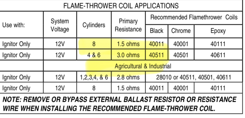

So my Beru measure 3.3-3.4 ohms, 3.3 is spec so I suppose it’s good to go - will not be installed the ballast resistor.

@Superhawk996 posted documentation for the Flamethrower brand of distributor… well I also have one of those (an SVDA model) and was wondering..is there an advantage over what’s currently installed in my distributor? Would you guys pull the stock unit and installl the flamethrower?

I f you are still running the Djet fuel injection system, I don't think the Flamethrower distributor will work, as it has no provision for operating the separate fuel injector points contained in the stock Bosch Djet style distributor. The Flamethrower will probably only work with your engine if you are running duel carbs, instead of the Djet FI system.
