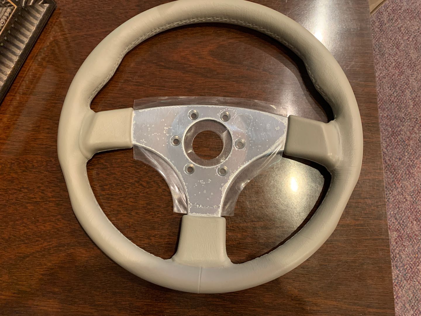

I love the black leather Dino steering wheel that is on my 944 S.
I want to put it on my 914.
So I got a tan Dino steering wheel to go in my 944 S that has a tan interior.
One problem - I can find no solvent to remove the adhesive from the new tan steering wheel. It had clear plastic protecting the chrome which pulled off easily. But I can find no solvent to dissolve the adhesive that held the clear plastic on.
I have tried gasoline, strong carb cleaner, brake cleaner, acetone, lacquer thinner, WD-40,
Seafoam, and even Super Glue Remover.
I can't take the nice wheel out of the 944 S until the new one can go in.
HELP. Looking for advice on a solvent that will dissolve this adhesive.
Pics below - many thanks to all suggestions.

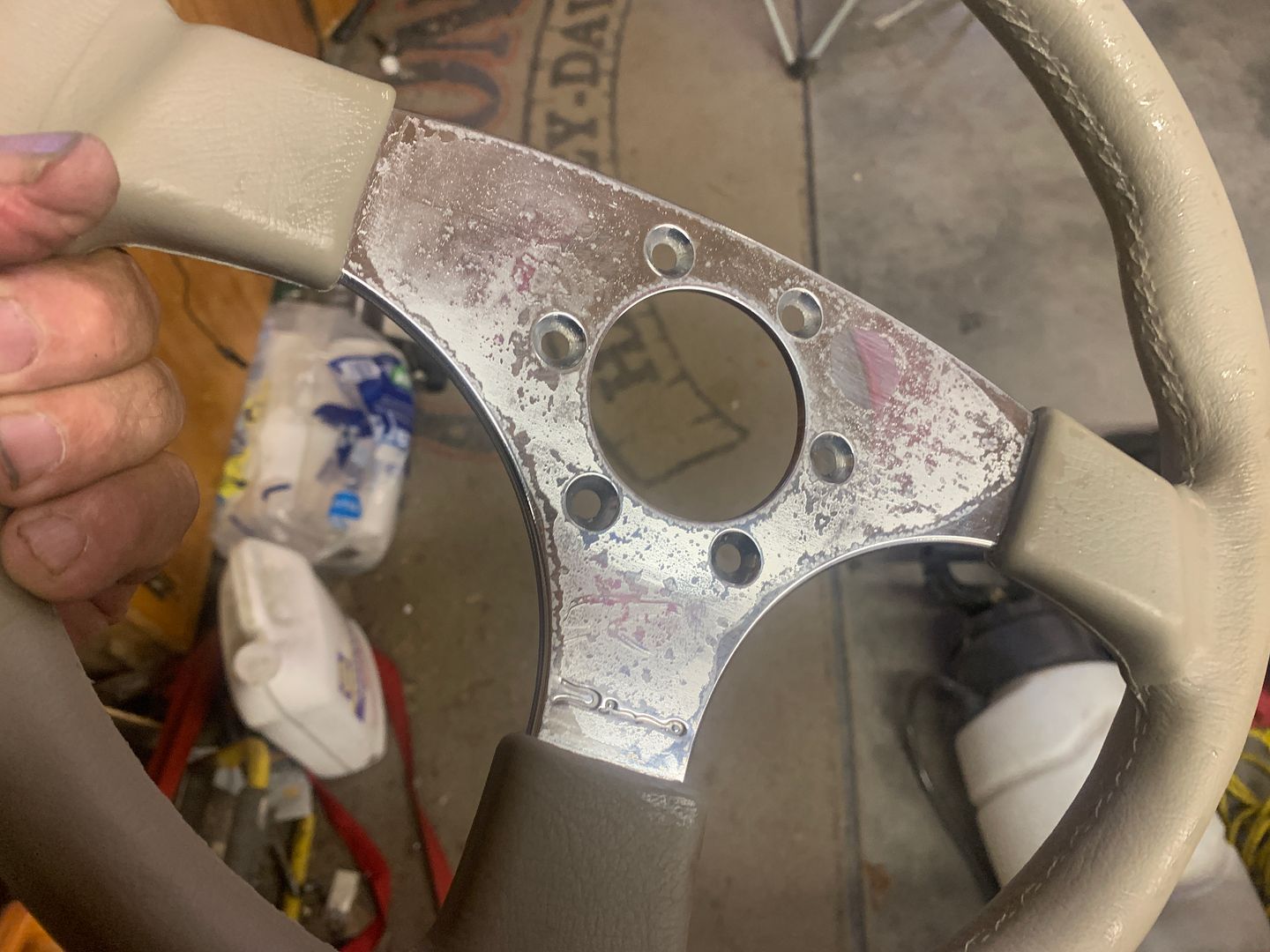

Gatornapper
Sep 3 2024, 07:31 PM
Acetone did'nt touch it.
The Citris seemed to cut it some, but now much - but the pumice in the cleaner didn't do the chrome any favors......
Dawn dishsoap seemed to cut it some but not without tons of scrubbing & elbow grease.
But still wouldn't get it all off...

Gatornapper
Sep 4 2024, 07:00 AM
First thing I did was ask seller - he was clueless.
Thanks to all for the suggestions.
Pumice in the Orange/citrus cleaner scratched the chrome - my bad again.
Slowly coming off with Dawn dish soap, but not all will come off even with tons of hard rubbing.....

GregAmy
Sep 5 2024, 10:43 AM
Are you certain that this is just residual adhesive? Given none of the suggestions involved is working, I'm suspicious that the surface is physically damaged.
If that's the case then it's likely a physical re-polish requirement, such as what's done to sand off the fogged surface of old plastic headlights/covers.
914sgofast2
Sep 5 2024, 10:45 AM
Have you tried Simple Green cleaner? Put some on the adhesive and let it soak into the adhesive for a few minutes before you start rubbing it. Use an old bathroom cotton towel because it is slightly rougher than using an old cotton t-shirt.
The metal on the steering wheel is likely polished aluminum, not chromed steel. You could try polishing out the scratches from the pumice-based hand cleaner with some 0000 steel wool.
