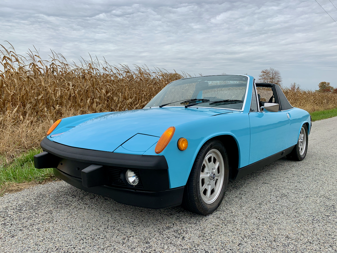

Hello!
currently working on the headlights right now, but I know bumpers are going to be coming up quickly. I have been looking around for a while now, and Vince says he hasn't had any come by lately, so I decided to come right to the experts!
I am planning on backdating my bumpers to the chrome ones, and I was wondering if anybody had any suggestions on who to talk to to find them?
also if any of you have already backdated your bumpers, leave any tips or things you wish you did here!

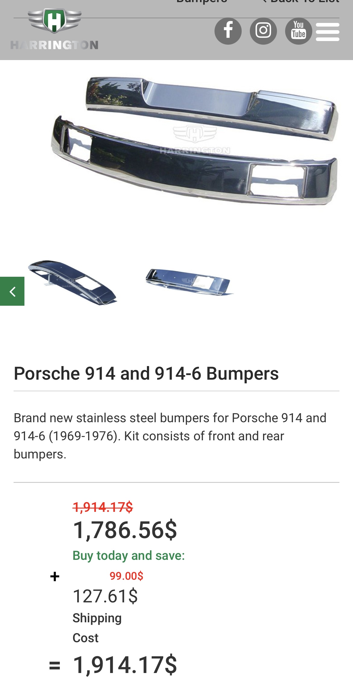

Inquire at Group Harrington
for Stainless Steel Bumpers..
Buy from the Manufacturer….
gandalf_025
I know the SS bumpers seem pricey, but in reality, the cost to buy bumpers, have them straightened and chromed, you would be better off with SS. We really need some update photos of the car with you working on it. beerchug.gif
You have to buy these from George at AA as he has the distribution deal in the USA
His price is a number of $100s more that shown on Harringtons site. Look at AA for the price. He has them in stock
So that is out as far as the price shown from Harringtons site. Ask Oscar what he knows, he is a super nice 914 Buddy and has been a source for chrome bumpers for a while

Mark, I sent them an email and they said not in the USA as they have a deal with AA George
burton73
Dear Robert,
Thank you very much for your interest in our products.
I am afraid that the bumpers we supply are the same as Auto Alanta.
Also, we have given exclusivity of US market to Auto Atlanta http://autoatlanta.com.
Saying this, we can only supply you when the bumpers is sent outside of the US.
Should you have any questions, please don’t hesitate to contact me.
Best Regards,
Thao

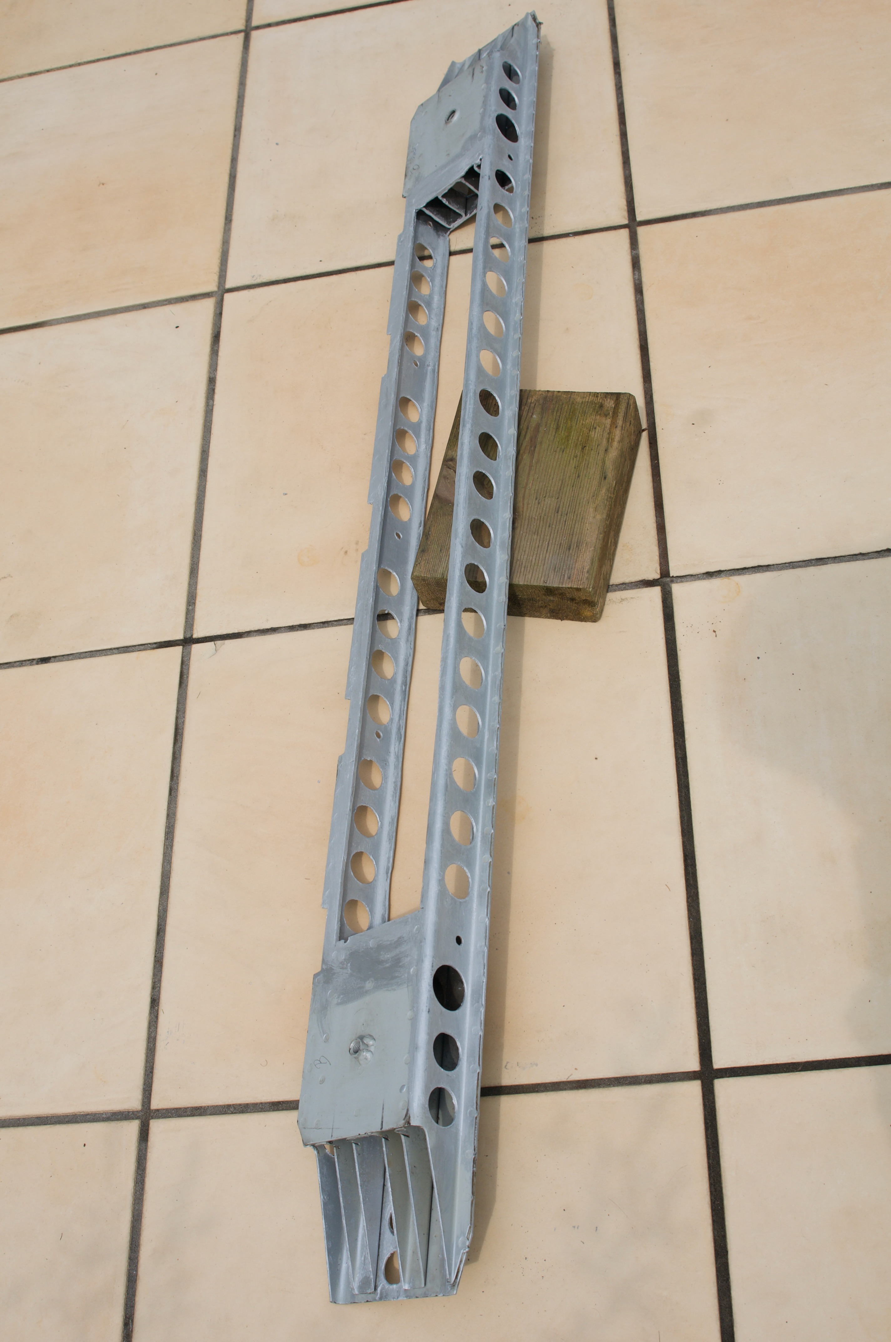

slotty008
I totally agree with Dr. 914. When I bought my '75 in 2015, I was also planning to backdate the bumpers. I'm very glad I didn't. Instead I lightened up the bumpers by removing as much stuff as possible : 13 lbs on the front and 13 lbs on the back and they are still very rigid. And outside they look original. IIRC it was Mepstein who gave me the idea.

Thanks everyone! This is a good complication of tips and will be sure to do these when it comes time for bumpers! Just for reference, the old bumper were really odd and heavy (check out my bumper removal episode) and the front bumper was definitely not stock. Super excited to do this!
