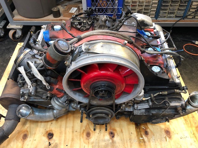

As the title suggests, I'm undertaking a six cylinder heart transplant on my four cylinder '74 914. I've always wanted to build a hot rod of some sort, and a 3.X 914 seems a pretty solid choice. I just hope the patient and donor organ both survive the surgery...
The motor is a 3.0L out of an '82 SC. It needs rebuilding. I'm going to start a separate thread for that over on the Pelican forum in the engine rebuilding section, because I'm going to need lot's of advice. I realize that there are plenty of peops here who've built sixes, but as that forum is dedicated purely to the task it makes sense to me to start the thread there. I'll paste a link for anyone interested once I've got it started. It's not going to be some crazy race motor. I just want a good reliable street engine. I'm not a hundred percent sure what I'm going to do with the chassis at this point, but I have plenty of time to think about it. I work slow.
The overall plan is to rebuild the motor, and then get it running on a start cart, which I've already started to cobble up. At that point I'll pull the four cylinder, do any chassis mods, and stick in the new engine. It all sounds so simple when I type it... Stupid brain.
I've already torn the engine down to the long block, but have paused to get a few things around the garage cleared up. There will be additional pauses along the way. I've got a zillion things to do around here... I'm pretty determined to get this done though, so hopefully said pauses will be brief.

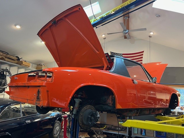

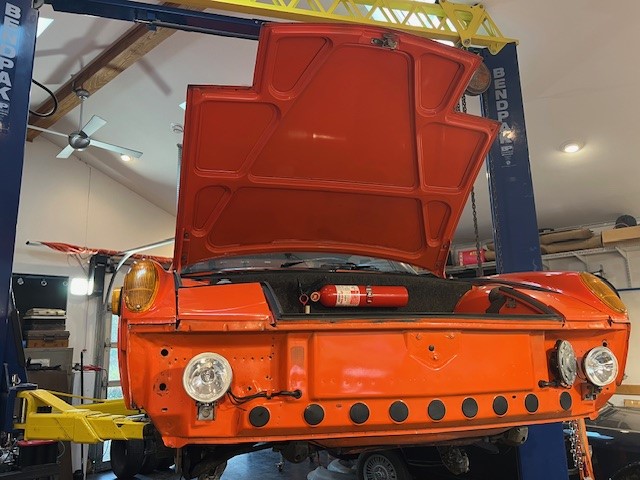

Here are a few pics of where I'm at in the process. One thing I was particularly delighted about upon disassembly is the condition of the rocker panels. They're sound. I knew that it's a solid car, but had never had the covers off.
Detroit

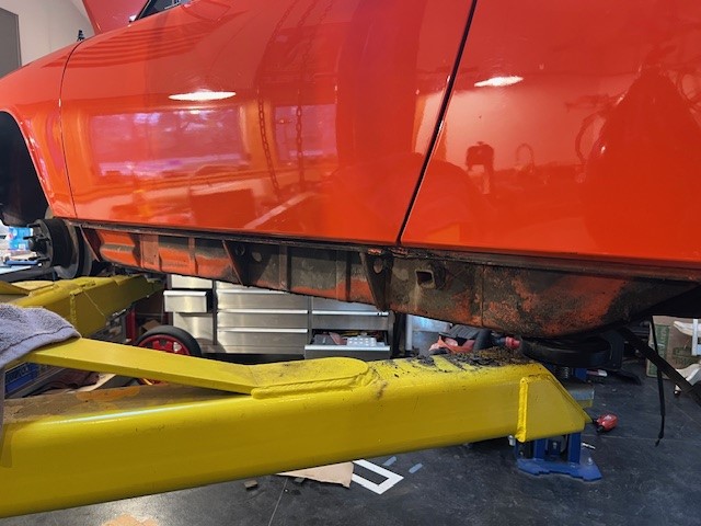

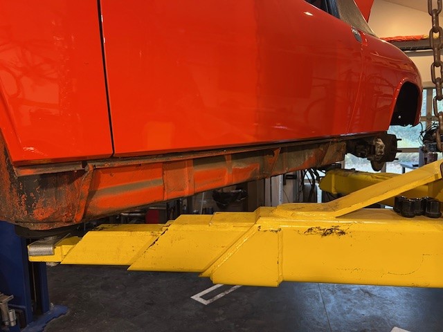

The car has also undergone a bit of lightening...

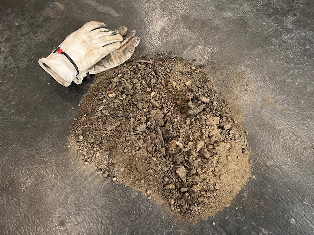

It had several pounds of dirt packed in behind the rocker covers.

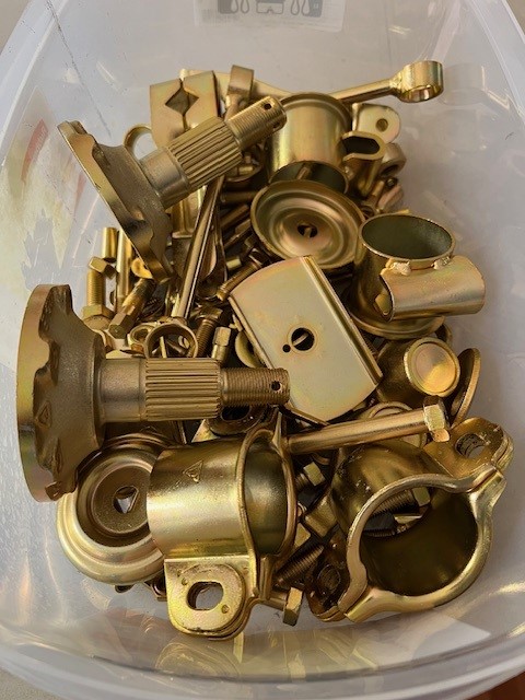

I just love picking stuff up from the plater!...

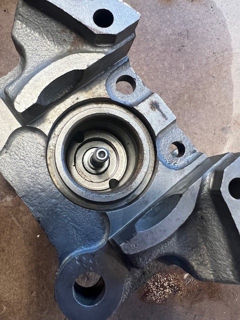

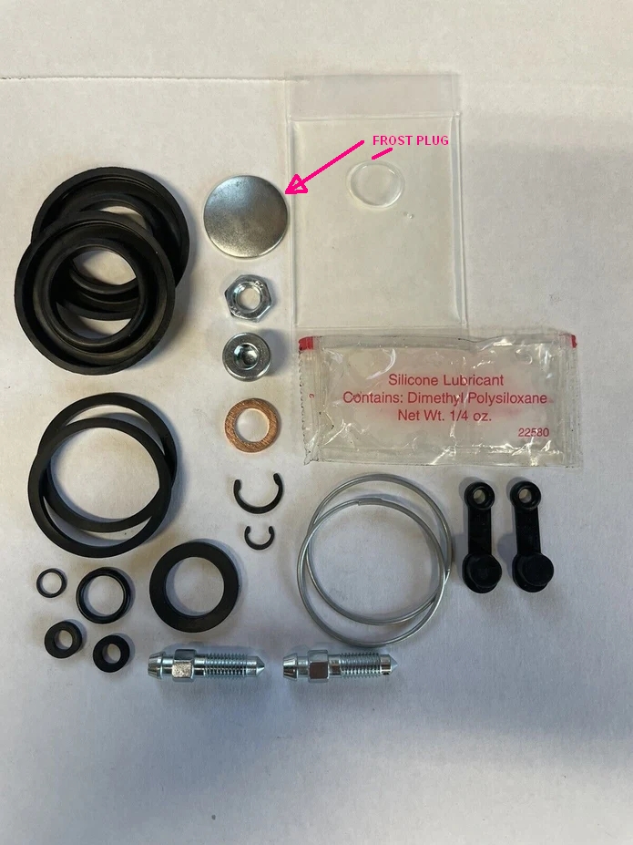

Okay, I could use a bit of help, please...
I've spent the last couple of days with Covid in the garage disassembling and cleaning brakes. Can anyone enlighten me as to how I remove the parking brake lever assembly? I thought that the spring, hat, and circlip within the caliper body might somehow be retaining it, but I've removed those. The lever, while turning freely, still won't slide out of its bore....
davep
If you have removed the clip in the groove at the bottom of the bore, then the threaded adjuster shaft can be pulled out; It is packed with grease, so it takes a bit of force.
To remove the parking brake lever, first acquire the correct rebuild kit with the frost plug. You have to cut the frost plug, and twist it out with significant force. Then remove the clip holding the shaft in place. Some sources supply an O-ring to replace the original seal. That helps, but I also use a garden hose flat ring just under the lever arm; some fit better than others, and some are up to the heat while others may not be.
Detroit
Never mind, thanks. I just found the tech article on the Pelican site...

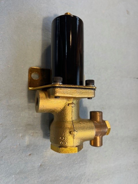

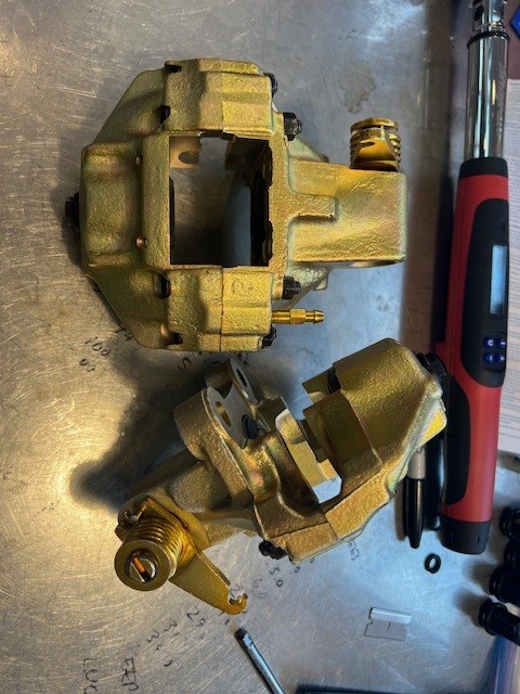

I did get the rears, fronts, and balance valve all disassembled. My hope was to get everything rebuilt over Christmas holiday, but I had some challenges getting everything plated. In the end, the fourth plater I tried got the job done, but I didn't get the parts back until last week. They do, however, look great, and I'm happy to have found a reliable source to plate castings.
The fronts and balance valve are all rebuilt. Rears are next.
technicalninja
Did you rebuild the rear proportioning valve yourself?
If so, how did you set the adjustment?
Nice plating there!
Beautiful!
Jewelry for car folk...
worn
QUOTE(technicalninja @ Feb 11 2025, 12:14 PM) *
Nice plating there!
Beautiful!
I don’t know. It looks like gold plate, and maybe a bit like bling and who am I kidding, I am jealous.

@techniclaninja, I have not yet set the proportioning valve. I'm going to have to cross that bridge at a later date. I've got 911S calipers for the front of this thing. The decision on tackling a 911 rear brake set-up has yet to be made. In any case, I figured I'd have to play with the proportioning valve, otherwise I might have left well enough alone.

The easy button for correctly sized rears is the 914-6 repops that PMB offers.
$1000 for a pair, no core charge!
Correct ratio to your S fronts.
Keeps the original E-brake stuff...
Available with spacers for vented rotors!
That valve is not exactly a proportioning valve and cannot be "tuned" like a normal valve.
That pup reaches a specific pressure and then actuates a pressure regulator cutting pressure to the rear. Even Eric @ PMB calls it a "regulator" and not a proportioning valve.
IMO you need a hydraulic test bed to set activation pressure. It looks "touchy" enough that I've decided to let PMB rebuild my valve instead of doing it myself.
I was hoping you had a work around...

TNinja, thanks for the info. Good call on those PMB -6 rear calipers. That may indeed be the way to go. Not sure what I'll do about that regulator, but I've plenty of time to think about it...
Detroit

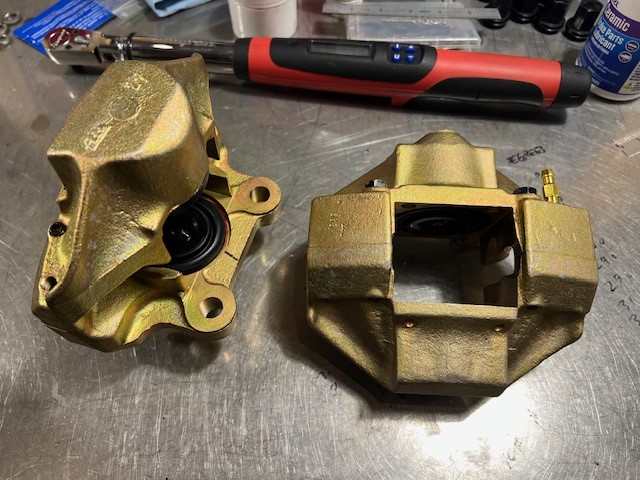

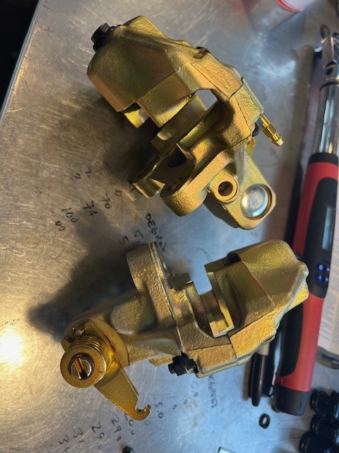

I found some time this weekend, after a week in Florida, to get the rear calipers back together. Another box checked.

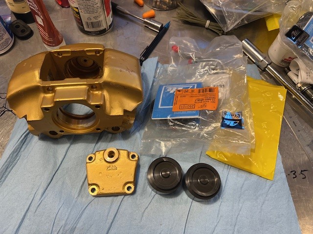

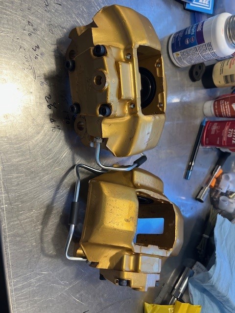

Well, I finally got all the required bits to put the S calipers back together. I didn't bother Polishing the bodies before anodizing. It seemed like a lot of added expense for no real reason... They still look pretty nice.

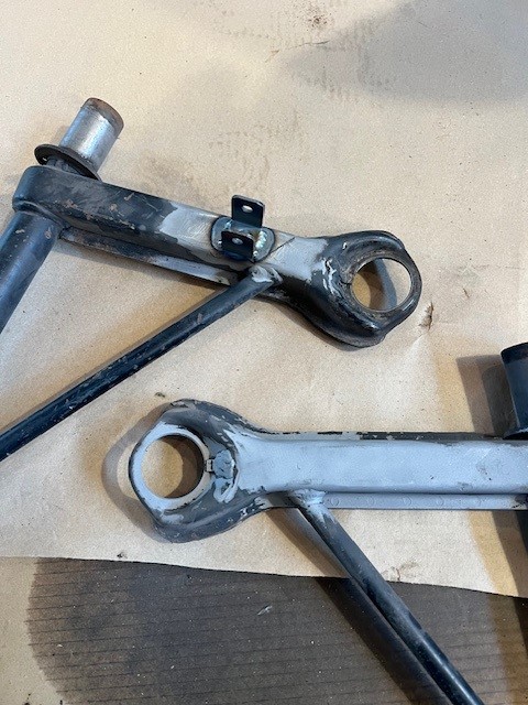

I welded sway bar drop link tabs to the control arms, and dropped them off at the powder coater...

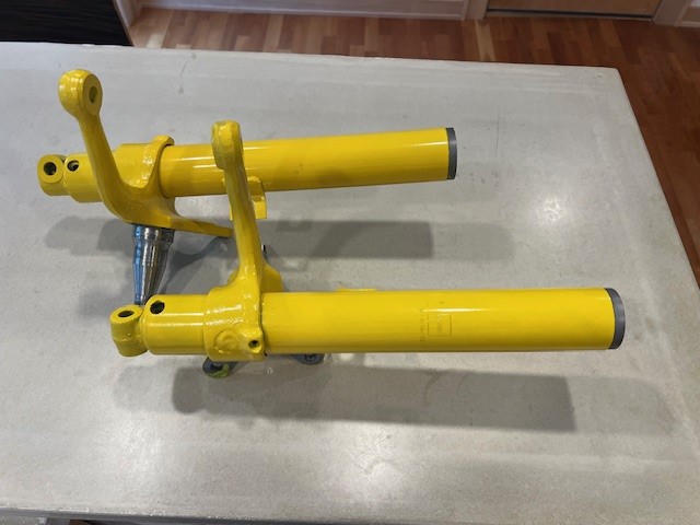

...media blasted and painted the struts. Jamie has installed new bushings for me. These are Bilstein struts which of course were originally green. As this is a restomod rather than a restoration, I figured I'd change to yellow so they'll match the shocks.

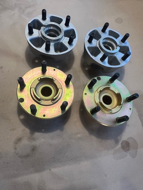

The rear hubs I had plated some time ago. This weekend I Alodined the front hubs in the hope it's provide some small amount of corrosion protection. I suspect it won't do much, but I already had the chems to do carburetor bodies... Then I pressed all the studs back in.
