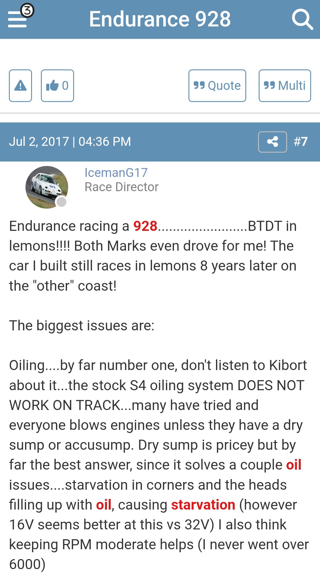

There is a thread on Rennlist about oil starvation on the 32v 928 engines used in competition.
I've watched a video there as well; a small camera was installed internally in the valve cover to record the oil accumulation during track use. Probably need to search the 928 forum at Renn for a look see.
Thanks for sharing with us.
Since ours will be a street driven vehicle and not an endurance race car, we will remember to keep the RPMs under 6k (IMG:style_emoticons/default/biggrin.gif) . (at least most of the time)

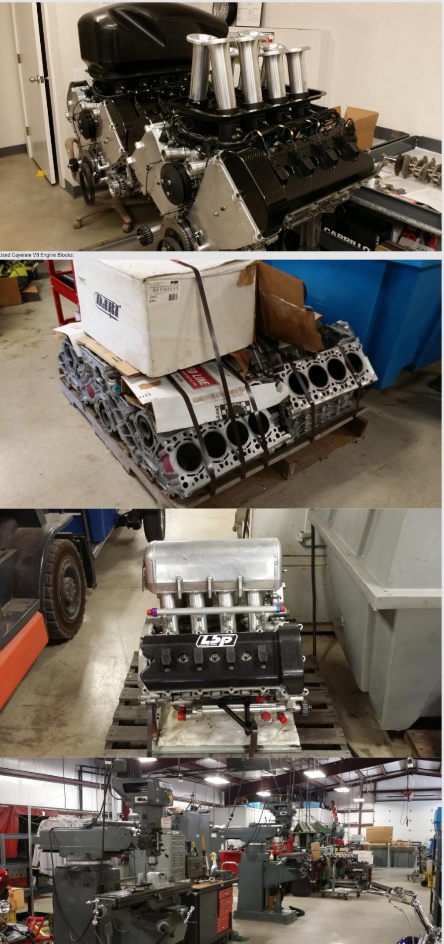

Note all of the 'Used Cayenne v8 aluminum blocks that LBP engine builders collected for their Action Express engine builds...these were headed out to be machined/ refitted with steel cylinder sleeves.
