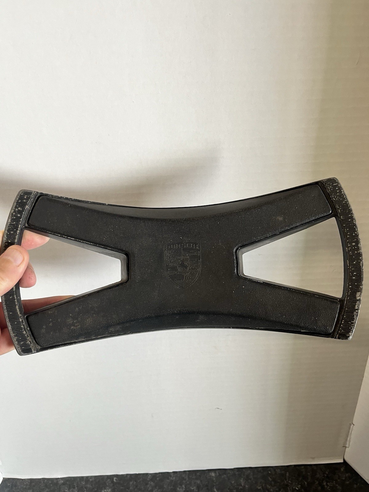

Any tricks to removing the rubber insert on the steering wheel "batwing"?

I have the batwing separated from the wheel, I am asking about removing the rubber from the batwing so that I can get it BS blasted and powder coated before reassembly.

Heat gun on the back side to melt the adhesive then should just push out.

QUOTE(Cvrguy @ Oct 15 2026, 02:01 PM) *
I would recommend using Winzer, SEM, or some other brand of trim paint as the powder coating may be too thick and you may lose the detail of the small horizontal ridges on the batwing, unless that doesn't bother you.
