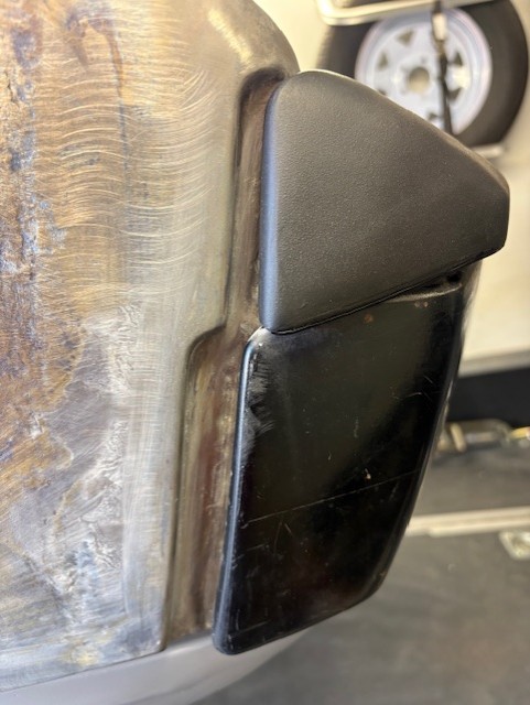

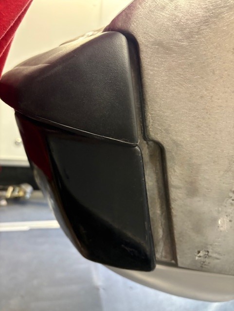

Here are some pics from my test fit this summer. The bumper has never been bent. This is the left side showing perfect fitment. Notice that the line of the bumper top is straight with the edge of the bumper and it fits nicely on the top of the bumper.
This is the right side, not fitting well. It does not seat correctly on the top of the bumper, which causes the line not to be straight and for the edge to stick out past the side of the bumper.

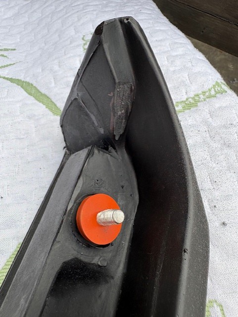

I thought maybe the material of the bumper top was causing interference so I relieved some of the rubber material as shown below, but it didn't help.
I'm not sure if I'll drill a hole or two and use the screw method or attempt the glue method. I'm going to have the bumper chromed so I'm leaning toward the screw method so I know it will fit properly before taking the bumper for chroming. But I'd rather not be drilling holes in the bumper.

just eyballing your two photos, it looks like on your problem side the metal portion is hanging out a bit from you other side
was there body damage on that side?

No body or bumper damage. I purchased this bumper top in, I think,
about 2020 but didn’t test fit it until this summer (was too busy doing rust repair on the chassis to test fit parts).
