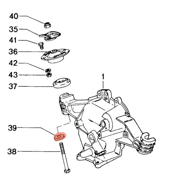

Is there anything special about the washers for the M12 transaxle mounting bolts (i.e., thicker, larger OD)? Part number: 914-375-239-00. #39 in parts catalog diagram.
They appear to be NLA and I can't find a description or photo of them. Washers I have are 13 ID and 27 OD. Normal thickness.
Thank you.

Yes, they are special thick washers. Pm Bruce Stone I'm sure he has a few hanging around. (IMG:style_emoticons/default/beerchug.gif)

QUOTE(Luke M @ Aug 14 2026, 06:30 PM) *
Sigh. Thanks. Good to know.
If anyone can share the spec that would be greatly appreciated. I'm going to install the engine tomorrow. I have a bag of thick washers I could potentially modify if I knew the correct thickness and OD.
