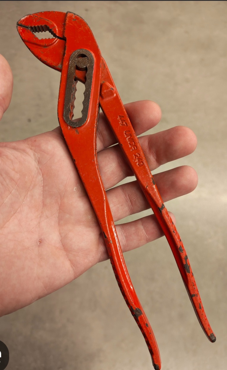

I use a pair of Knipex plyers. Thry have jaws shaped to fit the hex. They do not kick back from the pressurevof trying to open them. Everest makes a similar pair. I descovered them in Saab tool kits. They work on hev nuts from 10-27mm. I have removed rear shock nuts with them.
