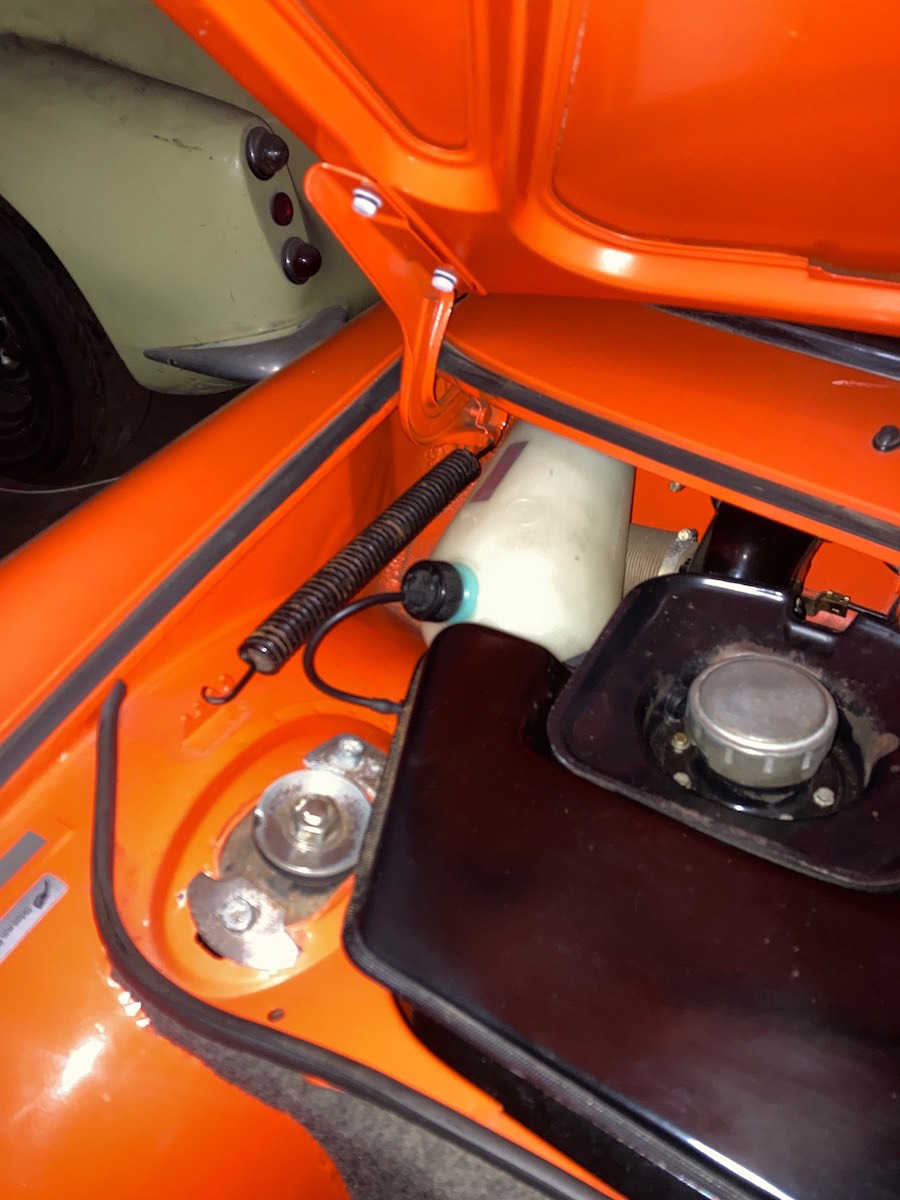

So on my windshield washer bottle the neck has a blue tint to it. All of my cars which are all 74 LE cars have a blue tint to the neck. I got a deduction at lake placid for having this blue tint. Was this an original feature to these cars or to later cars in general?

Years of dyed washer fluid use?
post Jul 27 2026, 11:45 AM
Posts: 9,525
It seems that they were made in colors. I have seen red and green also.

I don't know why they would dock you for a part that is replaced occasionally due to damage or wear. My other thought is what NARP74 stated that the neck may have been dyed from years of standard blue washer fluid use.

QUOTE(Cairo94507 @ Jul 27 2026, 01:37 PM) *
I have never seen one with a tint like that. (IMG:style_emoticons/default/beerchug.gif)
i have.
its in my garage.
to assist tony.
jan 25 1974 build - 1.8.
basically one of the last of the run of 1.8s from late oct 73 to end of jan 74 and right before the LEs start coming off the line in feb and they start building 2.0s again.
blue screw collar.
car is orig, unrestored. i am second owner since 1989. i have never changed the bottle and i am 99.9% sure the original owner i bought if off did not.
looks like that speaking through his a#rse judge owes you some points.
have no idea when they might have changed the bottles if they did change them during the production years of the 914, or whether its 74 only or whether its a batch of bottles, but i am no surprised. just one more of the myriad minutia of changes we discovered with 1.8 L jet research. a whole heap of changes come in with the 1.8s from late oct 73 to end of jan 74 and no one has ever worked it out until recentlu because folks were only interested in 2.0s and never took 1.8s seriously. the blue collars might be one of those changes. a quick way to find out would be to examine an early 74 2.0 from aug73 to end of oct 73 build period.

QUOTE(Cairo94507 @ Jul 27 2026, 12:37 PM) *
I have a blue one too.
