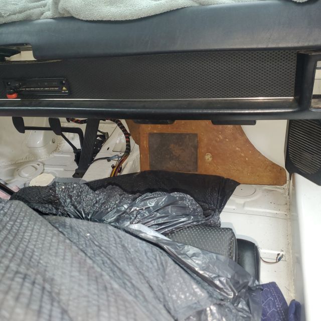

Working on an old water-cooled 914 project with an ac system. I (may)want to re do the whole thing properly. It came with a DPD or vpc condenser box (dont know which it is)I may need another evap case but dont want the under dash vent piece.
Questions...Is the old tube/fin evap worth using? If converted to 134 and a big modern condenser will it get cold enough to be as good as original? It Has a sd508 and barrier hose(i think?) already
The stock evap case(stripped down without vents) I am finding can actually fit behind the dash with just the lower motor/fan showing(radio and glove box was already deleted) Has anyone here done this? The open end of the box will need to be capped with 2 small duct hoses to each vent, at minimum I suppose. . Has any one done it this way?, the fit is so good I would think someone has done this to hide the unit (no radio or glove box though) (condensation/drainage may have stopped others from trying this with the box at this angle but I think it can be made to drain without splatter maybe)
So, I may want to get another bare evap box with usable evap coil in it if anyone has, (locked/burned motor would be fine (mine seems good) . or other parts I may need to try this. and any input would be appreciated, I think I have read most all of the posts on ac conversion here but I have not seen where anyone has put the evap box behind the dash.

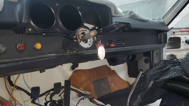

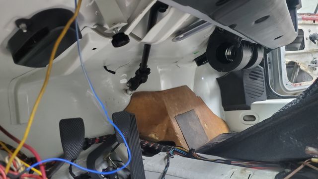

Great info! From a ac pro and 914/water owner? I did not know(or think about) the TXV being different for r12/134 ty! How do I get the right one??? Why do some have a second capillary line/ with a fitting?
I think I have my radiator/cooling/fan working enough(holds 170 deg at the t-stat outlet while idling, though the fan mostly runs continuous when sitting still) Driving it has been ok though some situations could get the temp up but not severe. Seems the water circulation speed is good through the system., that was something I was originally mostly concerned about, due to whole design but it seems very good with 160deg tstat and no air pocket( Although I am concerned about blocking it with a large condenser and adding heat to the radiator. I have not chosen a condenser yet(was missing from the car when I got it but everything else for a working ac was there and appeared to have been working for some time)I have some pics to ad here shortly.
These pics show how it will look if mounted. The shape of the firewall looks like it was made to fit in there, the indention is the width of the box, there is room on top for a manifold, the lines come out on the correct side and would be super short to pass to outside. The heater floor vent even fits between the fan/motor space. Hard to see here but the drain is on the front left and is actually angled back some in this position. I think a row of sponge and a slight tilt mount to the left may handle drainage without blowing water out? not sure What do yall think about this?
