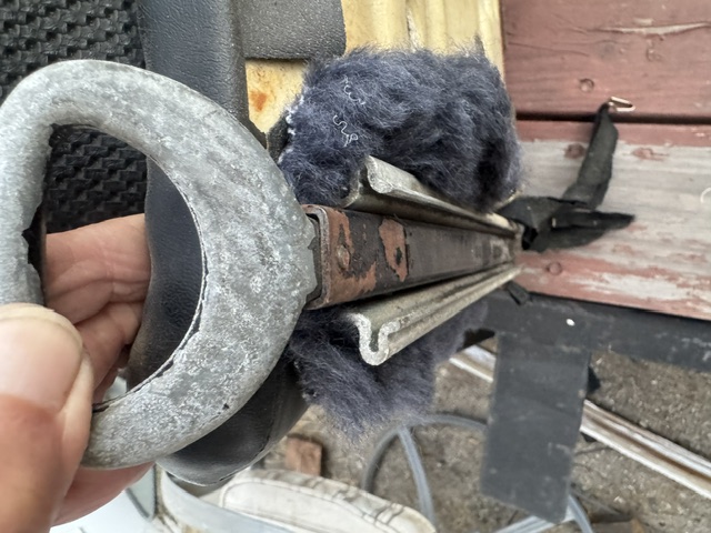

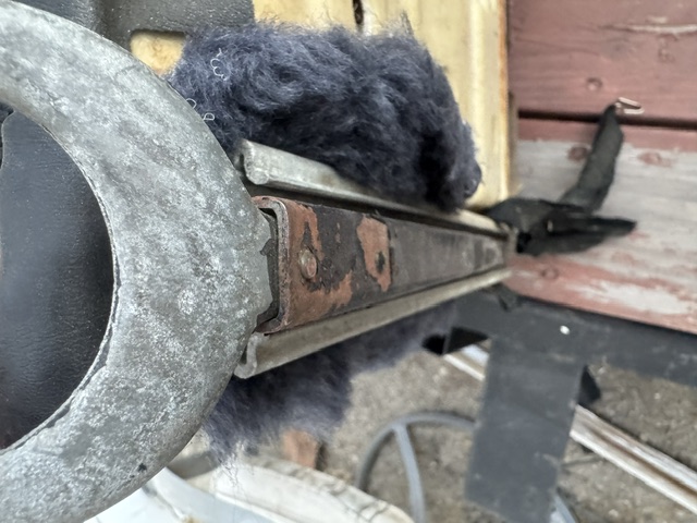

Is there a way to get the seat to move forward, since the handle is snapped off without removing the seat, at least till I can get another one put in?

reach underneath the seat, to the rail where the handle used to attach. push it upwards with your fingers and slide the seat back

I tried that both ways, and no go.

have you tried putting a screwdriver (a long one) in as a lever?

If it is mostly forward and will not come off the rails there is a limit spring that must be lifted to continue forward off the rails
If it is still rearward and will not move forward with the broken handle part lifted you've probably got a lot of rust/corrosion on the rails.
Keep the broken handle part lifted and get brutal on the back of the seat. (IMG:style_emoticons/default/sad.gif)

I tried with the screwdriver and lifting it, and tried grabbing the end with a small vise grip, but no go either.

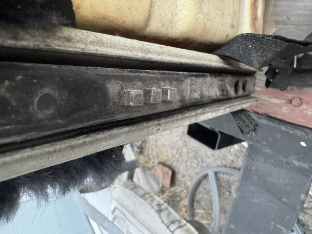

Those three pins lock into the slider.
So this needs to raise up. I would wedge a screw driver to hold that up
so it keeps the pins off of the slider. Then like said above, get violent down low in the back. It may take that to get it moving. WD 40 might help.
