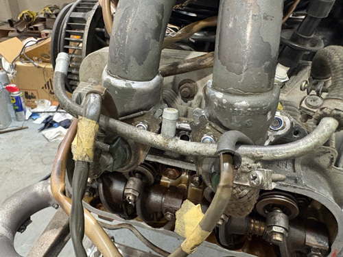

I’m working on the vacuum hoses and have a few questions.
1. **Cold Start Valve:** I believe the larger port connects to the Auxiliary Air Regulator (AAR). Where does the smaller port connect?
2. I’m missing the EGR valve, all of the metal vacuum lines, and the deceleration valve. Does that matter? Can I start the engine without them?
3. What is the middle port on the fuel rail for? Where should it be connected?

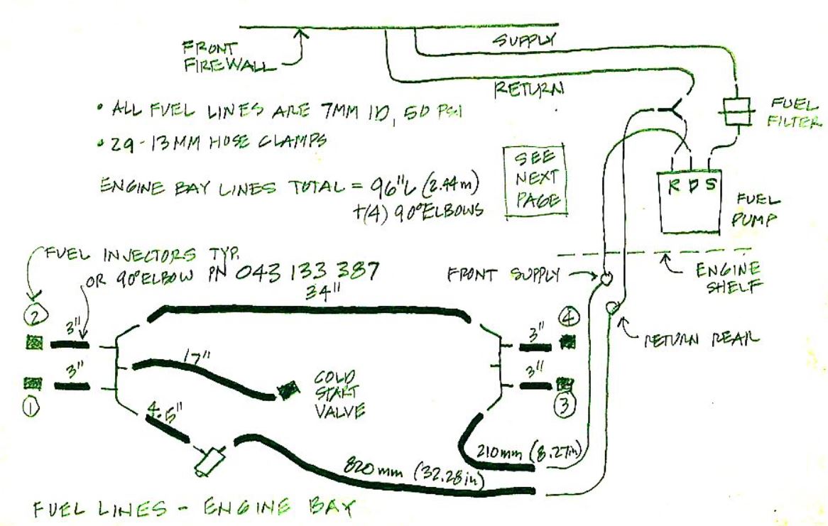

Your answer is in your post. (IMG:style_emoticons/default/smile.gif)
The cold start valve is an extra injector. It connects to that middle port you are showing in your second picture.
Here is an image taken from @JeffBowlsby website (link also attached).
https://bowlsby.net/914/Classic/TechNotebook.htm

I have a middle port on each fuel rail. Should I use a T-fitting to connect them together?
I'm not sure what the purpose of these ports is. Are they for vacuum or pressure relief?
Also, what about my second question? Do I need the EGR valve and the metal lines, or can I run the engine without them?

Sorry, I did not read you answer carefully.
Actually is the fuel supply line to the cold start valve.
I guest I can just plug the other one.
