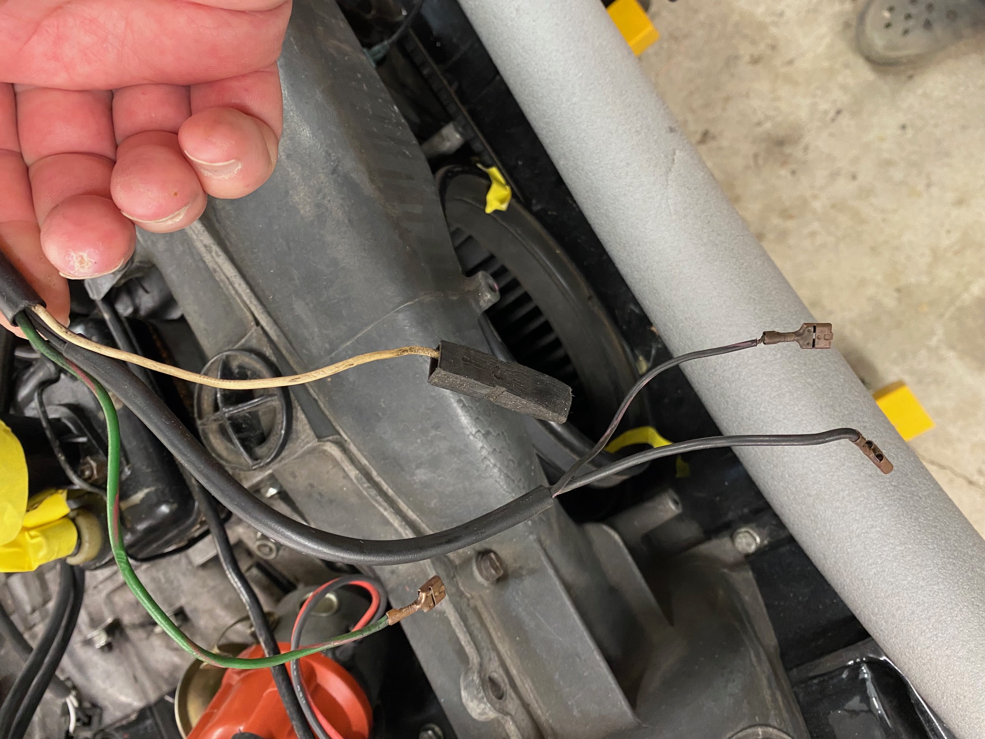

Swapping out the 2.0 l engine in my 1971 for another 2.0 l ...Has lower miles (35k) and documented build.
Both engines carbed
I see the engine harness in a bit different at the end that connects to fan blower.
Pic 1 is the from the existing engine that had the fan blower mounted. Has the two wire connector to plug into the fan plug...

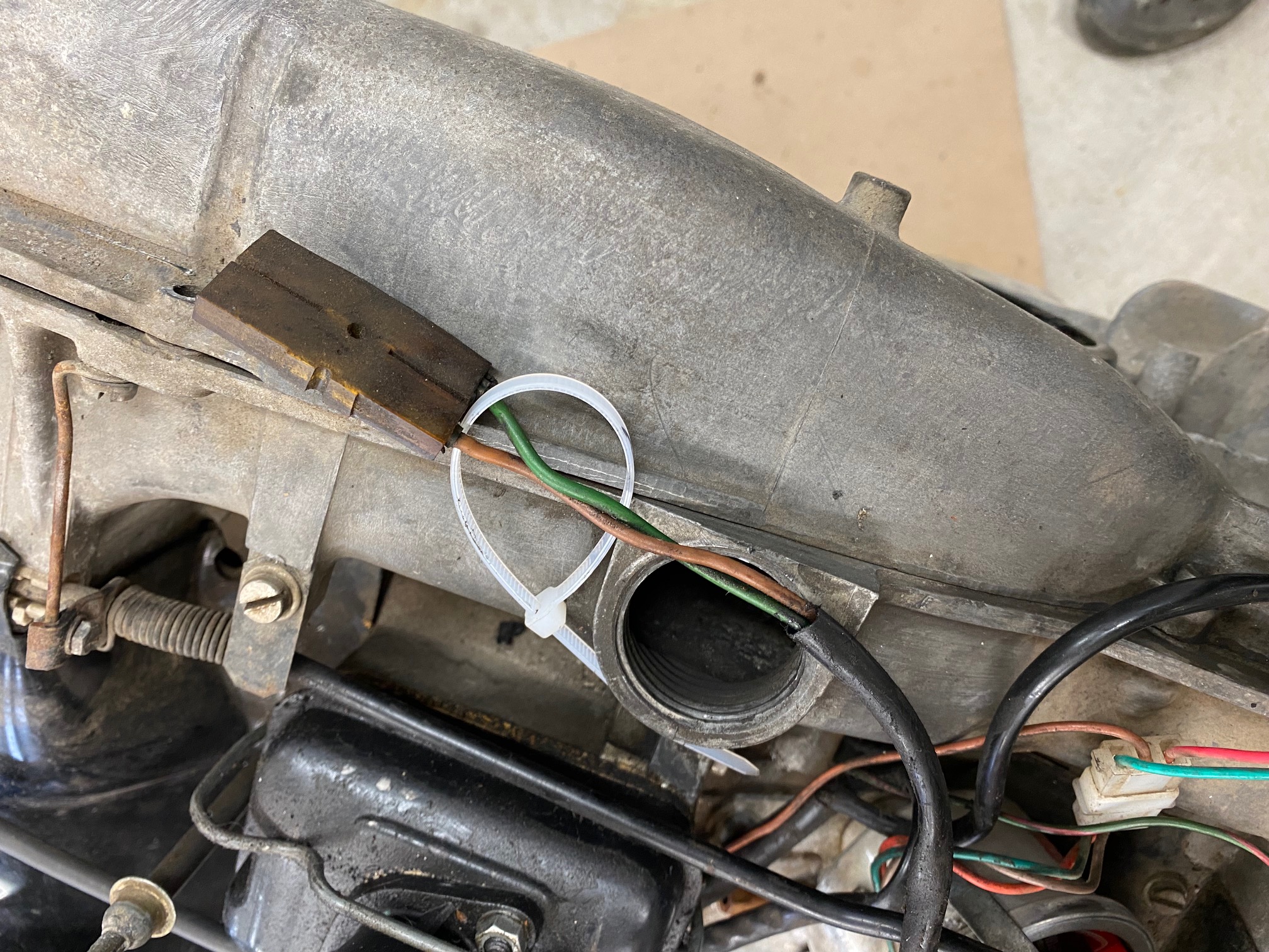

Pic 2 is from the replacement engine. I only see a white wire that is spare. Could this be the fan power and then I use a common ground? In understand what the other wires in the pic connect to.
Thanks the help going forward

Use the ignition harness in Pic 1 on your 1971 car, its correct for your set-up, with the fan mounted to the engine. The Pic 2 harness is for 1973-76 cars with the heater fan mounted to a stand on chassis.
