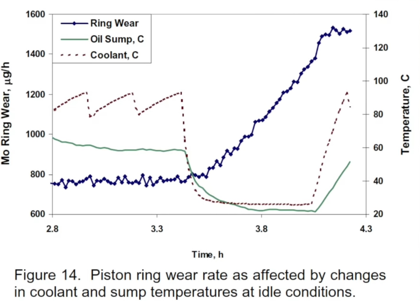

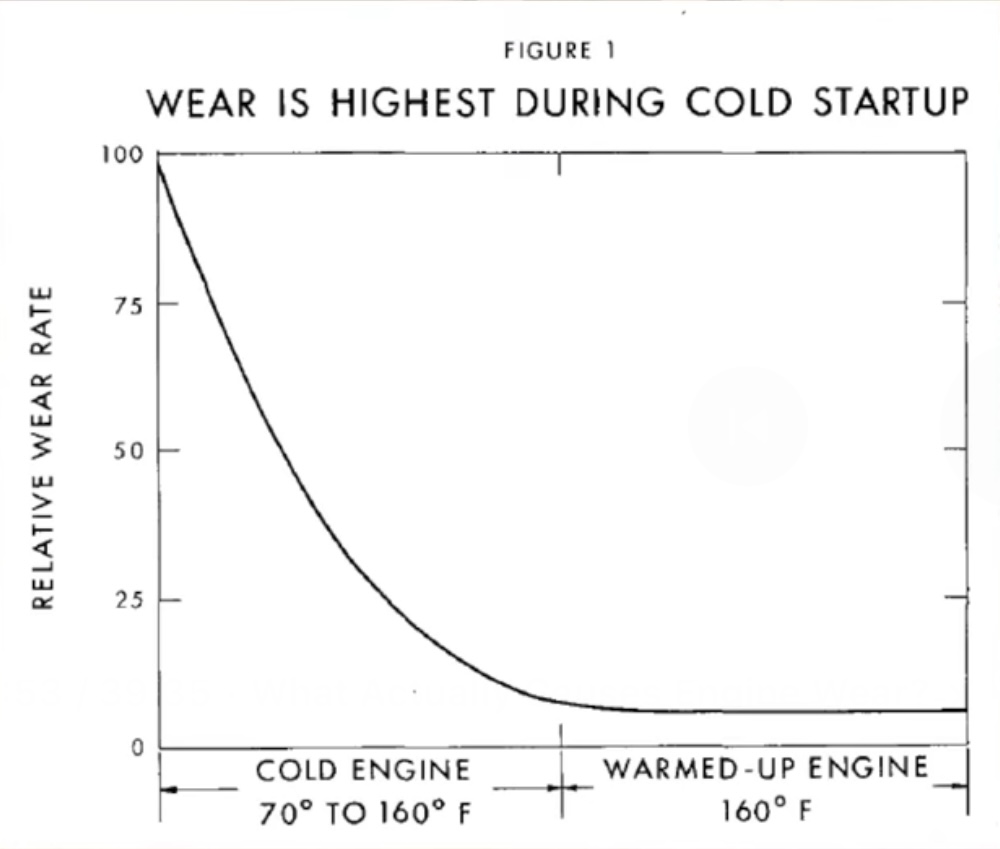

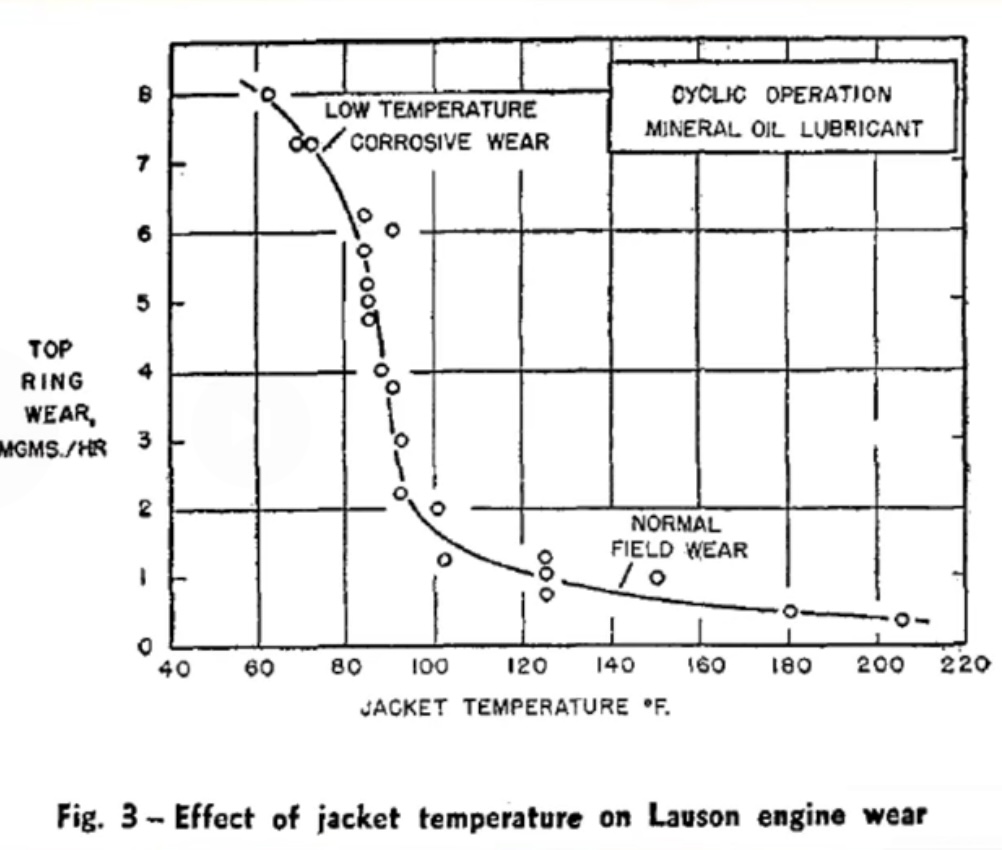

It seems to me that you guys haven’t yet come to terms with how real and how apparent wear is (when measured) as it relates to temperature. In these charts keep in mind this is cylinder temp, not cylinder head temp.
So let’s put up a couple charts on how engine temp affects wear and how much wear occurs when the engine temp is transitioning.
This 3rd chart is a GM study that shows ring wear on an already running engine accelerate as the coolant temp and oil sump temperate on a dyno is reduced about 1/2 way through the test. Toward the very end of the test the coolant and sump temperate is again raised and the ring wear levels off / stabilizes.
Just to reiterate, I’m not saying the wear is instantaneously going to destroy your engine.
However this shadetree mindset that “I haven’t seen” any reduced life is a fallacy. Without a baseline engine that was operated properly for its life to compare against your engine , you’ll never know exactly how much your particular engine life was shortened. As long as you accept that, do what you want. However - advising others to take on that accelerated wear without informing them about the wear trade off isn’t fair to those that might not know any better.

QUOTE(Superhawk996 @ Jun 8 2026, 09:15 AM) *
QUOTE(JamesM @ Jun 8 2026, 01:41 AM) *
the 914 thermostat is a lot more impacted by ambient temperature possibly due to the 914 thermostats placement more or less in ambient air. Yes they modulate temperature but the range in which this modulation occurs only seems to exist at colder ambient temps.
Because the bellows is largely in the ambient air steam
But, it's not actually supposed to be in the ambient air stream. On ACVW's it's protected from the ambient air stream by the sled tins, and on 914's it's protected from the ambient air stream by the lower engine tin (the angular looking one with the half-cylindrical indent for the shift rod). However since these lower tins are missing from most 914's, the thermostat ends up in ambient air where it really was never meant to be.
I still 100% agree that all of these parts need to be there (just got in this same discussion recently on the samba because alot of people don't understand how critical a fast engine warm up is), but if you want the system working exactly as it should, that lower engine tin also needs to be in place.
JamesM
post Jun 8 2026, 08:50 AM
Posts: 2,242
Joined: 6-April 06
From: Kearns, UT
Member No.: 5,834
QUOTE(Superhawk996 @ Jun 8 2026, 05:27 AM) *
It seems to me that you guys haven’t yet come to terms with how real and how apparent wear is as it relates to temperature. In these charts keep in mind this is cylinder temp, not cylinder head temp.
I'm 100% on board with the wear data, this is the reason I had guys replacing thermostats almost constantly while I was at PMB. Id say roughly one in three was coming in with a broken one.
The data points I am adding though (that can also be applied to these charts) is that a "cold start" here at least during the majority of the driving season is generally near if not over 100F+ and that the time to get to 160+ with or without a working thermostat isnt really much different. Assuming at least you are not holding 3k+ rpm immediately after startup. There just isnt enough cooling capacity at idle fan speeds in 100deg ambient (with the asphalt sitting 140-160) to meaningfully slow that process. Air-cooled motors don't have to heat a volume of coolant like a water cooled motor does so this process happens faster and they are not fighting the extra thermal mass due to a broken thermostat in the way water cooled motors do.
The regulation of the cooling system on Type 4s is not incredibly accurate to begin with given that there is no thermostat impacted by oil temperature. The only thing regulating oil flow though the cooler is a pressure bypass and the thermostat controlling air flow through the cooler is on the opposite side of the motor from that cooler only getting the airflow off of the 1-2 cylinders. The flaps/thermostat help the system get up to temp quicker in cold weather but the flaps are generally going to be in the full hot position and blowing air over the oil cooler before the oil is up to temp anyways given how much faster the heads and cylinders heat up vs the oil.
The wear data is valid, but I don't think even in the best case scenario the type 4s cooling system is fully optimized to take the best advantage of that.
