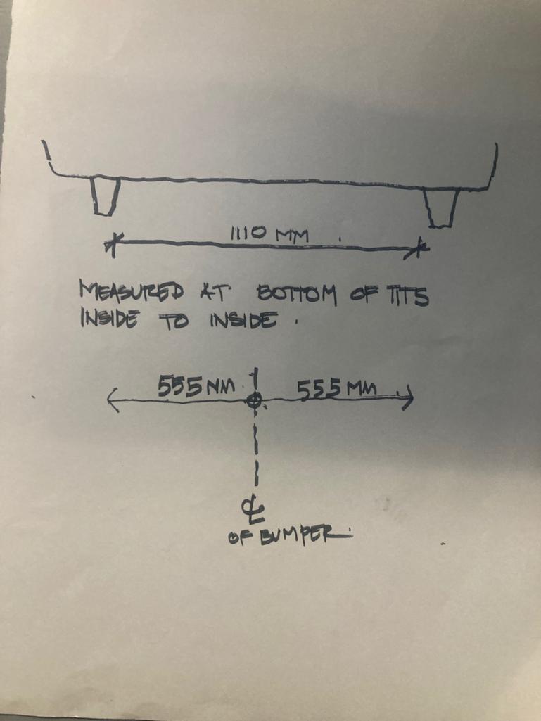

Can someone give me the measurements/location on the rear bumper to add the pads/tits. Also correct hole size, bolts are 8M. Thx!

post Jun 3 2026, 05:45 PM
Posts: 5,532
i can go down and measure mine a bit later.
but bumper is on car so won't be able to give you hole diams.
but can certainly get you set out dimensions to out side tit dimensions.
if you have the tits you can work out where the bolts are located using those.
post Jun 3 2026, 06:52 PM
Posts: 5,532
metric dims down here. shown in plan.
tits mount up hard to u/s of rubber top to give you set down location vertically.
