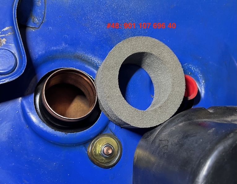

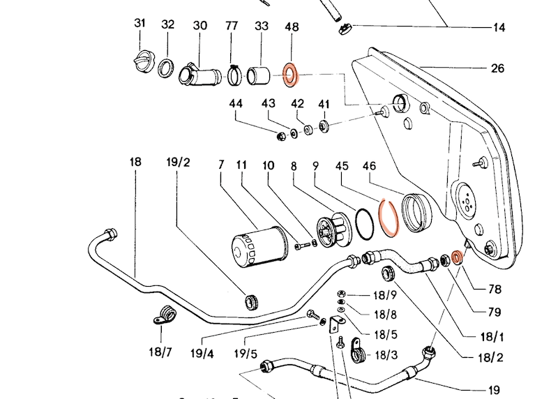

I'm wrestling with some final bits of the 914-6 oil tank connections. Can anyone confirm these parts and / or share photos of them installed?
  • 45: 901-107-281-00, circlip (oil filter console) - I took this apart and don't recall there being a circlip needed. Does it go around #46?
  • 48: 901-107-696-40, Sealing ring for Filler neck - Seem impossibly thick to allow the filler neck to connect with the tank neck. I tried smushing it down in the gap between the body, but it just didn't seem right. See photo below for new part I received.
  • 78: 901-107-679-10, Sealing ring (lower side hose) - I can't find this for sale anywhere, nor know do I know what it looks like or specs to find a suitable replacement.
(IMG:style_emoticons/default/confused24.gif)
Thanks for any assistance.
