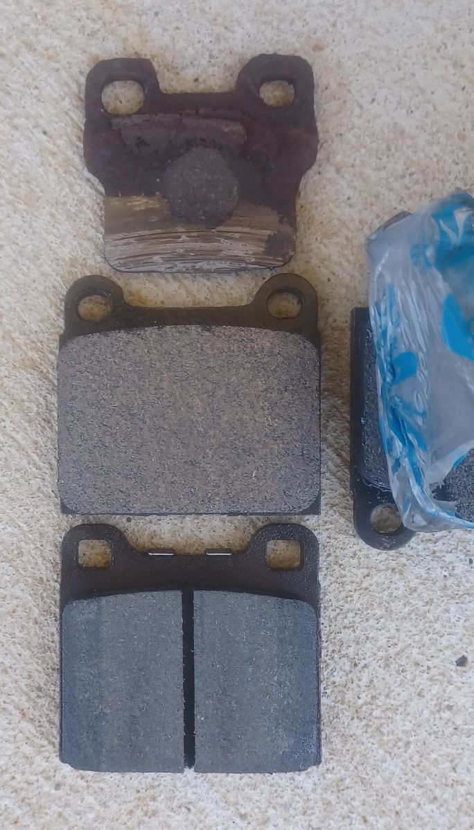

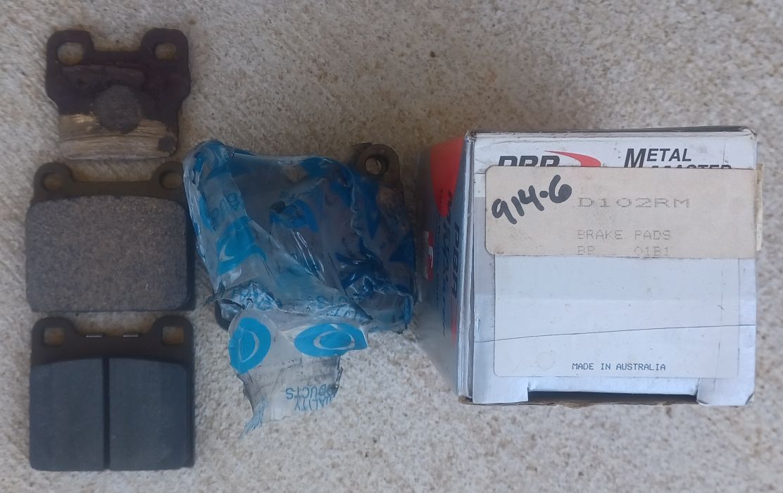

Calling "old timers", I'm now befuddled. (IMG:style_emoticons/default/wacko.gif)
The "wrong" pads that O'Reilly's had were the exact-ish same ones that Perry Kiehl offered me from his stash.
Are my calipers some weirdo PN or has superseded pad PN's led to a pad that is too big for 914's?
My existing pad (or what's left of it) is on top, Perry's is the middle one and the O'Reilly's one is on the bottom.

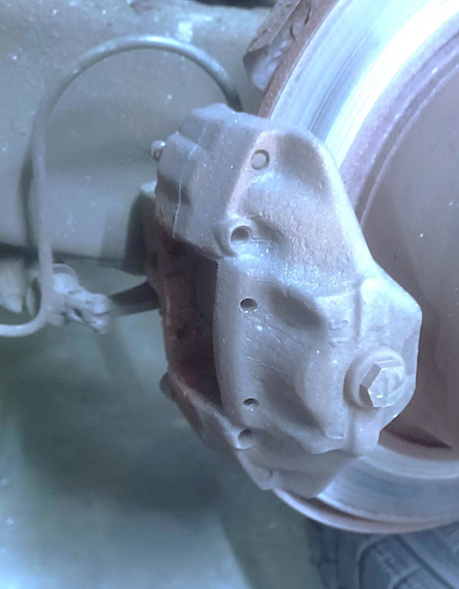

A pic of my rear caliper.
Ninja
post May 15 2026, 08:17 PM
Posts: 250
Joined: 25-September 25
From: Granbury Texas
Member No.: 29,004
Those top pads look weird!
If the left side are still decent you might have a caliper issue.
The square cut O-rings lose their ability to retract the pistons when they get old.
When new/good they slightly retract the piston when fluid pressure is released.
It's not much, .002"-.003" but if they are rock hard, they leave the pads solidly against the rotor causing excessive wear/brake dragging.
It's a bit like "riding the brakes".
Front calipers are easy to rebuild, rears are NOT!
The biggest issue with my 75 when I purchased it was one of the rear calipers did exactly this and trashed both the pads and the rotor.

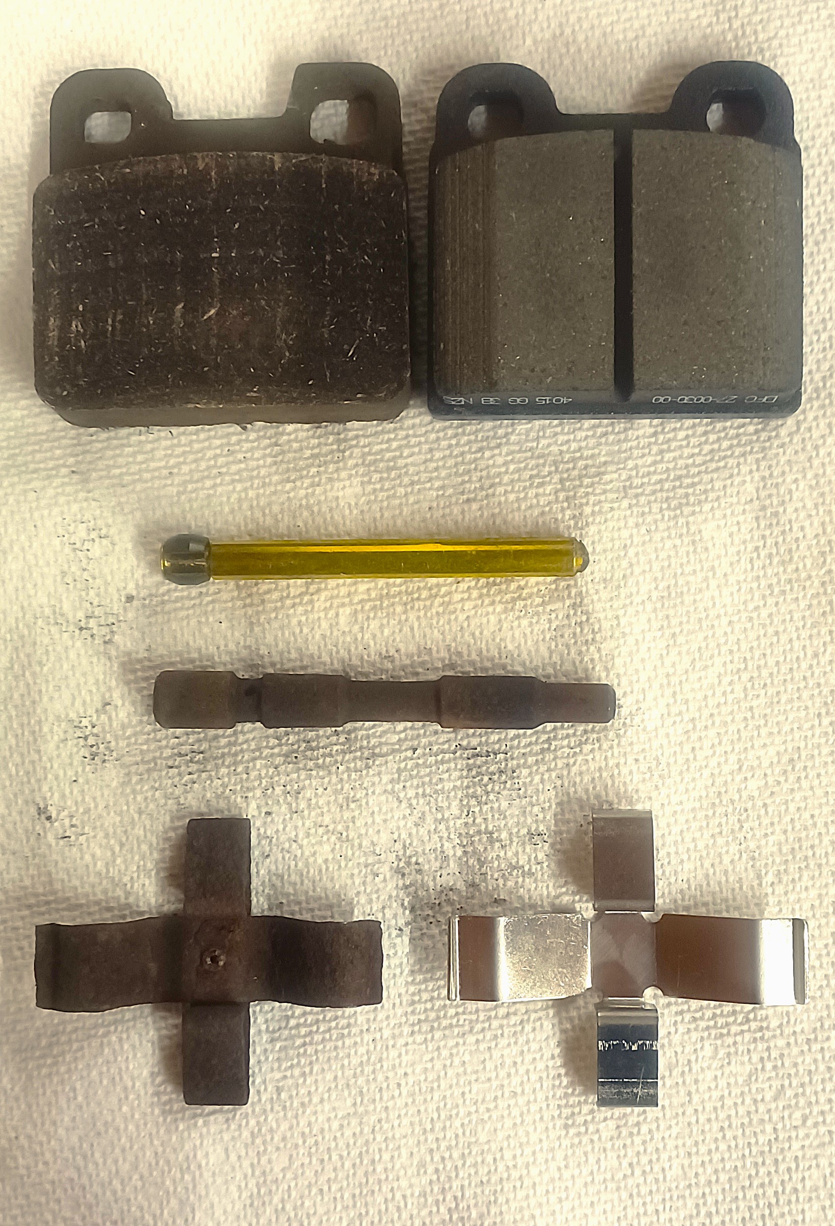

Here's an update. Received the pads and hardware from Rockauto for VW Fastback and Karmann Ghia front pad kit.
The kit part # 4000-0030-02 consists of :
pads, part # 4000-0030-00
and
hardware kit, part # 340-16002
They're the right size!! (IMG:style_emoticons/default/piratenanner.gif)
The retaining spring / clips look like they're passable / will work.
I am having a bit of a "3 sea shells" moment with the pins / rods. They look too short, too thin in OD in spots and how does that round clip springy thingy on the end work?
