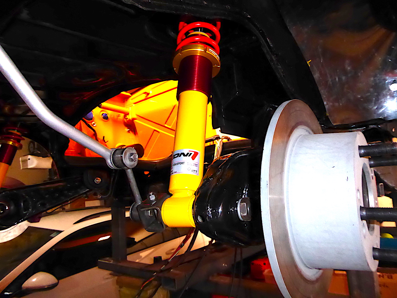

Ground Control, any spring rate you want. I'm running 150 lb in the rear with a 2,2 six. Attached Image
