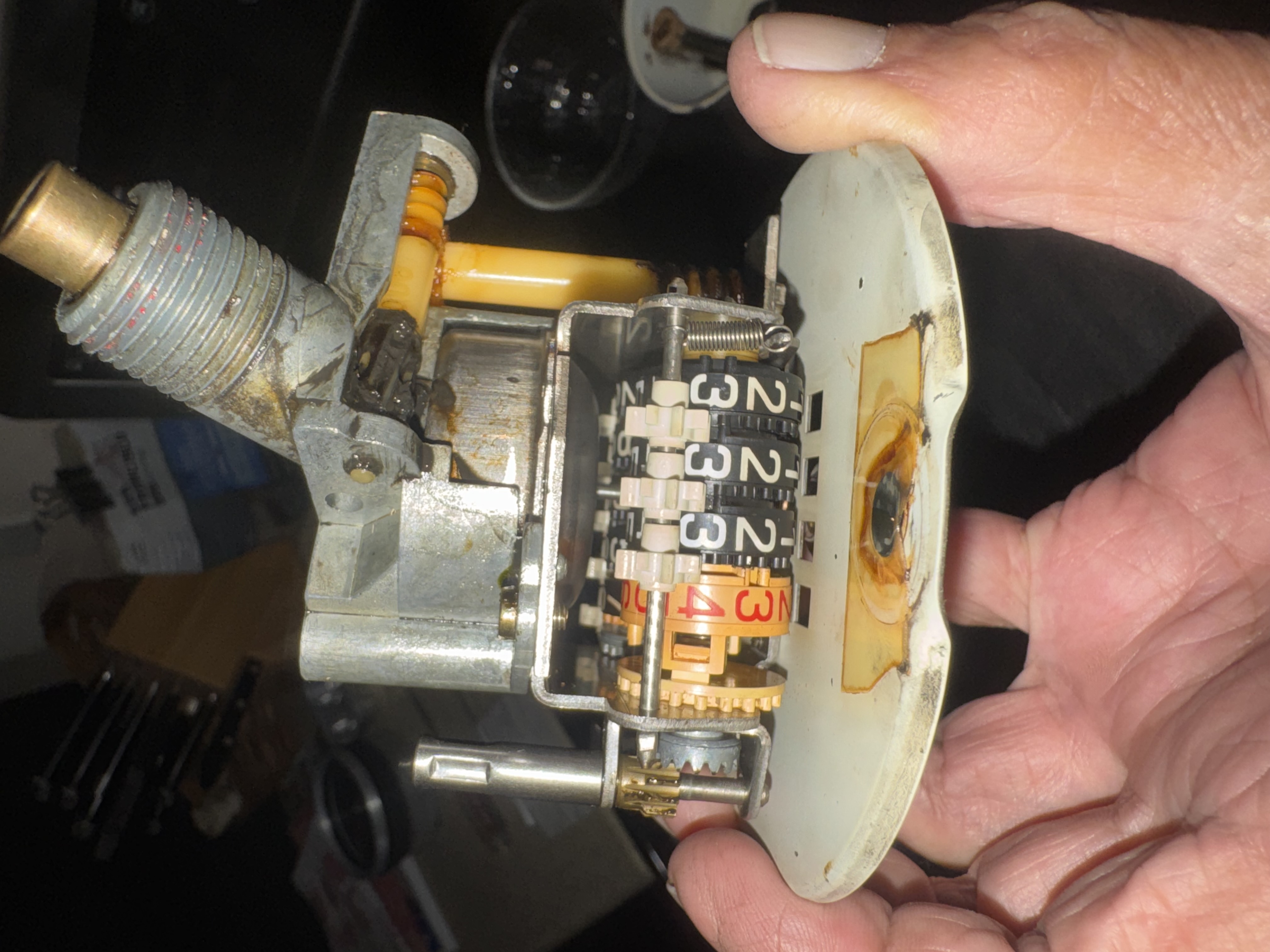

This is what it looks like inside. I could not afford to send it off, if you can that is what I would suggest also. But there are parts available.
