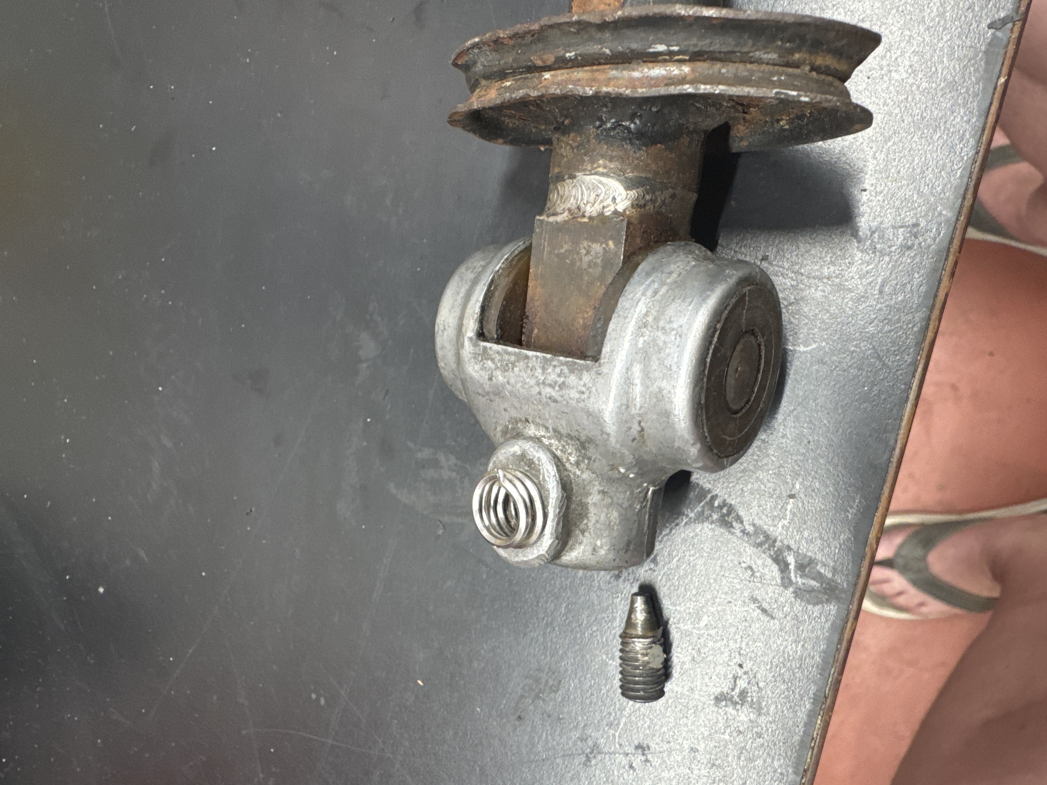

I’ve got a 1973 914 2.0 that I’m bringing back after about 10 years off the road. I’ve gone through the fuel system and brakes, got it running, and took it out for a short test drive.
Issue: I could never find 4th or 5th gear.
I started working through the shift linkage by checking bushings and alignment and found that the rear shift rod retaining screw appears to have been previously repaired with a Helicoil. Unfortunately, that insert is now backing out, so the connection isn’t solid.
Before I start tearing deeper into it, I’m trying to figure out the best path forward:
* Is it worth redoing the Helicoil, or should I go another route?
* Any preferred repair methods for this specific location that hold up long-term?
Appreciate any advice or lessons learned

New couplers are pretty expensive, so you could put a "wanted to buy" add here for a used one?
Not sure if it's worth trying to weld it up and cut new threads, unless you have the equipment and skill. Good luck. (IMG:style_emoticons/default/biggrin.gif)
