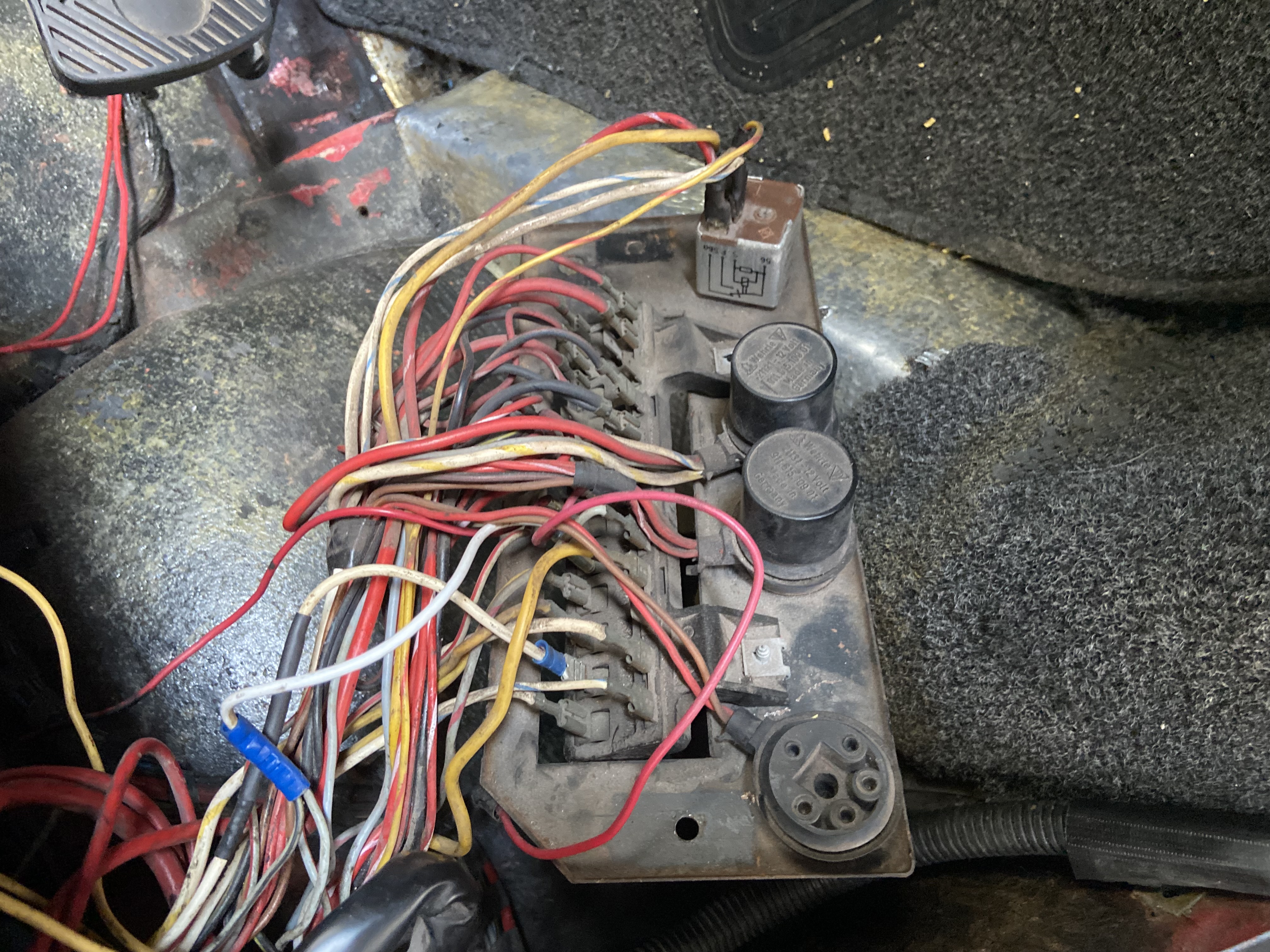

Hello Everyone,
Well, I'm finally retired and am able to work on my 914. I started a post about my turn signals and have time to do it. I currently have this board. Symptoms: Turn signals will turn on solid if the turn signal stalk is up or down on the column. Also tested and have 12 DC at each corner front and rear turn signals.... Just noticed my Hazard lights do not work. Do you feel the square/silver relay in this pic would control both turn and hazard lights? If so, is there a replacement? |

Mike1981 Thanks
Please help me understand where the turn s... May 2 2026, 11:32 AM

Please help me understand where the turn ... May 2 2026, 12:57 PM
Spoke Doesn't look like your flasher relay is on you... May 2 2026, 01:14 PM
Mike1981 Thanks for these suggestions.
I believe my board i... May 2 2026, 02:18 PM![]() ![]() |
