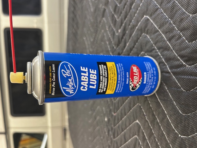

I remedied a bouncing speedo with a cable lubricant.
Disconnected the cable at the gauge and put the lubricant into the cable,
As I remember it took a fair amount and was difficult holding the cable in a suitable position; now, the gauge is super smooth above 15 mph
