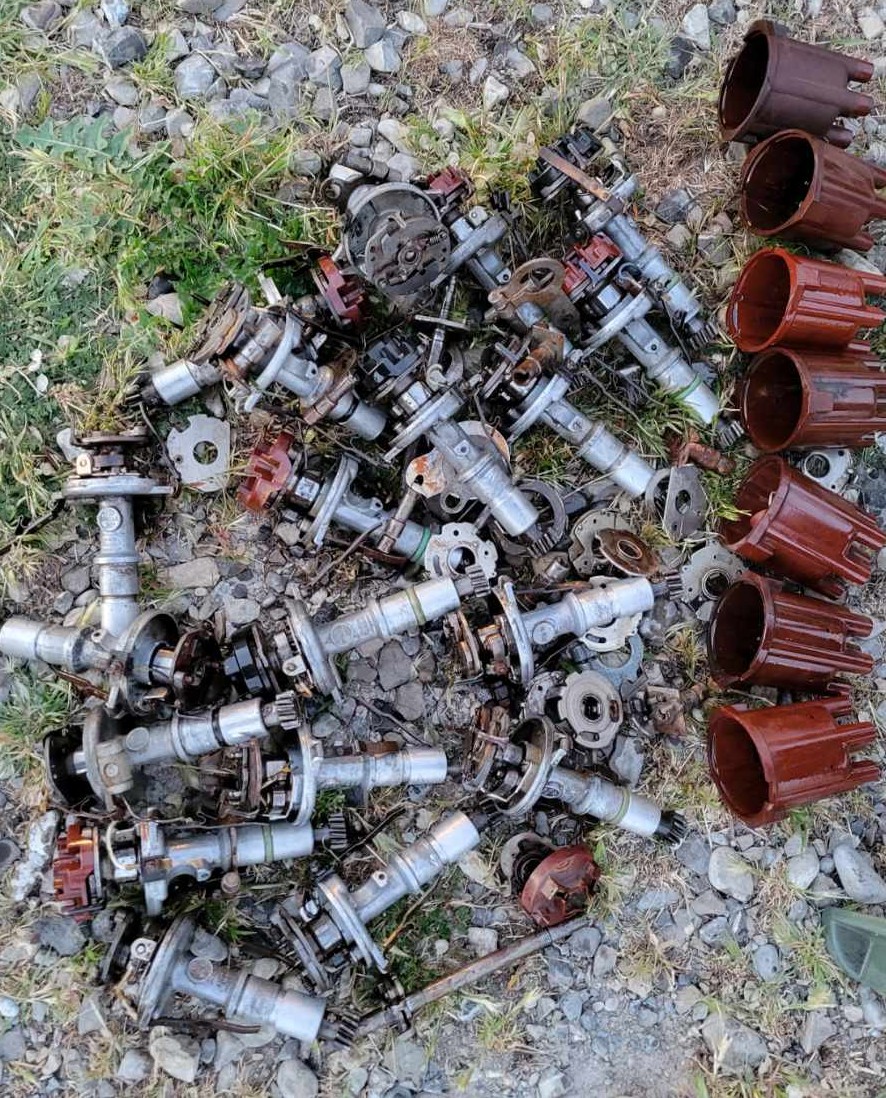

looks like someone has cornered the market for the 914-4 distros! What a collection, and why are they on the ground - perhaps hallowed ground?
Wait, those are all 6's????!!!!

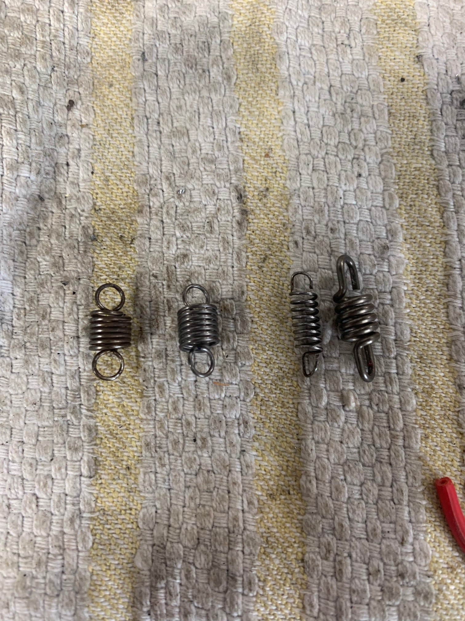

I decided to check the distro,
here are the old and new springs
When I did the rebuild (simplest mechanical device ever) there are just a few parts. The weights are good and the springs seemed OK, HOWEVER.......
The springs I received from the rebuild kit (on the right in the picture) were different - I called them and verified that I received the correct springs........hhhmmm
Yesterday I put in the old springs (on the left, in very good shape) and they held the weights at rest under tension where the new springs from the kit had a bit of slack in the weights......double HHHhhhhmmmm
Put the distro back in the hole, buttoned it up turned the key AND!
The car started instantly, and settled at an idle WHILE cold. This would not happen prior.
Reset the timing at idle and the RPMs rose to 2K. I backed off the idles screws - slowly and watched the car settle at 980ish. Wow.
Drove the car and the power curve is much better, less spitting THOUGH i will need to go through the least-lean method again, running rich but not too rich,
Also, on a down shift too much fuel - had a BIG-BANG in the muffler.....YOW
Moral of the story - vendors have new employees who do things wrong and do not realize it. Check the product if it looks wrong.
I believe all of my carb chasing was a product of this situation where the timing floated a few degrees at low RPMS,,,,,,,,
