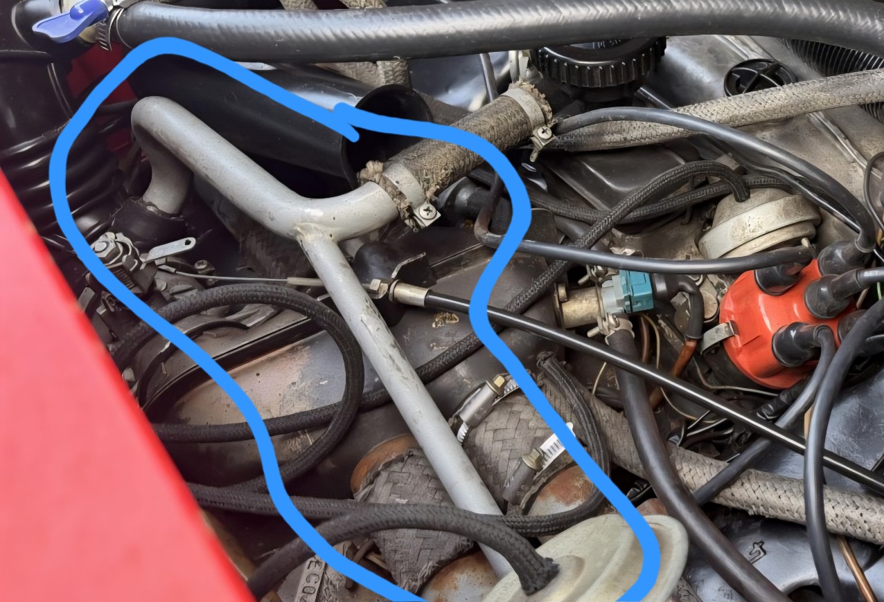

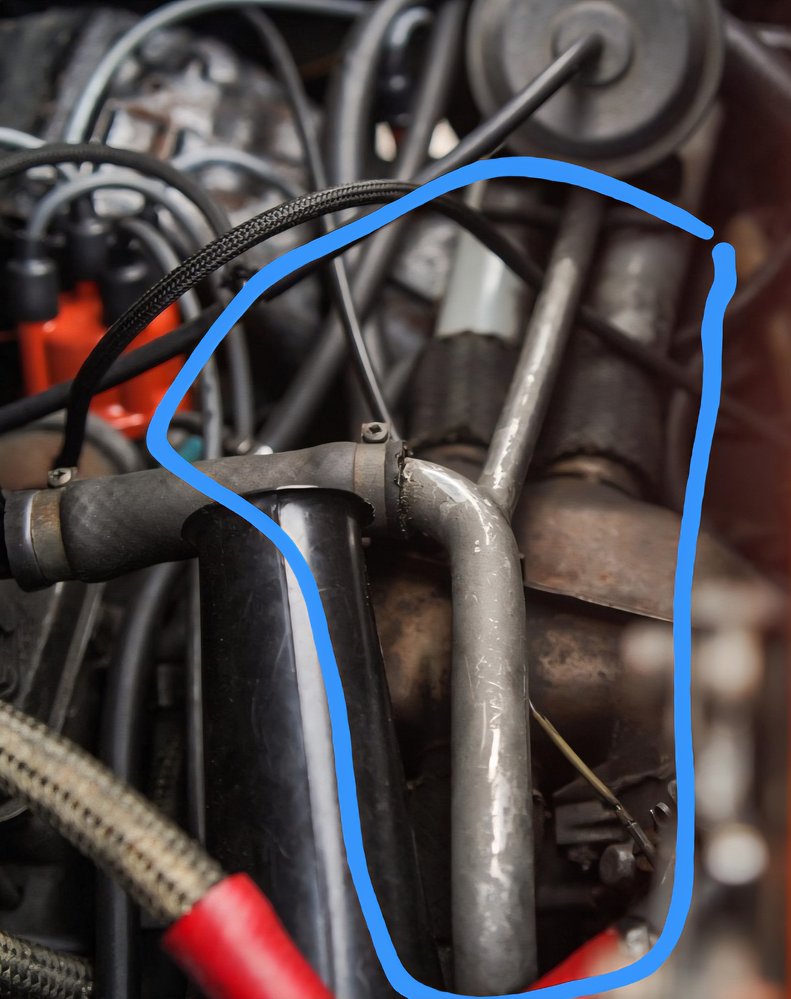

What is this metal tube? I assume its part of the EGR / emissions system for a 1.8 and it allows gasses / vapors to flow back into the intake system. On my 1975 1.8 I do not have this metal tube, my car has this replicated via a series of rubber hoses and plastic connectors. Im wondering if a previous owner lost ir and recreated this part with the hoses/plastic connectors?
My car is a 1975, but it is not a smog system car. Should my car have this tube?
Thank you,
Ted

The tube is part of the 1.8L EGR system. The 74 and 75 tubes are different.
49 state 75 1.8L cars did not have an EGR system, only the CA market cars.
https://bowlsby.net/914/Classic/Emissions.htm
https://bowlsby.net/914/Classic/zMan_1975_S...iningManual.pdf

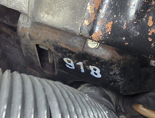

@TRP i have your L jet data filed away in my L Jet files.
as i recall your car no longer had the emissions sticker on the fan casting to identify the engine and compliance.
but it did have the 918 paint stamp on the engine tin.
from my files.
which means its a 49 state USEPA only certified. also that it originally was base model engine (not appearance group) as 918 stamped engines lacked the temp sensor in the sump plate and associated wiring running up behind the fan casting.
the hose diagram is here.
http://www.914world.com/bbs2/index.php?sho...7407&st=280
refer engine family 15 hose diagram.
cars with an EGR were california only as jeff bowlsby notes.
also had a CAT and the throttle body was a twin port TB. the EGR was activated by the vacuum port above the throttle plate in the TB and the EGR connected to the PCV hose via the metal plumbing piece you are asking about.
you should not have any of that.
also indicates your car was originally sold outside of california when delivered new.

QUOTE(wonkipop @ Mar 28 2026, 07:30 PM) *
as per Jeff.
from my files.
EDIT
ps - it does have a smog system. (IMG:style_emoticons/default/biggrin.gif) (IMG:style_emoticons/default/biggrin.gif) its called the distributor and retarded timing.
all the L jets 74 and 75 had variations on the theme of retarded timing depending on the jurisdiction - USEPA or CARB. (IMG:style_emoticons/default/biggrin.gif) its just that the 75 californian models had to conform to the highest levels of a progressive 2 tiered regulation structure. basically your car in stock form is pretty much identical to the set up on the 74 californian L jets.
