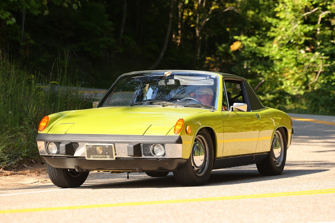

It kind of depends on how low your car is. I have 15x6 deep Fuchs on my Six; I am about 1.25" lower than stock ride height (+-). I am running 195x65x15 tires on my car and I think they look just right. I could probably squeeze a 205 in there but do not want to chance any paint damage. (Sorry for the bad lighting in the picture)

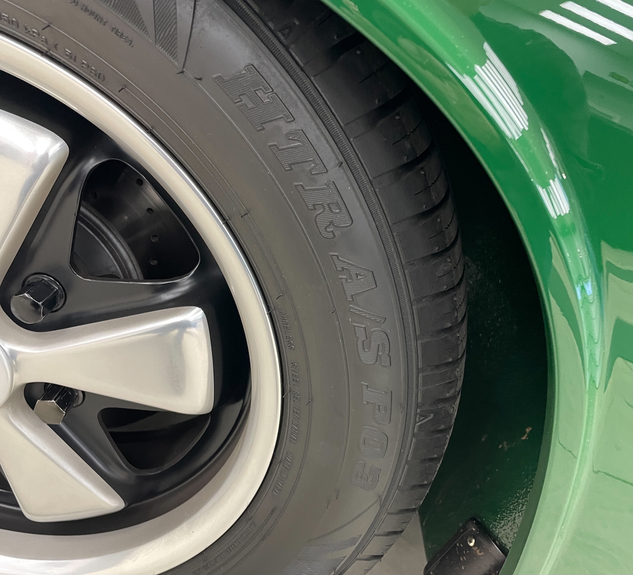

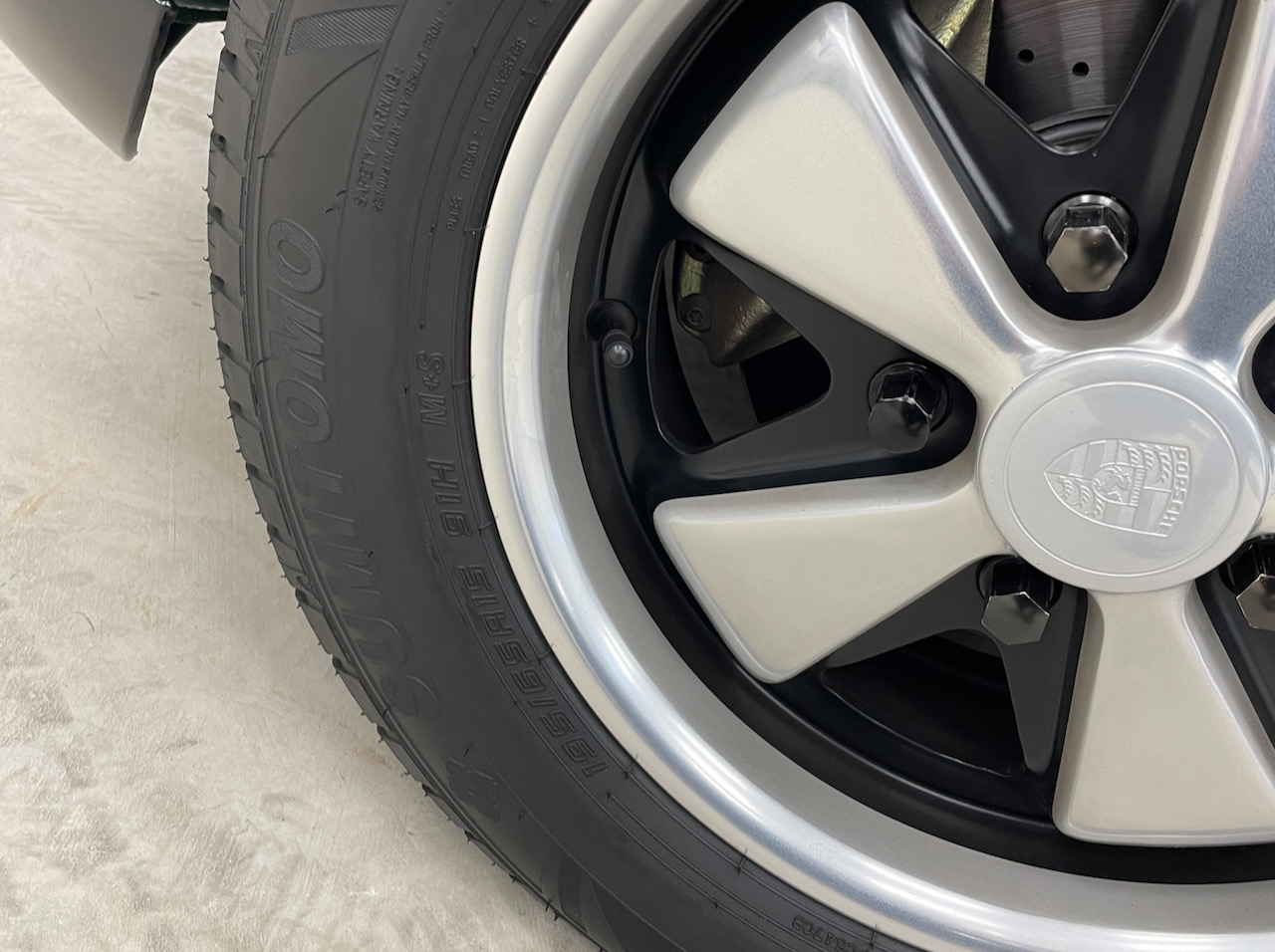

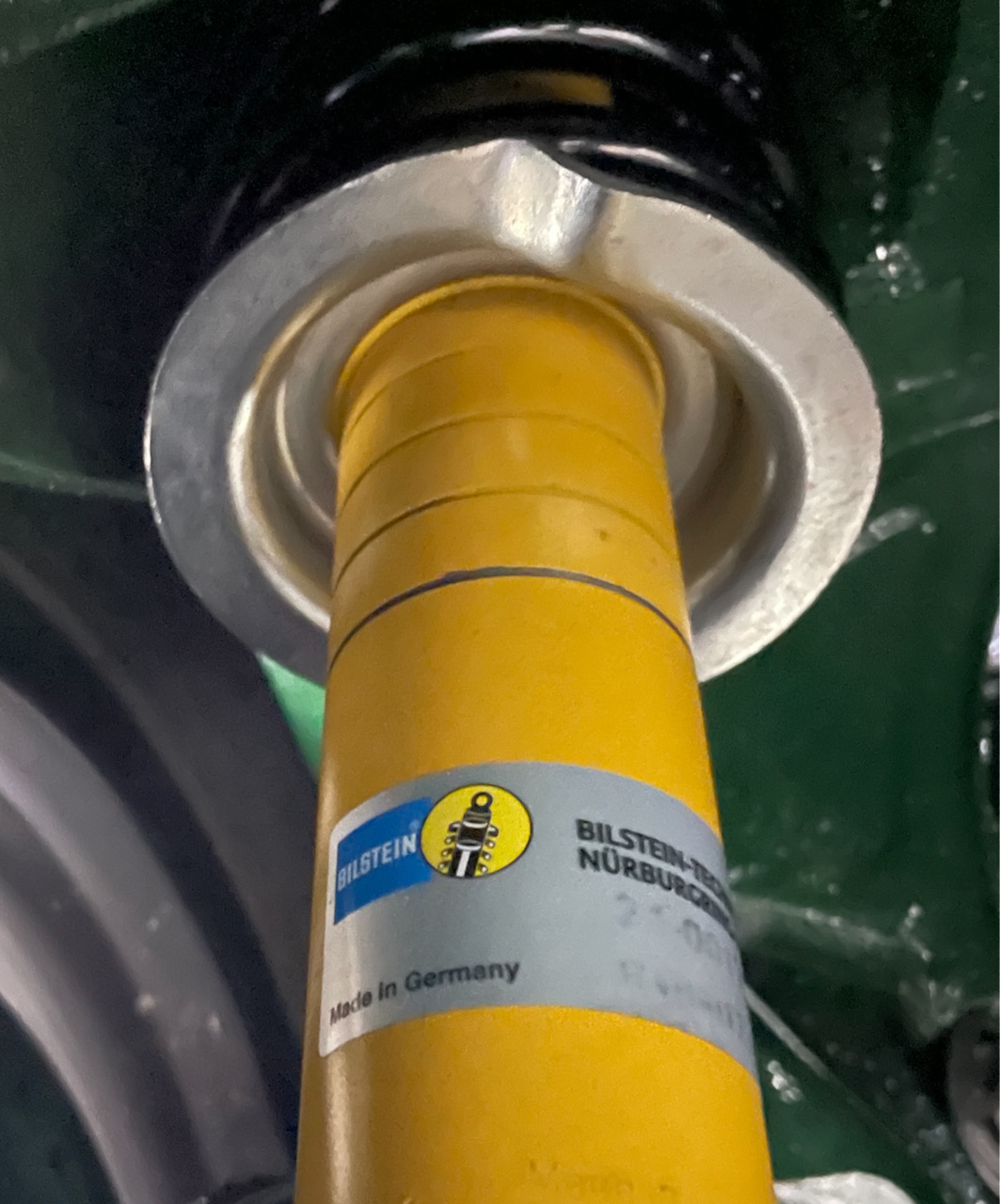

@TRP - I was asked what tires I am running and what position the clips are on for the Bilstein shocks; here are a few pictures. The Sumitomo tires, though not my first choice (Michelin) perform well; though I am not out "canyon carving" in this car these days.
