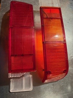

Looking for advice on what to use to glue broken and cracked rear acrylic taillight lenses from my 1974 914. They are original Hellas and I would like to keep them.

how closely do the edges of the break(s) line up? are there any missing pieces?

I’ve used superglue. Worked great. A little goes a long way.

Super glue is available is several viscosities, I have used it for years in my woodturning. The medium thickness would be best for this job, the thin is hard to keep in place while drying and doesn't fill gaps. . (IMG:style_emoticons/default/agree.gif)

i have had problems with thin super glue for things like this. i have no experience with the thicker variety
i have repaired my tail lights using clear epoxy, assuming that the pieces line up
