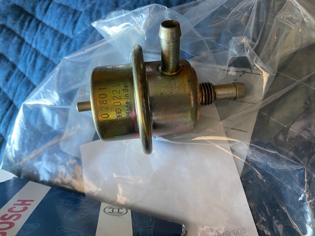

Hmm, looking at that picture.. two things: the Fuel Pressure regulator appears to be specific to L-jet (3-ports) and I'm wondering if it can be run at all with out the charcoal canister? Well my '73 is set up for the one on top of the tank, but.. could that one be used or would it be better to get the one for the engine bay (IMG:style_emoticons/default/idea.gif)

Yes, the fuel pressure regulator is specific to L-Jet. Here's a picture of a NOS one off my shelf in case that is of any help. Can't reference my car right now as it is at my second garage. Aftermarket and used are available, but Bosch is NLA. BusDepot carries a Brazilian made one that is probably decent quality. Stay away from the Chinese made knock-offs if you can. If you get to that point I'm sure I can dig up a decent used one for you from my stockpile.
Does the L-Jet set up come with the dual relay? They are available once again, but the supply comes and goes. You can reference my threads on the dual relay for more information and suppliers. It's not a cheap part to get and they are a weak spot in the system.
Not sure how to answer the question about the charcoal canister. I think wonkipop can. I don't see why you can't reuse your charcoal canister, but it's not something I've done any research on.
