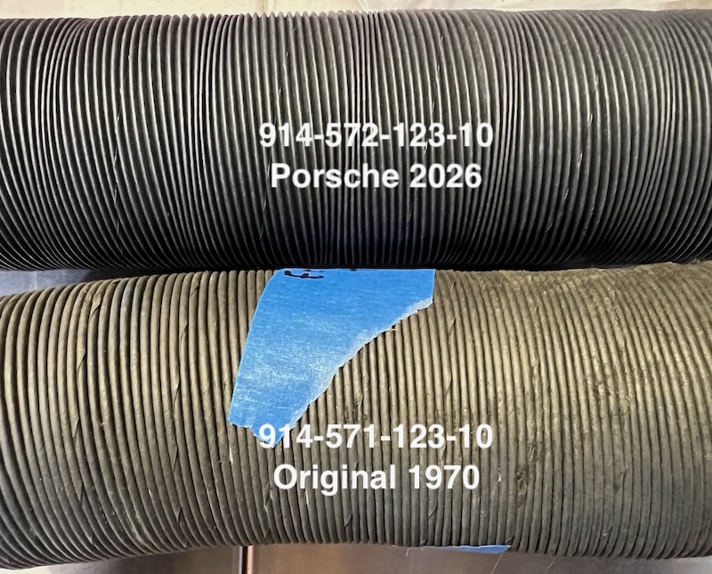

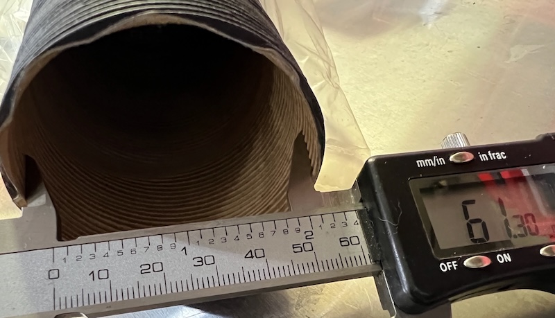

Brief update. I bought 914-572-123-10 (meant to be control box to passenger compartment, tan exterior in 1970). In 2026 it is black paper outside and tan inside. No foil. Otherwise very similar to original 914-571-123-10. 61.30 mm ID. Cut in half, it is a very good replacement for the two fresh air box to control box hoses.
