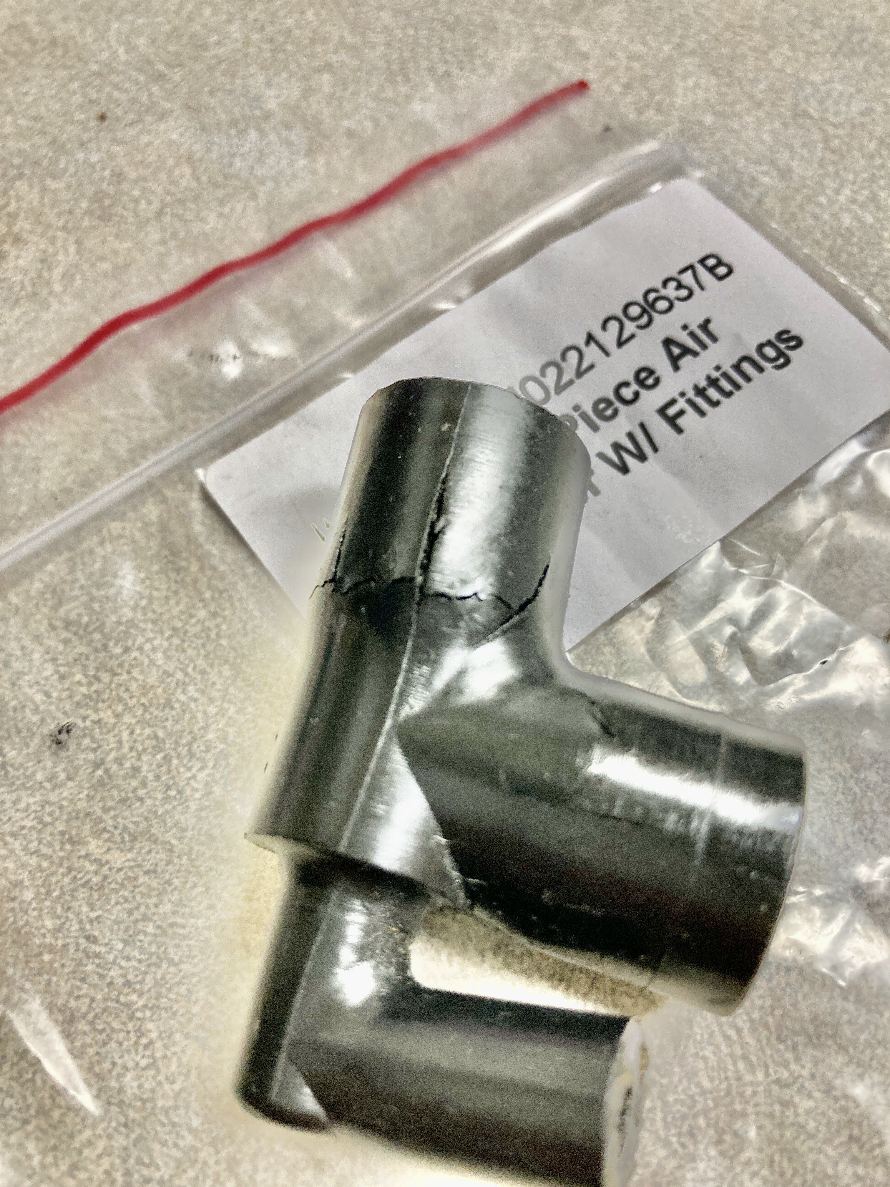

Ok, I pulled the hoses on the plenum, there is a rubber connector that has a split and one of the other hoses looked to be split. I ordered replacements but I think I’m still going to pull the plenum, and look for cracks.

QUOTE(mgphoto @ Mar 16 2026, 12:14 PM) *
Sounds like you found your leak!

Well I’m back to the starting point, I found the vacuum leak.
Test run was nice but I had some drivability issues, a backfire and a stall or two, I think leaning out the midrange might have helped.
