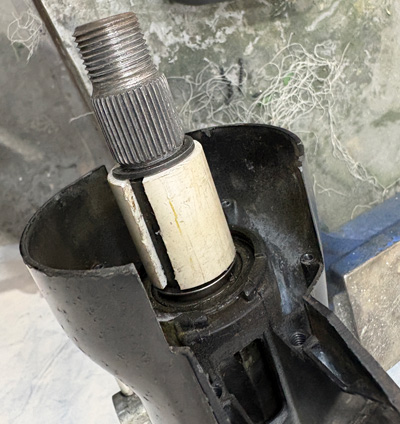

I am rebuilding the steering column and found this PVC pipe inserted inside.
After doing some research, it seems there should be a guide bushing. However, this bushing appears to be used only on 1972–1974 models, and my car is a 1975. I’m a bit confused about this. Also, there are two bearings in the column—how can I tell if they need to be replaced? Thank you. ![]() |

Montreal914 Here is a "how-to"
http://www.performan... Feb 6 2026, 04:53 PM
jim_hoyland Hmmmm…my ‘75 has that PVC piece too ?? Feb 6 2026, 05:00 PM![]() ![]() |
