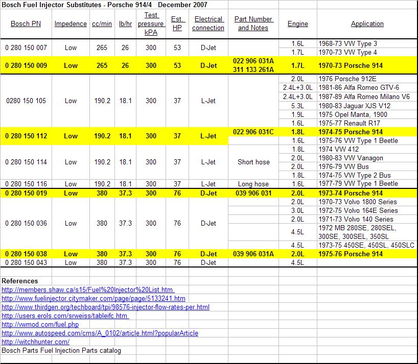

I have a leaky fuel injector on my 74 2.0 I have a number of VW 030-906-031 is there an upgrade to this part number as I am not finding this anywhere TIA Dennis (IMG:style_emoticons/default/wacko.gif)
post Feb 6 2026, 04:13 PM
Posts: 9,177
Here are factory substitutes. Google FJ67 for aftermarket 2.0L substitutes.

Jeff already answered with the number for the replacement fuel injector that people are using (Standard Ignition FJ67). OEM are NLA. You can also put a WTB ad on this site. I'm sure there are other people besides me who are sitting on some OEM or used fuel injectors in their stash. You can also try sending out your fuel injectors for refurbishing. Mr. Injector gets a lot of recommendations. If you do that either send him new pre-formed curved fuel lines to install or just ask him not to put the straight fuel lines on. Good luck!

I've used mr injector for hundreds of injectors. He's very good. However, he can not fix leaky injectors. Once they leak, they are toast. Caveat, make sure it's not a leak at the seal. Seals can be replaced. If it's at the injector body, toss them.
