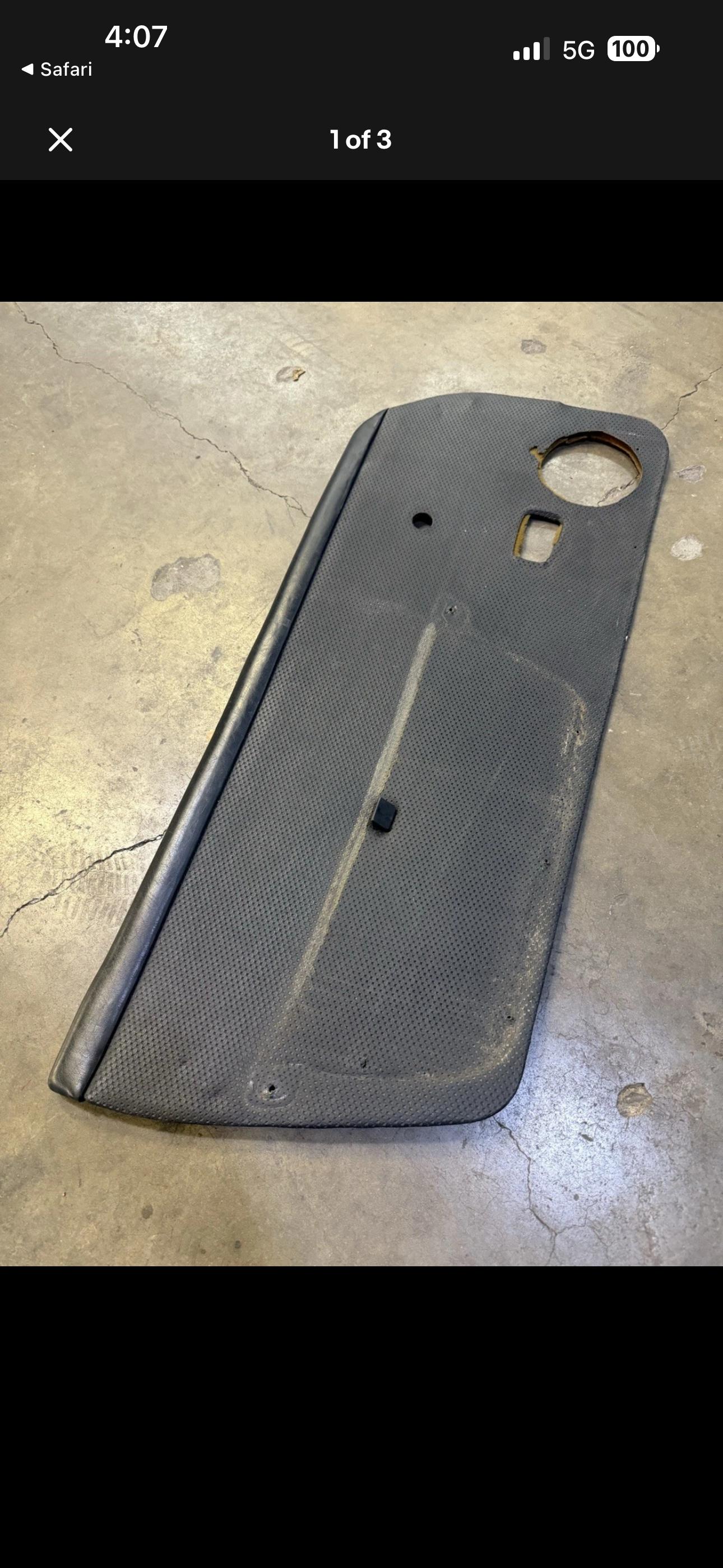

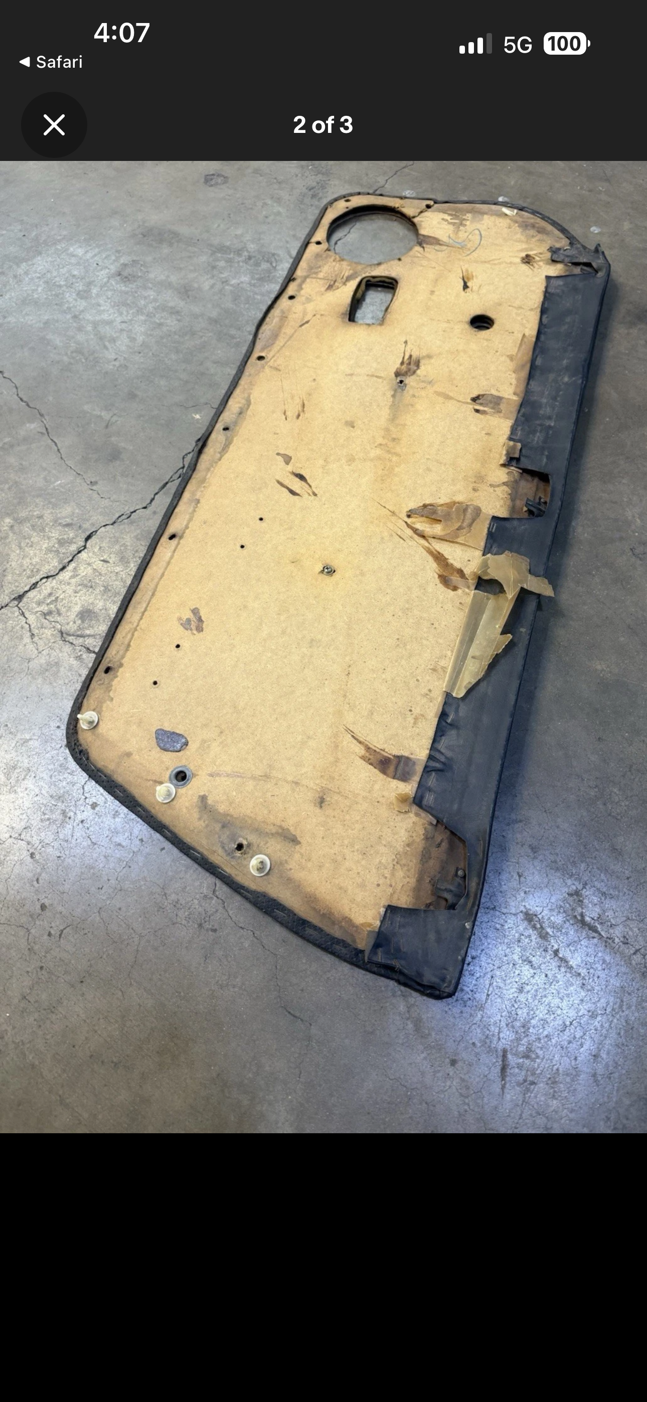

There should be a hole in the door panel itself that one end of the spring connects to. If I remember correctly the hole has a small metal bezel around it.
Rob-O
post Feb 2 2026, 04:12 AM
Posts: 1,303
Joined: 5-December 03
From: Mansfield, TX
Member No.: 1,419
Some pics I lifted off eBay. You can just barely see the hole in the vinyl side. On the back of the panel the small metal bezel is visible right by one of the clips that attaches the panel to the door. Note that if your door panel is a replacement it may not have the hole for the spring. For example I don’t believe the early ‘914 Rubber’ panels made of fiberglass had the hole.

post Feb 2 2026, 04:13 AM
Posts: 1,303
From: Mansfield, TX
Member No.: 1,419
Second pic

Thanks for the reply and pictures. There is a small rip/hole in the vinyl there but no bezel. I will take the panel off and see what's on the back. Maybe I can rig something to work. Appreciate your feedback!

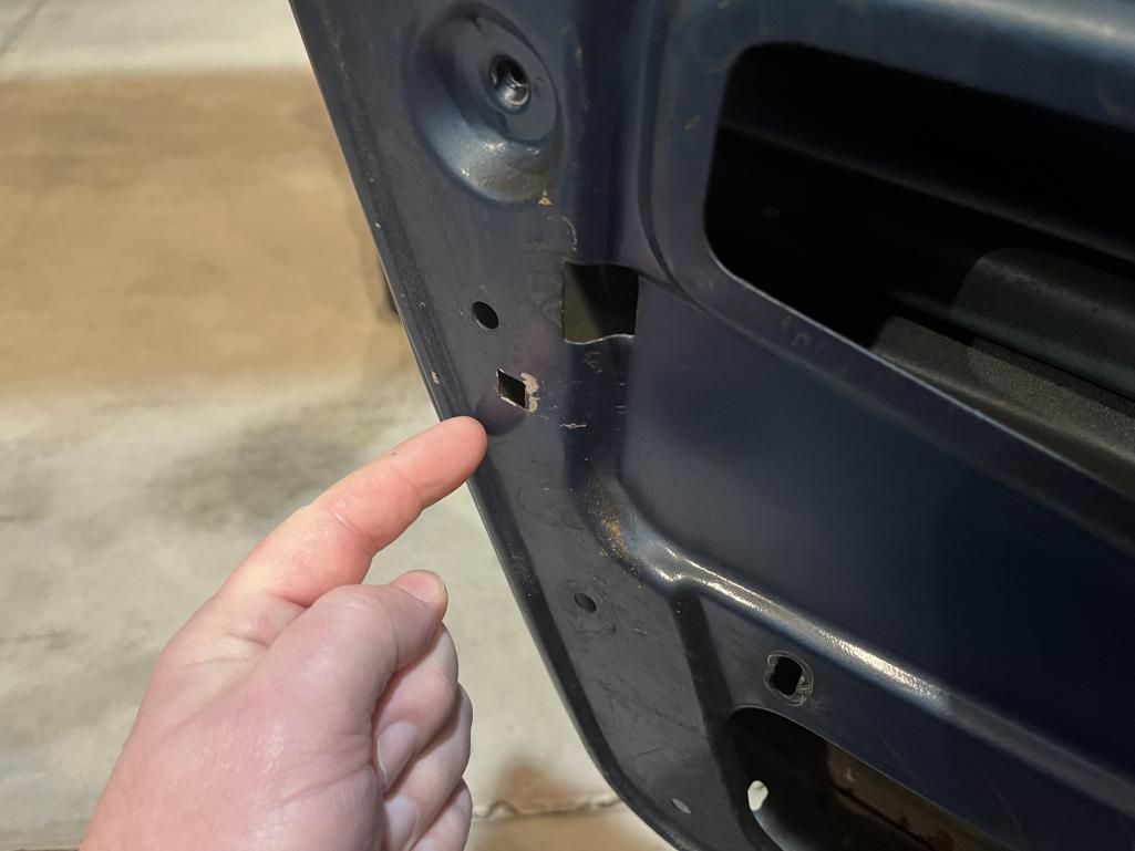

post Feb 2 2026, 09:39 AM
Posts: 9,169
Look deeper gents. The end of the spring engages a hole in the sheet metal door frame behind the grommet.
