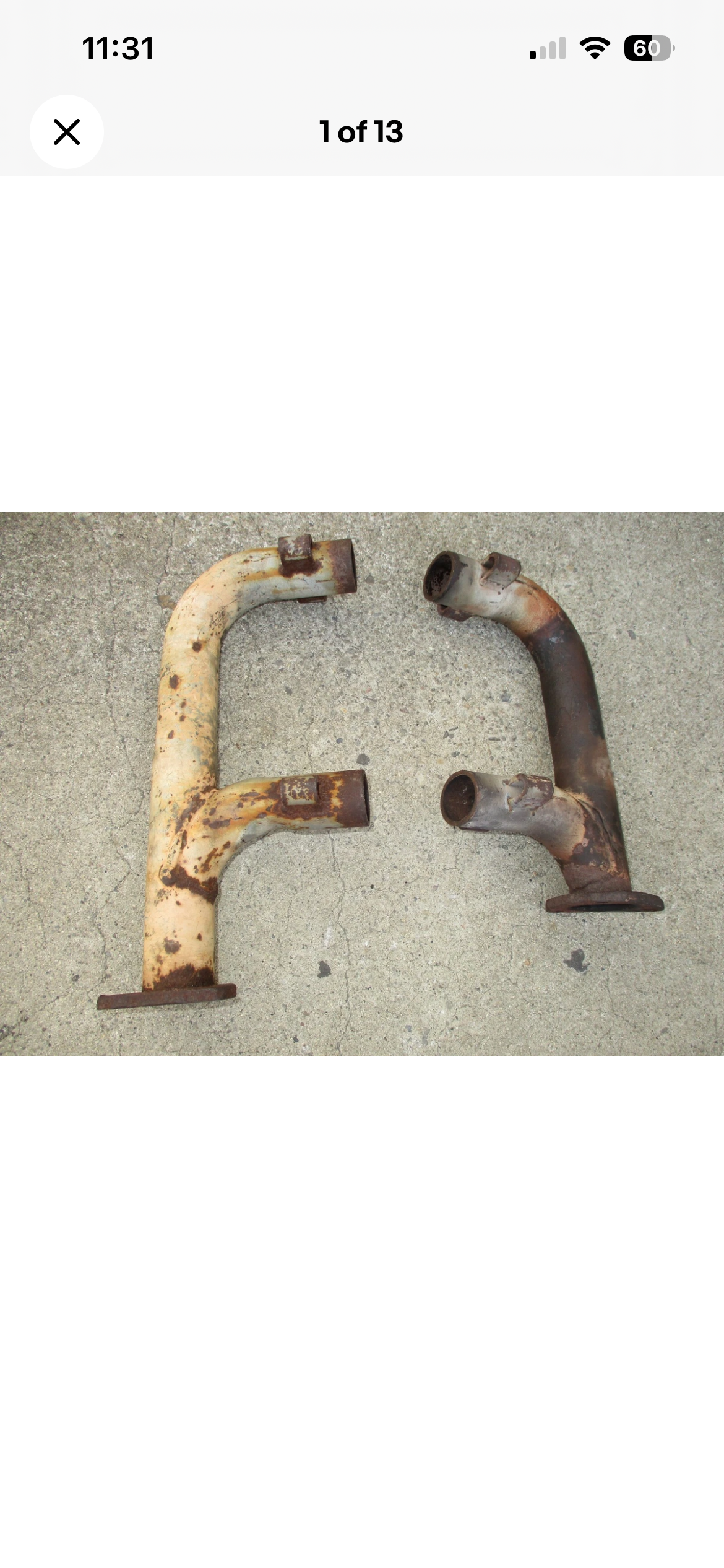

post Feb 1 2026, 06:38 PM
Posts: 9,401
None were ever made. The ones shown are missing heat shield tin. However Ben McFarland might be able to make some for you.

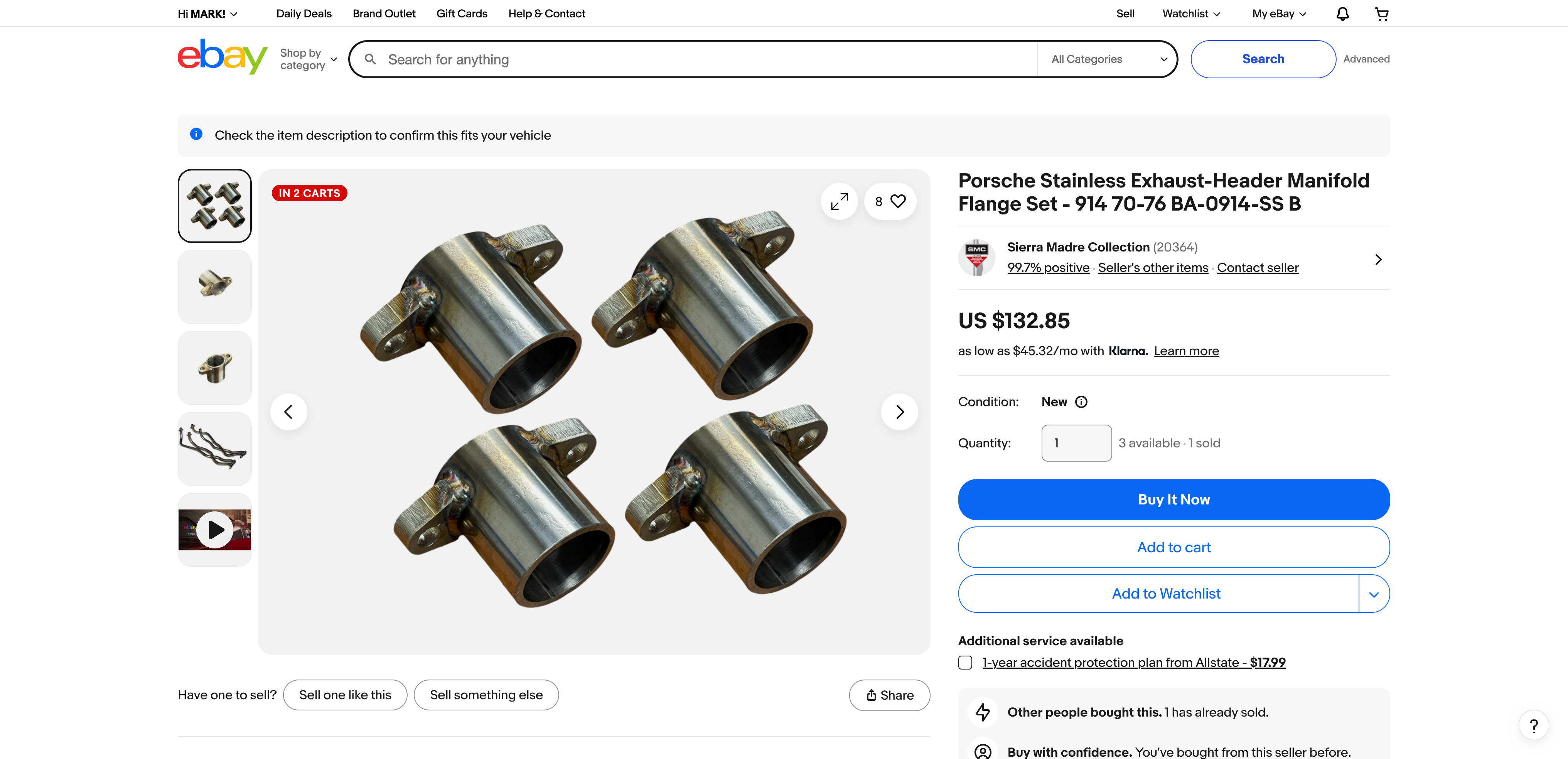

These flanges maybe a place to start

I still have some stock pieces form my 75 if you are in need...

I have a fairly good set of 75 thermal reactors (the pipe assembly in your pic) off of my 31K 75. My heat exchangers and all of the assorted crap you need to make the heater work (except right side fresh air induction tube-AC car) are in usable/nice shape and I could be talked out of them. Past the heat exchangers is trashed (could be pieced back together).
So, I have what you need.
The stuffs not valuable anywhere but some sections of California.
Shipping would be BS.
Now, as a performance enthusiast and a forum "friend" I would tell you to AVOID this system unless you are planning to feed a turbo charger off of them.
It's the ONLY reason I haven't trashed/gotten rid of them.
Turbos and T4s don't mix well so I will not be walking that path.
I was going to offer them up on the forum to help someone out in the emission badlands.
The problem is "primary length" for each individual cylinder. Naturally aspirated engines prefer equal primary lengths at usually fairly long 18"-36" lengths.
These are HORRIBLE in this regard for NA use. They WILL decrease performance, especially if you have a bigger, higher-strung motor.
