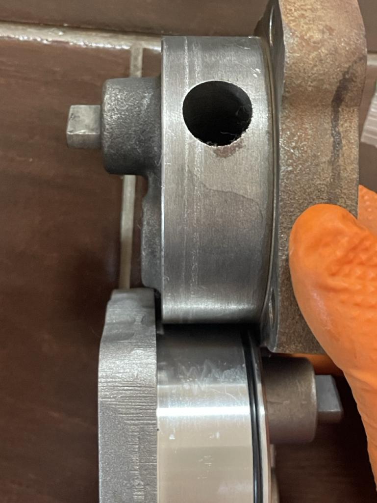

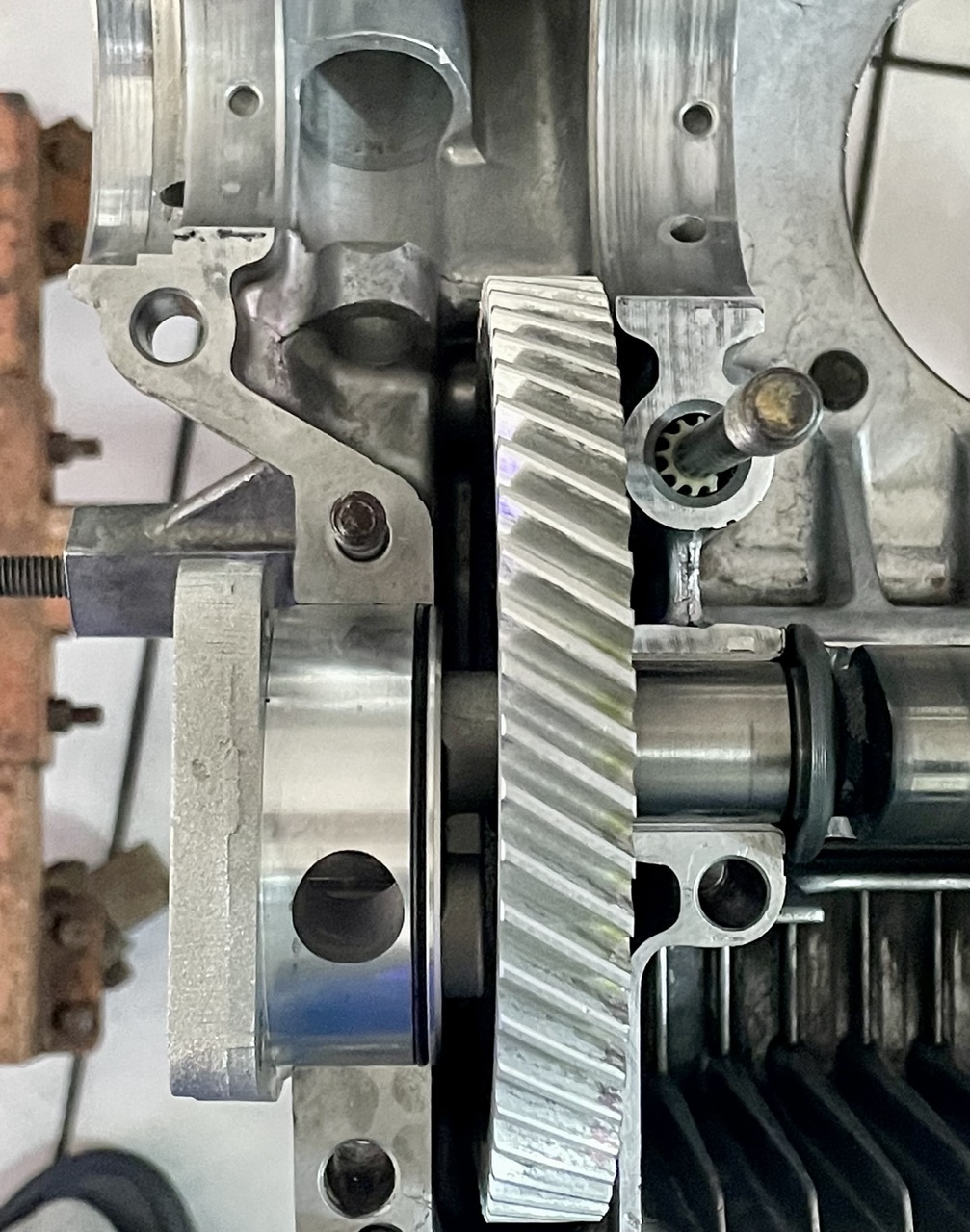

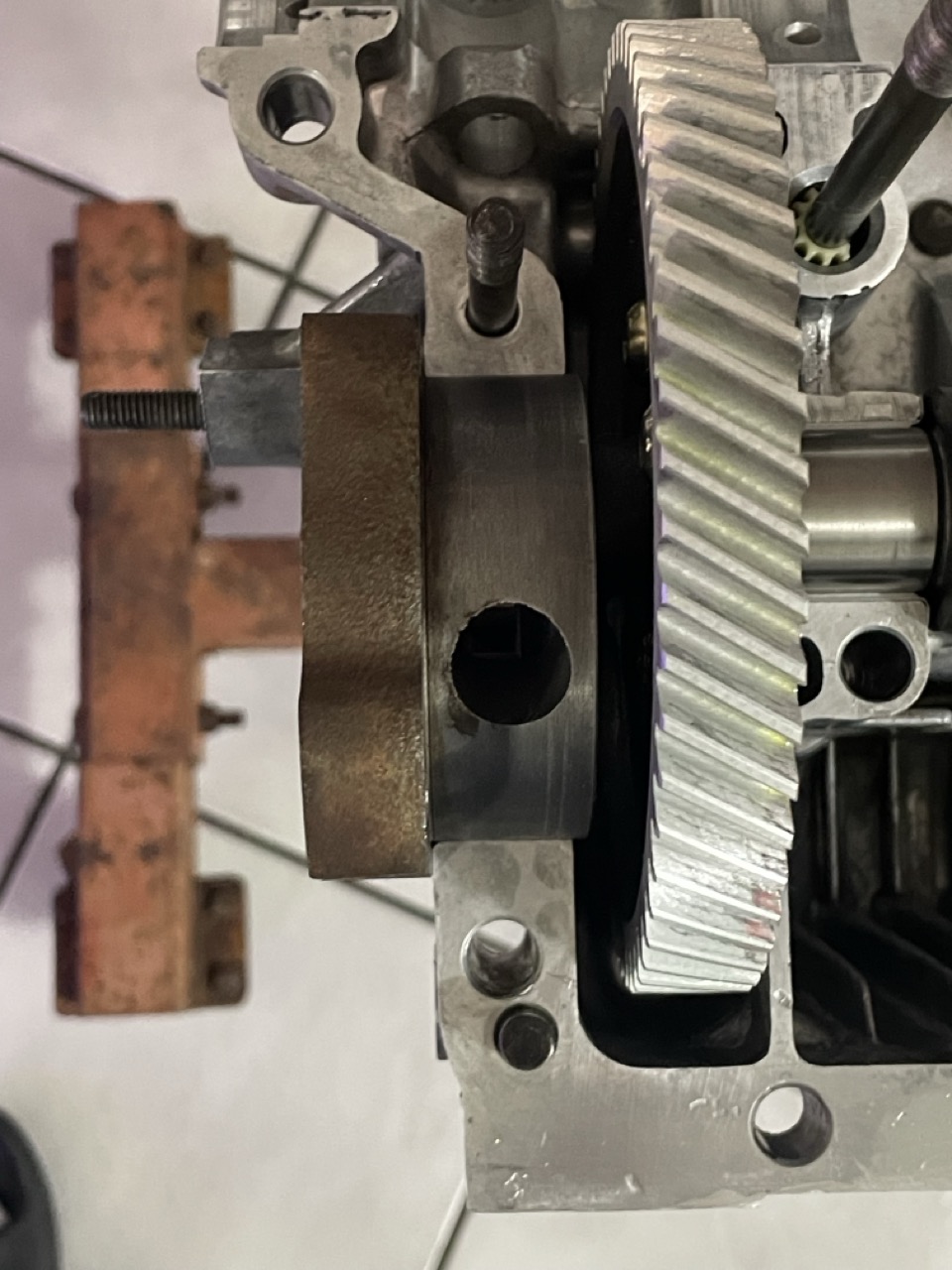

So my plan was to start assembling the 2056 today, but I found this when placing the oil pump into the case. I measured the gap needed to fill with a gasket, and it’s right at 3mm. Do they make a thick pump to case gasket that will fill this space, so that the rubber sealing ring will be in the case instead of hanging out the back of it??
The gaskets that came with the pump are way to thin to place the pump in the correct position.

I don't think you should need a 3mm thick gasket, the paper style is normal.
Either the pump is machined incorrectly or the mounting surface was milled way too much. Hoping it just a bad pump...

Check the clearance to the cam gear with the cam installed.

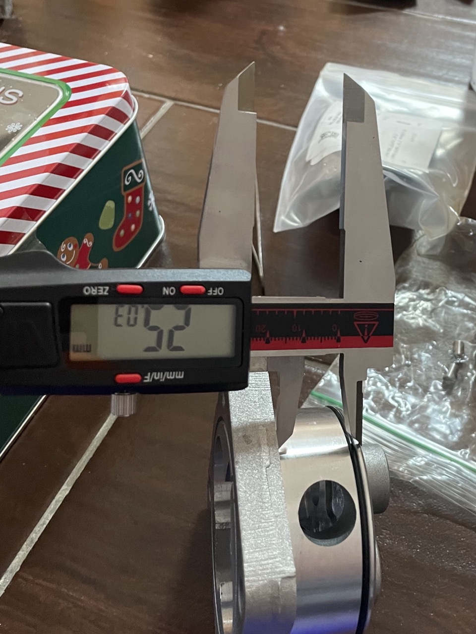

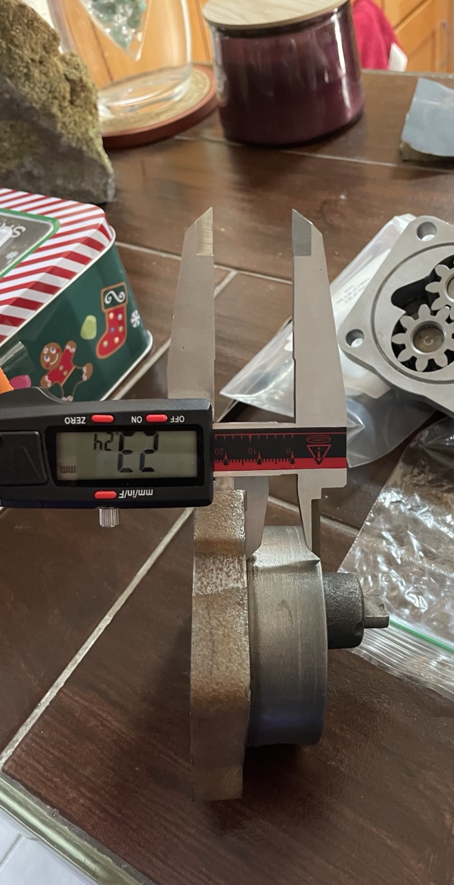

So the pump body is definitely too long. It’s just shy of 2mm longer than the previous pump that came out of the running motor. I have sent pictures and explanation to the company I bought it from. The boss on the back of the pump where the gear engages the cam gear is also a hair longer as well. It bottoms out against the cam as you can see in the first pic.
