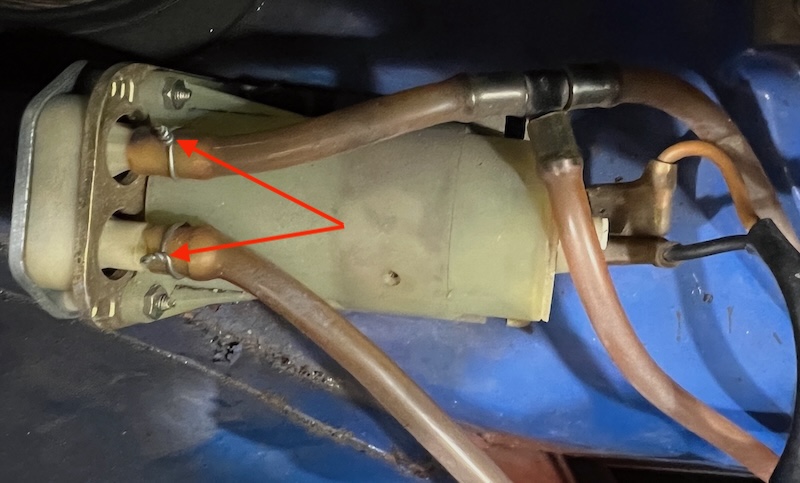

A related tip on this topic. The hoses are secured to the pump with very thin wire (0.80 mm diameter) twisted around them. It broke when I removed it.
The closest I could find is 24 gauge floral wire at Menards. It is 0.60 mm diameter and green, but worked quite well and is out of view.

QUOTE(DennisV @ Apr 6 2026, 04:00 PM) *
That looks like safety wire. Readily available at any speed shop, as well as Summit Racing, Jegs, Amazon, etc. The twisting is done with a special pair of pliers that has a pull-twister, specifically for safety wire.

QUOTE(914Sixer @ Apr 6 2026, 05:49 PM) *
Wire is NOT stock.
(IMG:style_emoticons/default/ohmy.gif)
Thank you for pointing this out.
