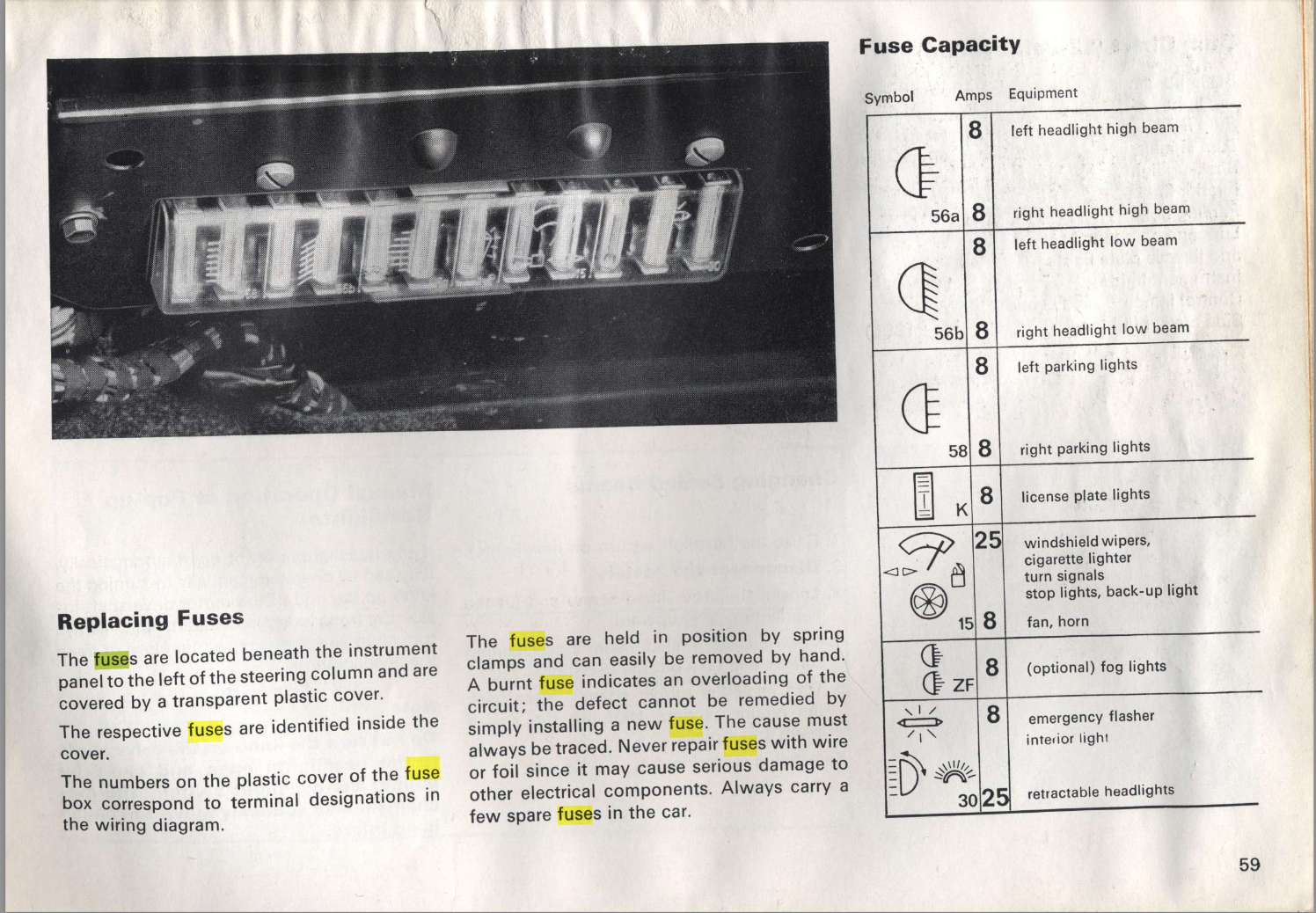

I’m having a hard time finding a diagram showing exactly what amp fuse should be on each circuit. I have 8 amp on all but #8 and #12. Is that right?

It's in the owner's manual. This is from a '73
post Jan 11 2026, 07:40 AM
Posts: 9,387
You need -6 diagram, not sure IF same as -4
post Jan 11 2026, 07:46 AM
Posts: 4,443
just sayin, you might want to either get a factory owners manual or a Haynes or Clymer workshop manual
