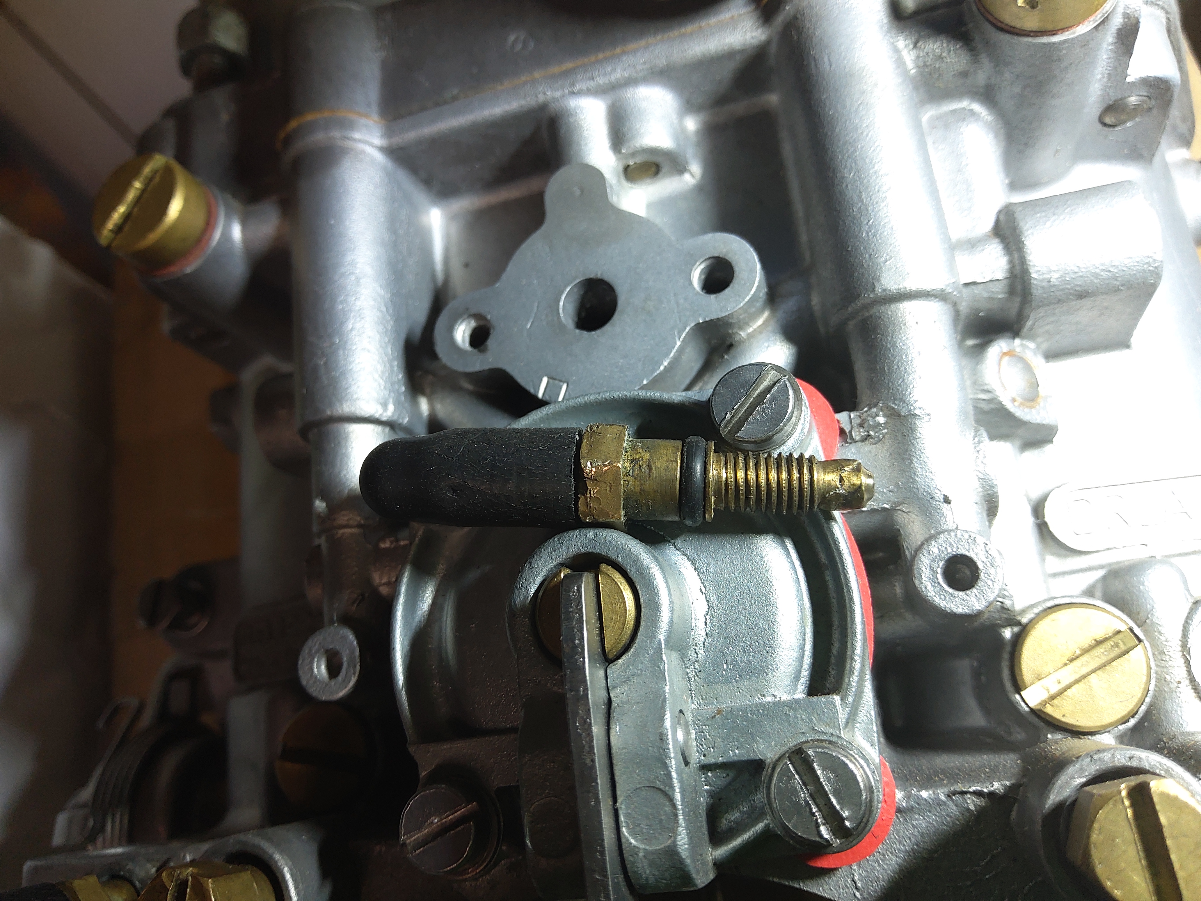

Looking at part these may work like brake bleeder - see if you can screw it in and it may cut off the passage (replace the o-ring with rebuild kit new part). Attached Image
You can test this by screwing them in all the way and then blow air or carb cleaner through the port - nothing should come out inside the carb body.

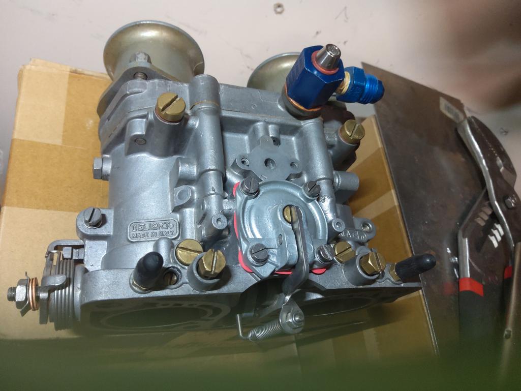

These are 45mm Dellortos, but they work the same as yours.
Plug them. You'll see they go right into the carb below the throttle plate.

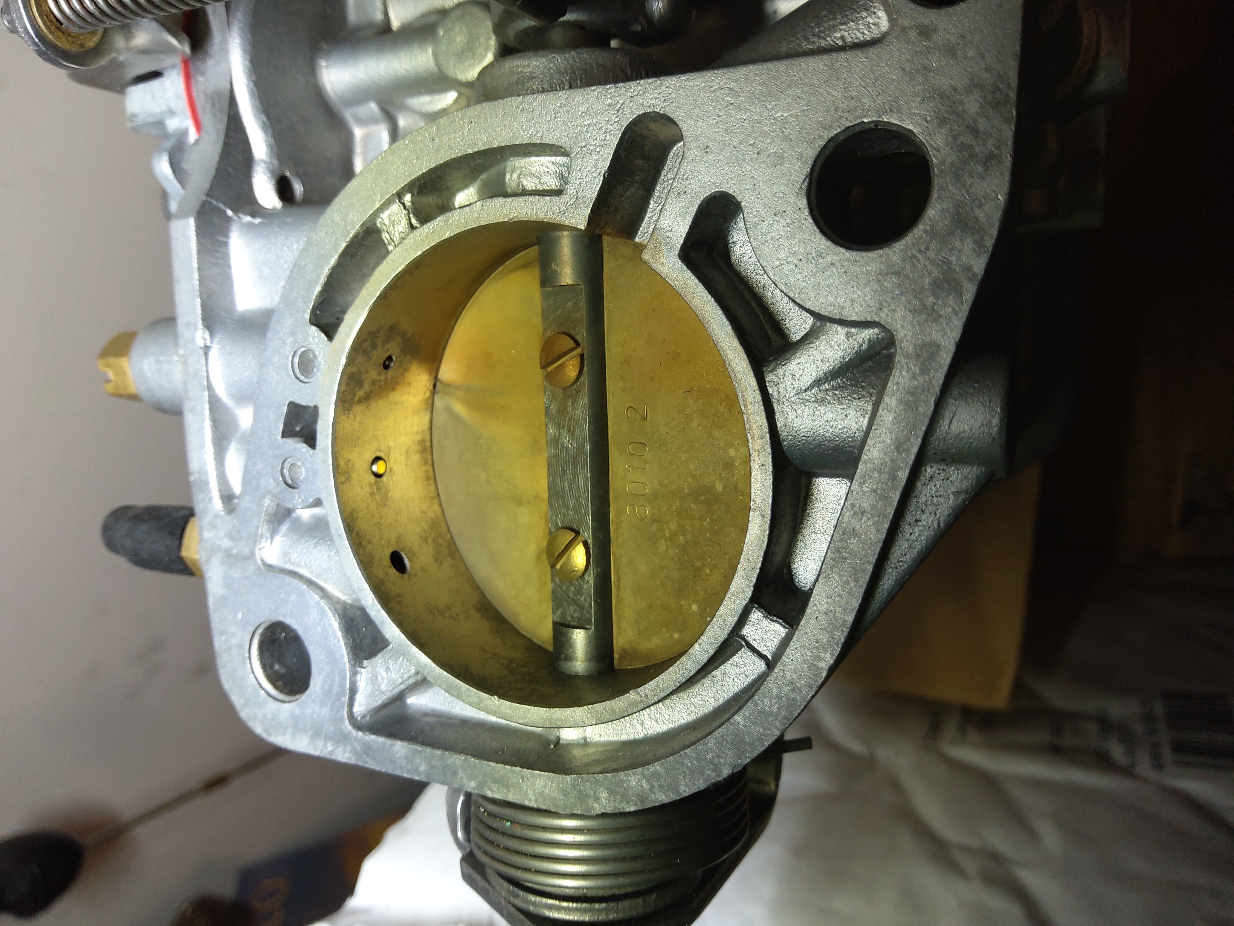

Both fittings in this photo (from the same carb) are crushed on the end.
But they do allow air to bypass the throttle plate. So, plug them with rubber vacuum caps or otherwise.
