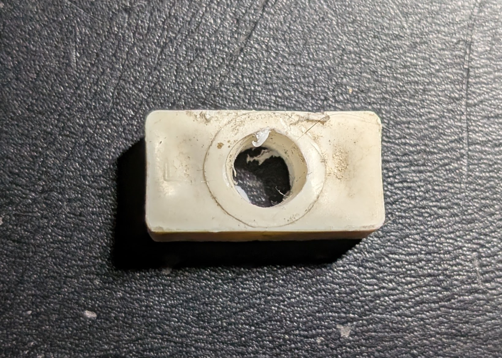

The other day I noticed my headlights were out of adjustment. The up/down headlight adjuster plastic block had stripped out from 55 years of vibration. I used a couple of M5 nuts behind the plastic block to get the adjustment to hold, but that requires removing the shroud and eyelid to get at them for any future adjustments. I wanted a better fix.
Stripped plastic block. I drilled it to let it slide on the adjusting screw when I used the M5 nuts.

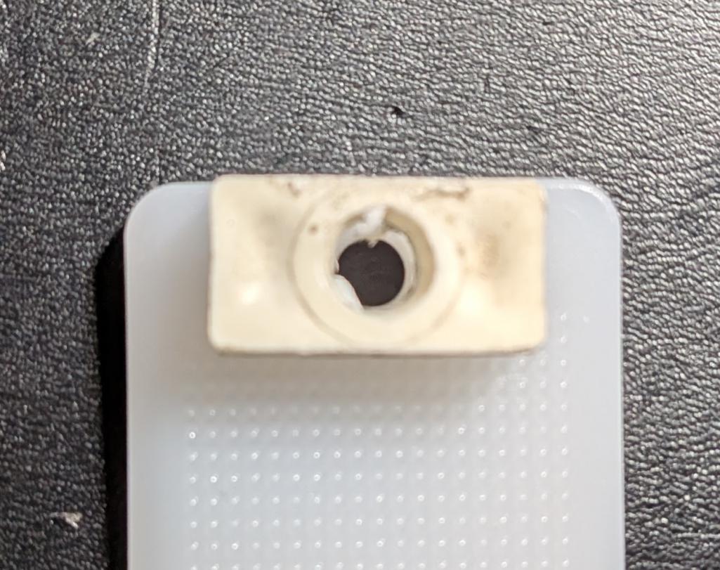

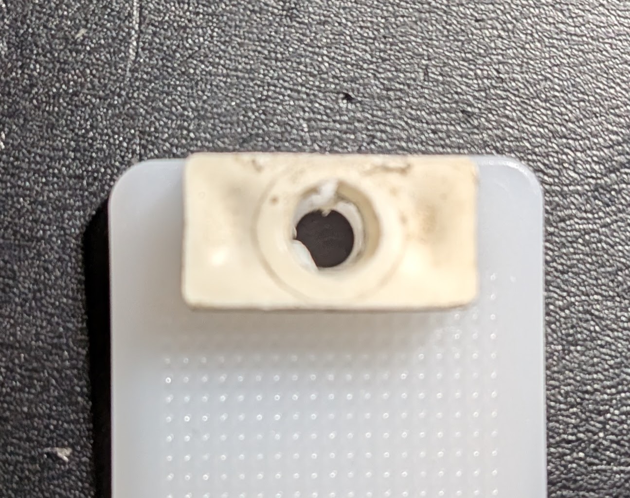

The hole is exactly the correct size for the adjustment screw to thread into snugly, without tapping it. Thickness is perfect, too.
It just takes one cut with a coping saw to make a new adjuster, you don't need to trim the sides. It was a 10 minute fix, if yours is stripped, give it a try.
