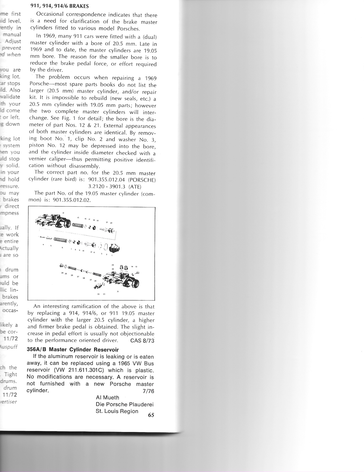

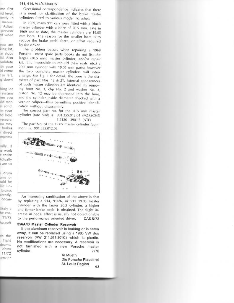

Found this and passing info on. I have one of the 20mm on the 1975. Never could prove it was a factory part. Article clears up myth that the larger master cylinder came from Mercedes.

no myth, just NLA

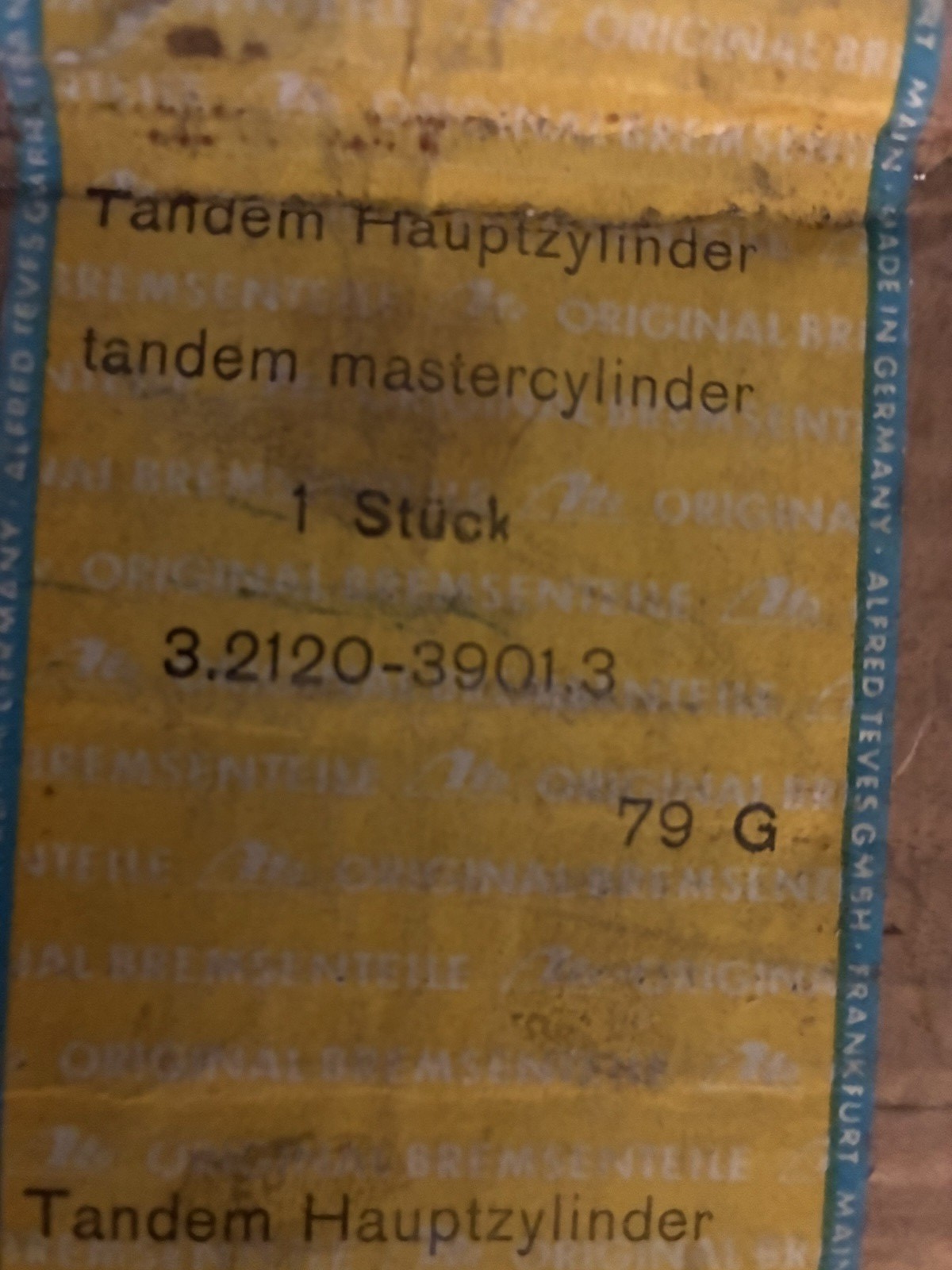

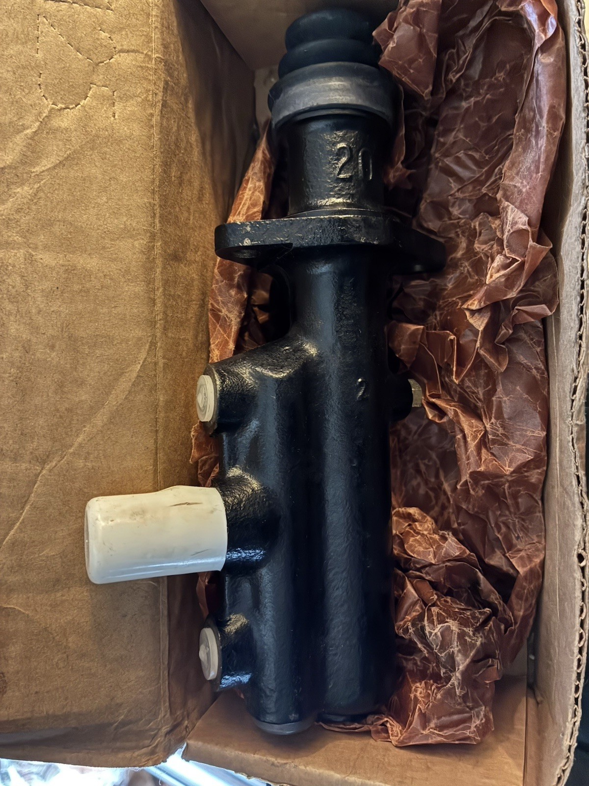

Not totally true, I have a 2nd one that is NOS.

What calipers are you running Mark?
That looks like a good MC size for Boxster calipers.
I wish they were more readily available.
Have you researched what the NOS one you have is worth to the 911 crowd?
